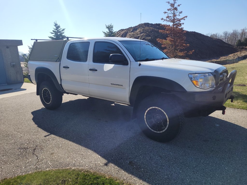

    Come August my wife, dogs, and myself will be moving to Belize from Michigan. We plan to drive my 2009 Gen 2 Tacoma the 3000 miles to our new home in Belize which is currently under construction. For the last year I've been working steadily on my truck getting it ready for the journey. This truck has been my Michigan winter vehicle for the last 10 year. and currently has 135K miles on the odometer. It has seen it’s share of road salt. During the summer it sat on my lift in my barn
    Here is what I’ve done thus far.
    Replaced front, rear, and transfer case fluid.
    Replaced back half of exhaust system due to rust hole in muffler.
    Replaced rear front and rear brakes.
    Replaced serpentine belt.

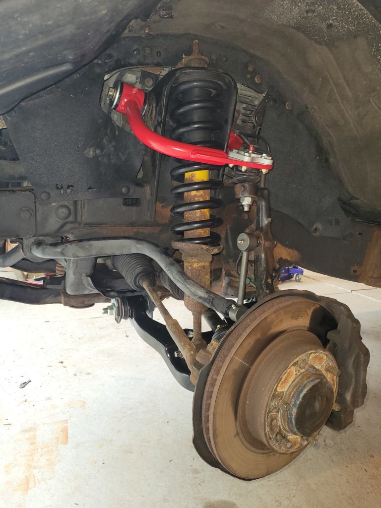

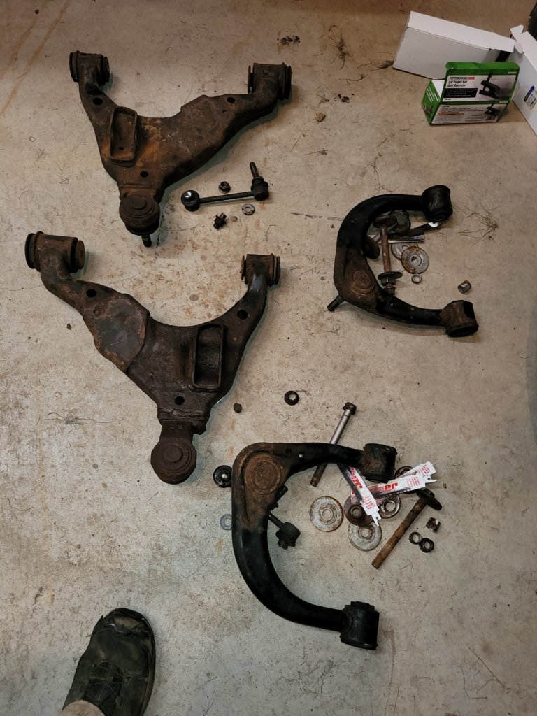

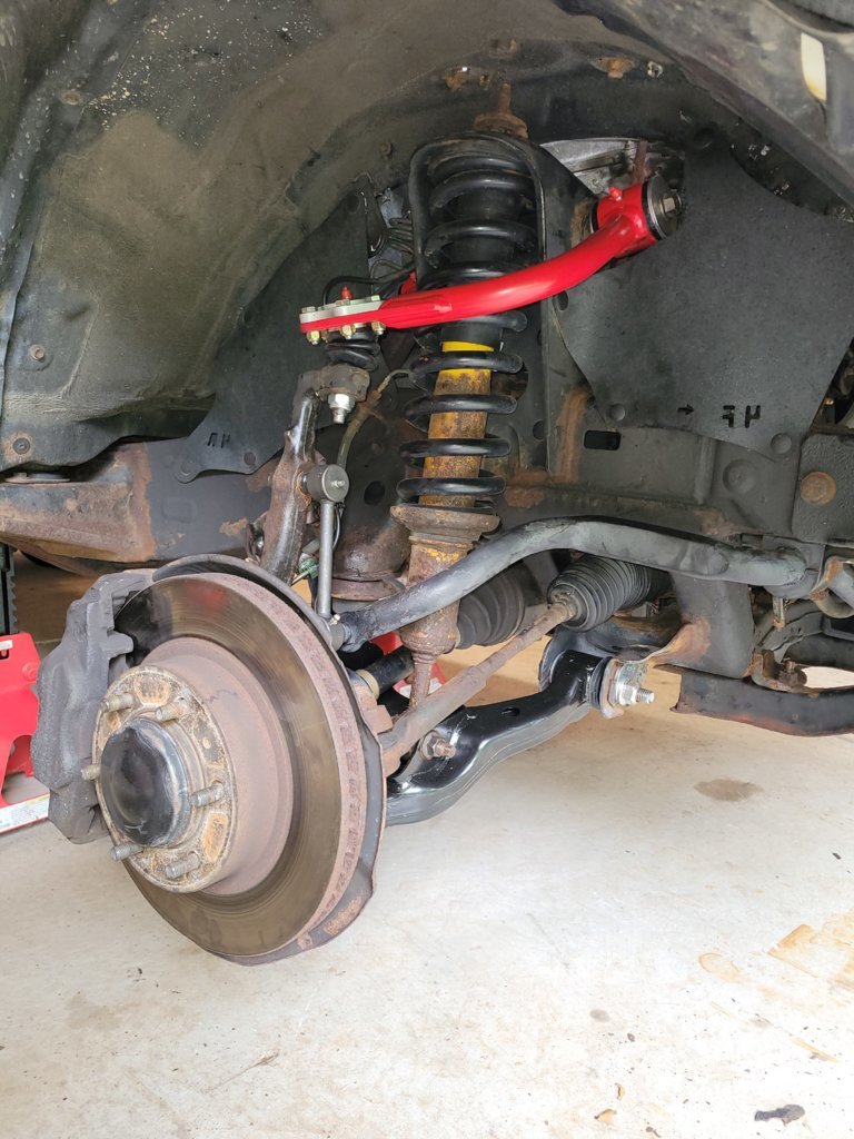

    Replaced upper and lower control arms. This was a good size undertaking. When I lift the truck 2.5” back in 2013, I skipped changing out the upper control arms. The alignment was off a little and pulled to the right, but it wasn’t a major issue. However, for the drive to Belize I didn’t want to be fighting the truck for 3K miles. Do my dismay, the years of Michigan salt had seized the lower caster bolts to the lower control arms and the frame. I had to cut and torch those out and installed new factory Toyota arms. The upper arms weren’t as bad. I did have to bend the sheet metal a little to get the upper control arm bolts out, but I planned ahead and had a spare set on hand if I that to cut those out as well. I went with a set of JBA Offroad upper control arms. Very happy with those thus far. I also replaced the sway bar links while I had everything apart.
    Since I’m moving to a tropical climate, I figured it was time to address the AC system, which hasn’t worked in years due to an AC leak. I ended up replacing almost the entire AC system, including condenser, evaporator, and compressor. I guarantee there is a hole in the ozone above my house from all the R134a that leaked out trying to find the stupid leak. Not to mention all the AC dye. In the end, the leak was coming from the behind the compressor clutch. Why I could never find the UV dye is beyond me.

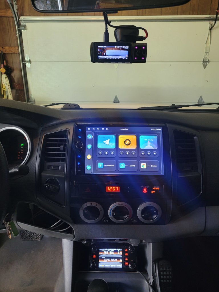

    Now on to more fun stuff. I add a Joying head unit so we can have Android Auto for Google maps and entertainment for the trip down. I also added a Vantrue N4 Pro 3 channel dash cams to document any accidents or run in’s with the Federales on the way down. Lastly I wired in my HAM radio for additional mobile communication. I enjoy automotive wiring, so adding all these features was fun for me.

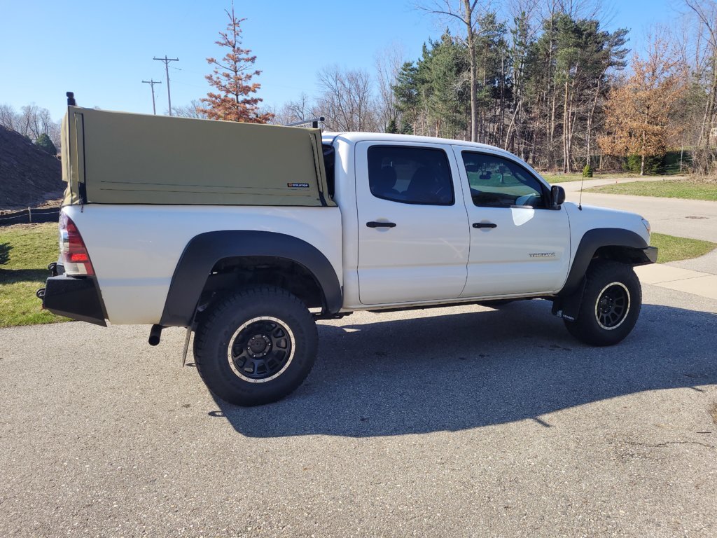

    To protect our belongings, I installed a Wildtop soft top for the back. Very happy with this product. I did however replace the Wildtop roof rack load bars with set of old school Thule load bars.
    In the bed I added a mount for my Hi-lift jack and made a custom bracket to hold my Wavian Jerry can.
    Since I will be living on a dirt road that floods during the rainy season, I added a set of Rek Gen mud flaps. I’m still on the fence with these. Good quality product, but hardware and fitment could be better in my opinion.
    And finally tires. I had been running a set of 265/75 R16 Goodyear Duratrac’s on this truck since I lifted it in 2013. I’ve hated these tires from day one. Terrible ride, super nosey, and forget wet weather performance. I’m and old man driver and these tires slipped the second the pavement got wet. The only time these tires excelled was in deep snow. I live in a rural area where we get lake-affect snow off Lake Michigan and sometimes get 10” – 12” overnight. Never had a problem getting to work at 5am before the plows had a chance to get down our road. But once the snow was gone and the ice remained, forget it, back to spinning. Anyways, I replaced the Duratrac's with set of Toyo Open Country AT 3's. Hoping these fair much better.
    So here is the final product of all my hard work over the last year. Like I said, we leave in August for Belize permanently. Once in country I may look into getting a Hilux or Suzuki Jimny as a second vehicle.

    Also, the joying head looks great. Adds some modern convenience for sure. That, plus your dash cam plus the HAM radio install look really good, really well done.
