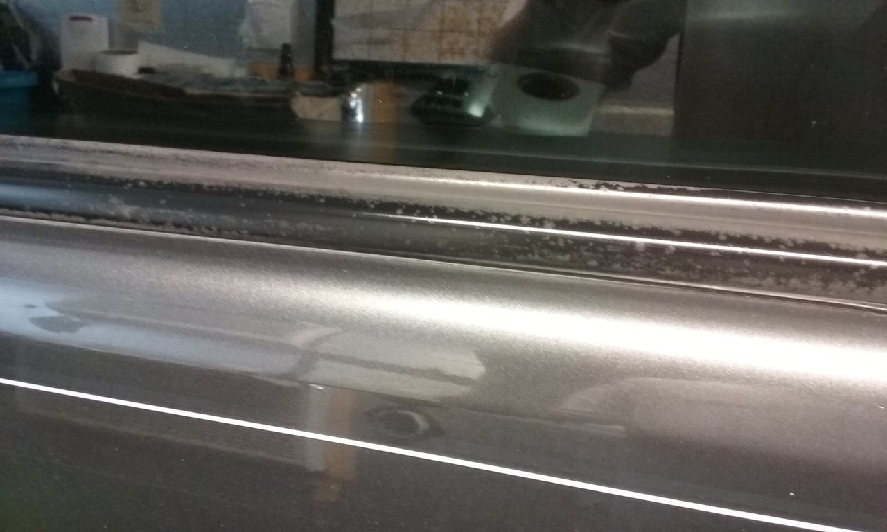

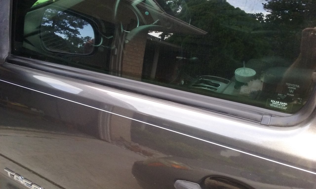

    Decided to get my door seals cleaned up thanks to this TX sun.

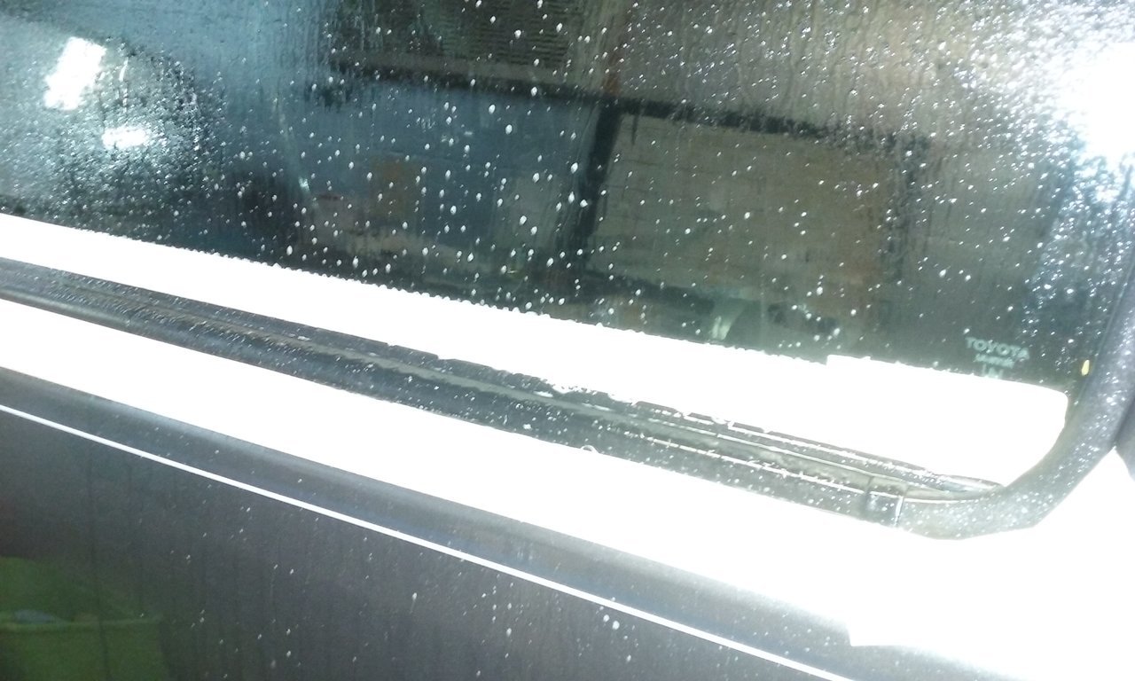

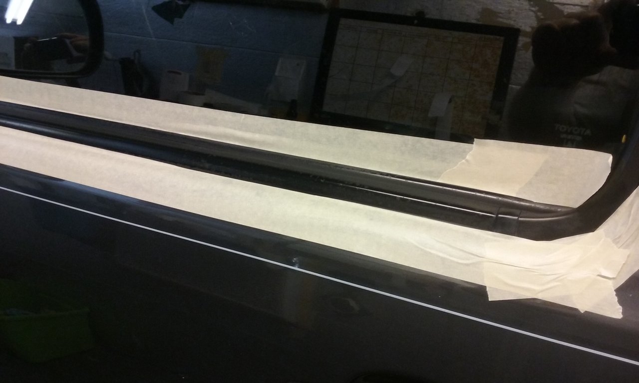

    1) Tape off the seal.
    2) spray with soap and water.
    3) scrub from side to side with #0000 fine steel wool.
    4) repeat as nessisary.
    5) clean and let dry.
    6) then go over with mothers back to black.20170705_092828.jpg 20170705_093006.jpg 20170705_093039.jpg 20170705_163316.jpg 20170707_201225-1.jpg 20170707_193246.jpg
