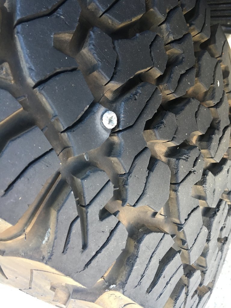

    IMG_5929.jpg Definately agree with checking for scratches before you leave... didn't check mine noticed a scratch but had a trip planned so got over it as I scratched them some more... oh and watch out for these
