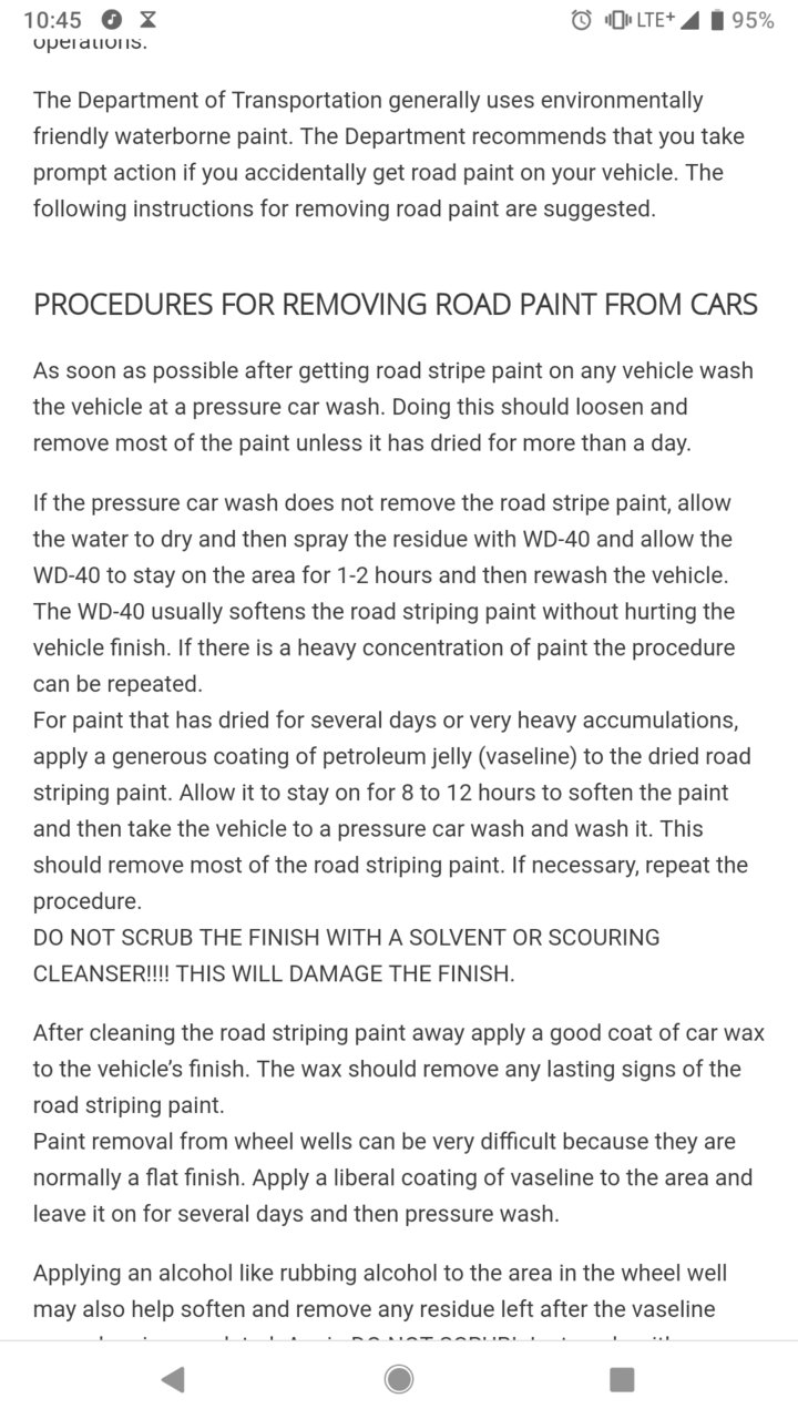

    holy crap, STOP before you seriously damage the truck paint or plastic. most of the suggestions in this thread are terrible. Don't use oven cleaner or easyOff. omg. Acetone will eat the finish on the paint. Lacquer thinner will soften the paint. :annoyed:
    I had this same problem all over my wife's SUV and white road paint. WD40 was suggested by a professional detailer and it worked great. It didn't damage anything. Some of the textured black plastic took a little bit of rubbing with a microfiber, but it came off clean. Don't push hard, just wipe it.

    I second gasoline and a rag, just dispose of it safely or soak it in a degreaser (simple green), let it dry and dispose properly. Gasoline is one powerful solvent. However I'd be worried about it potentially discoloring or aiding in fading plastic like mud flaps and you'll probably want to test in the door sills to make sure it doesn't damage paint. Your mileage may vary.
    Edit: I found this guide, I'll attach the photo
