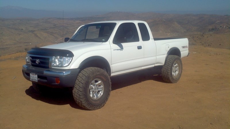

    Hi Im new to the forums, been a while since i have had a 4x4 truck let alone a yota.. And boy am i glad to be back!
    I have a 99 Tacoma ext cab 4x4, its supercharged with the 2.2 pulley making 8 lbs of boost. only fuel mod is an upgraded fuel pump. I have never had any knock or pinging issues, and my wideband reads me a healthy 12.7 at WOT. However I know how i tend to drive at Glamis so this truck is gonna be pushed pretty hard over long periods of time..
    Im thinking as a safety precaution i should fill up with 100 octane once Im out on the sand.. I know it will keep away the detonation, so as long as it doesn't cause the truck to run leaner i should be fine..
