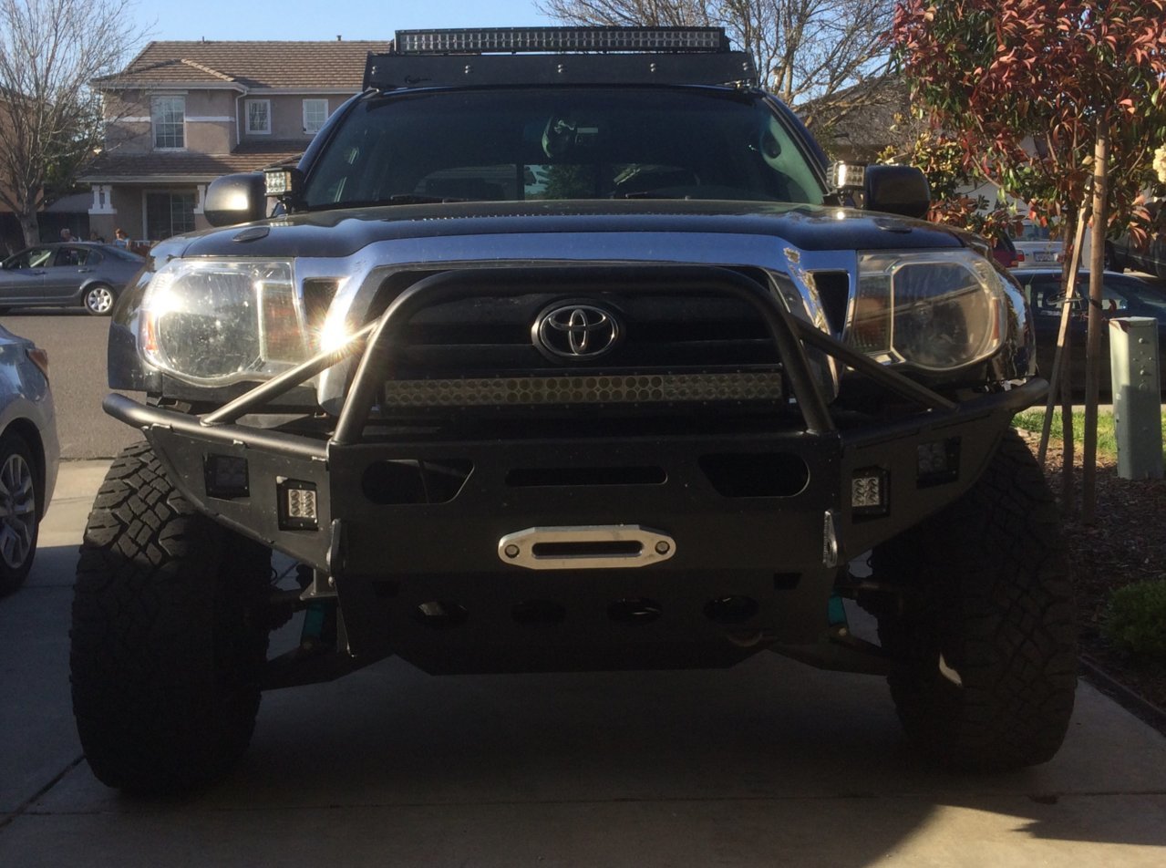

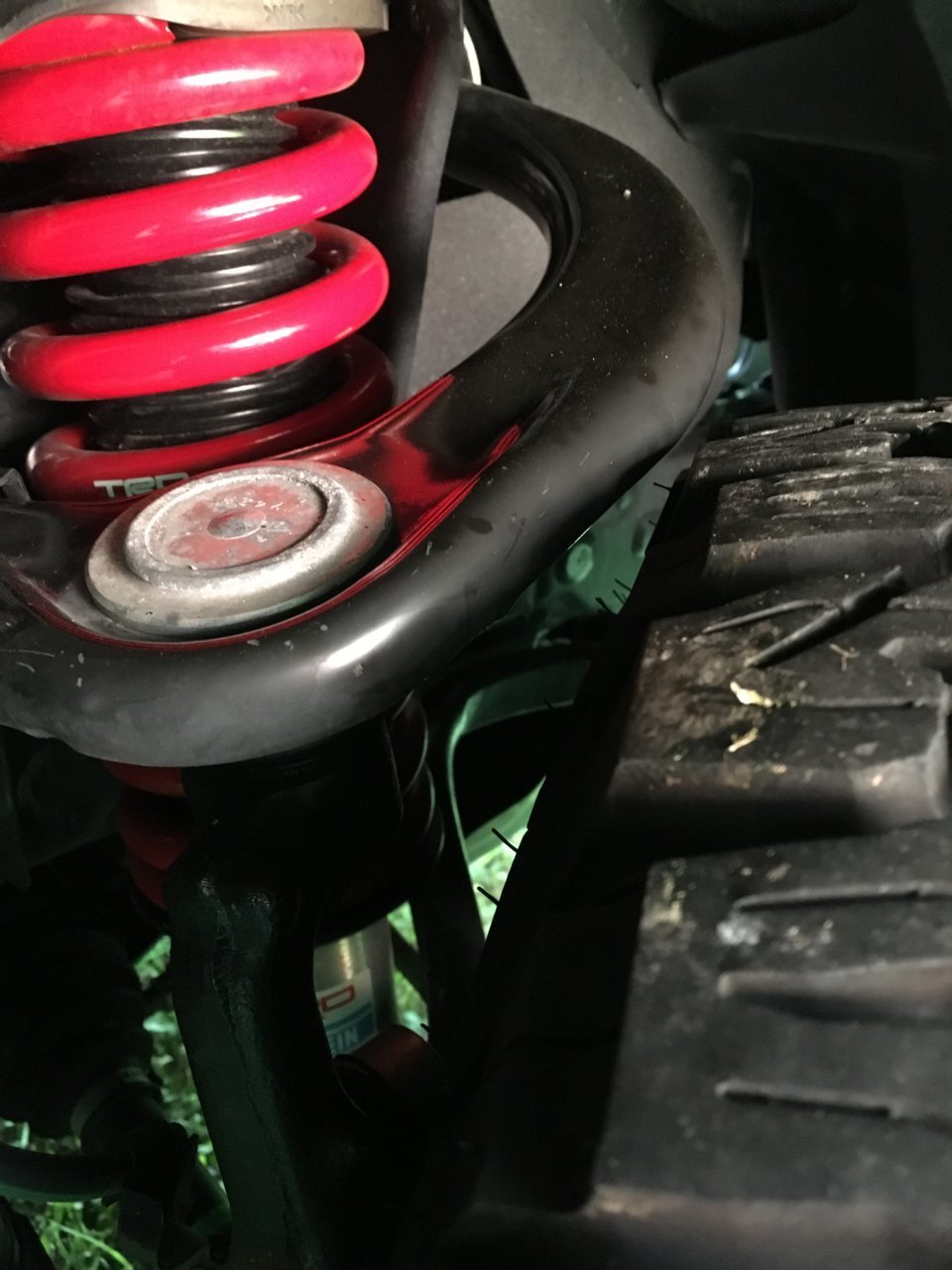

    285/75r16, Tacoma Pro wheels, OEM mud flaps, 2nd gen Pro lift (about 2”)....no rubbing at all, no cutting, no BFH was ever needed haha
    Clears UCA’s by about 1/4” given if I took it off roading often that would def be an issue but it’s my daily
