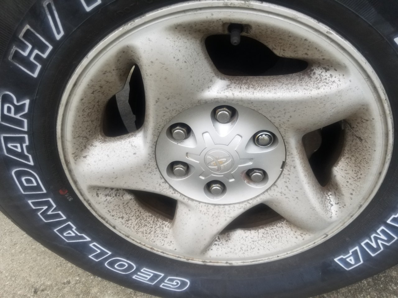

    Hey guys,
    I tried wire brushes and CRC degreaser but did not remove it all.
    Has anyone figured out what products work the best and should I use a cordless drill with various grits of sandpaper to remove them to a smooth finish?

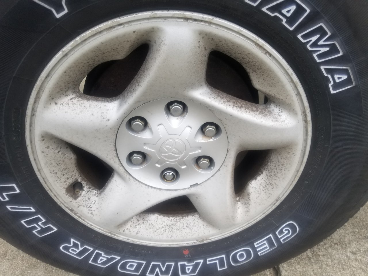

    I thought these were steel, not alloy? At any rate you have the same wheels as mine and I don't think that's brake dust, that's pitting and nicks. Mine were in the same (worse) shape until I painted them a few months ago, link with pics here. They're still holding up really well but I don't do a lot of gravel road driving.
    The exteriors of these wheels are painted, in my case someone had painted them again without proper prep which made matters worse. If I had time to do one thing differently it would be to sand off ALL the original paint down to metal, but it didn't come out too bad.

    Rocknbil,
    That is exactly what I have going on with my rims. I plan to sand with cordless drill and sand paper disks and wire brush to get them smooth again. Then primer, base coat and clear coat. Gonna need a 3day weekend to get er done. Thanks for your input

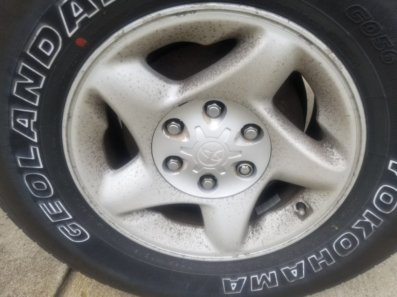

    Update:
    I spent a good hour and a half using my Dewalt cordless drill, pointed sanding wheel and wet sanding 500grit my front right rim. Was able to get just about all pitted marks out. Ser pic
    My next question is, does anyone know of a base paint to make my rims 'pop' or shine bright?? Pics would be great.
