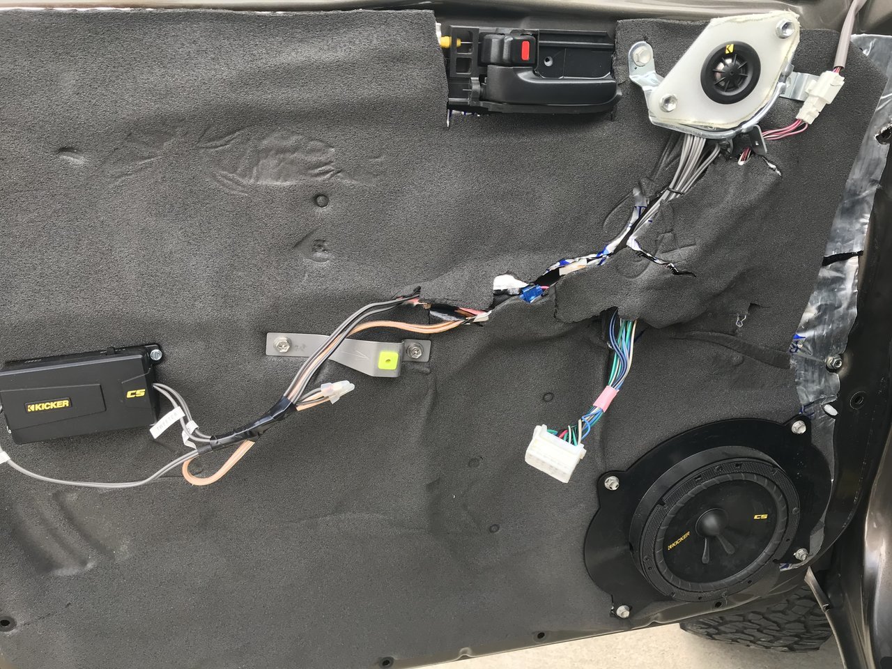

    How can I get the stock non jbl headunit in my 2014 to put out 100 Watts rms. That’s what the kickers that the previous owner put in my truck recommend. I’m just wondering because when I turn the volume all the way up it’s crystal ear and sounds good, but it’s not very loud. I can have a conversation without raising my voice too much louder than normal. These are the speakers
