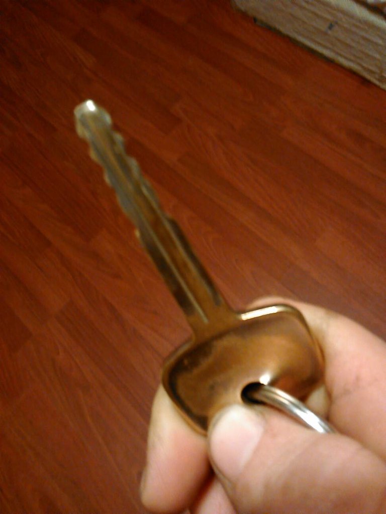

    I've been having issues every now and then getting the key to turn in the ignition. Problem is obvious- my key is worn out. The guy that owned it before me only gave me one key when I bought the truck in August of 2012, and it was pretty worn. (No chip or anything, it's a basic key.) The copies I had made don't work well either, since they were copied from this worn out key. It might take me ten minutes just to unlock the door with one of them, let alone try to start the truck.
    So my question is how do I get a new key, since my key is too worn to make a copy out of? It's driving me nuts.

    Go to the dealer with your title or current reg and your id if you are the owner. The dealer can make a new copy from your vin number

    It's typically done one of two ways, the quick, easy, cheap way is what most of us are used to, to put the old key in a key reader/cutter and a new blank in the cutting side. A feeler rides against the key side feeling the depth of the orig, the cutting side is connected and simply cuts as deep as the 'reading' side can go. Move back and fortha a few times and polish it. Done. The copy is only as good as the original or donor key.
    The slightly better way is to cut it the way they were done when new; according to a set of measured depths, no orig is used, the 'recipe' is in a manufacturers list of keys based on VIN. For example; tooth/pin one is cut to a depth of '5', tooth/pin two is cut to a depth of '2', on onward across the sides of the key. This method provides an exact duplicate of they keys as originally provided.

    a locksmith can do it as well. They put a blank in the hole and turn it with vise grips attached to the key. It leaves an imprint on the key. They file it by hand and do it again. After a few tries at this it then turns. They fine tune it and done.
