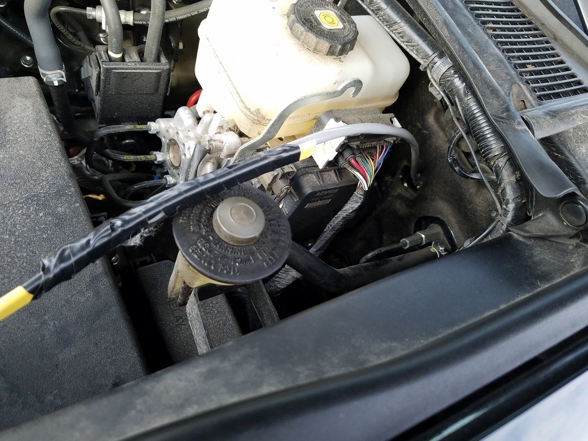

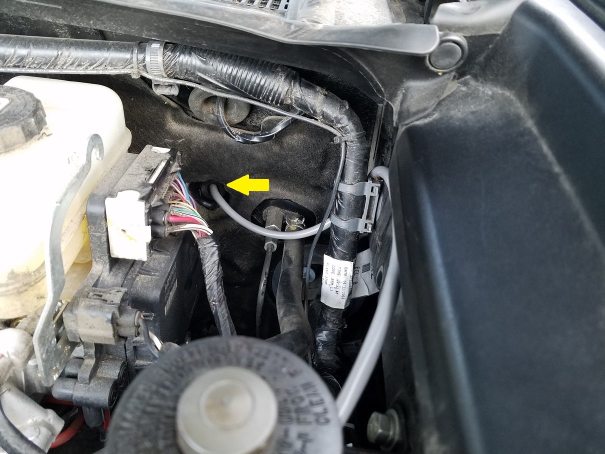

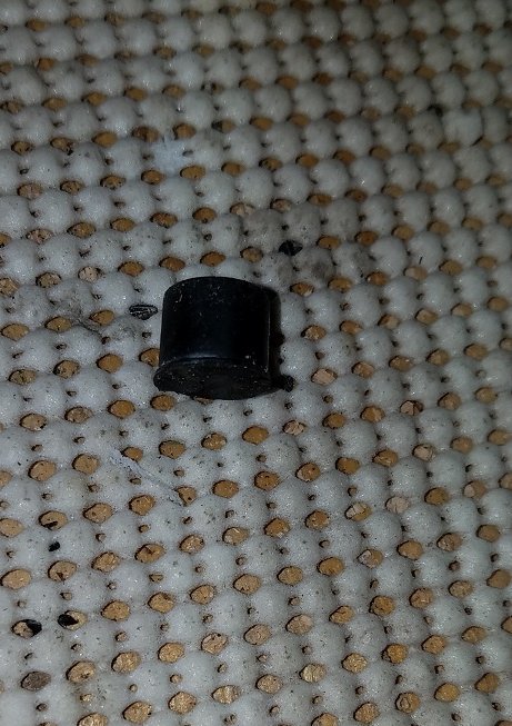

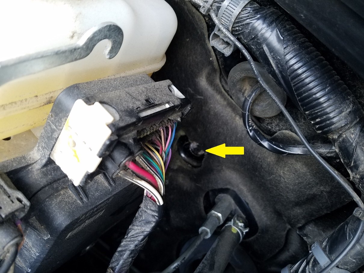

    There should be another unused grommet behind your brake booster. Pop that out, and unfold it. Cut out the center plug and put a small "X" cut in it. then fish you wires through there.

    When you go to feed the wires into the cabin, it may be easier to feed the wires through the grommet, out in the open first. Once they are through, feed them through the firewall. Then push the grommet down over the wire and push the grommet into place in the firewall opening.
