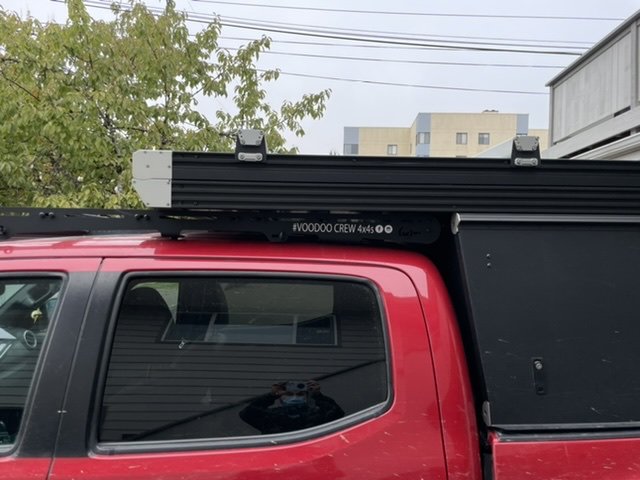

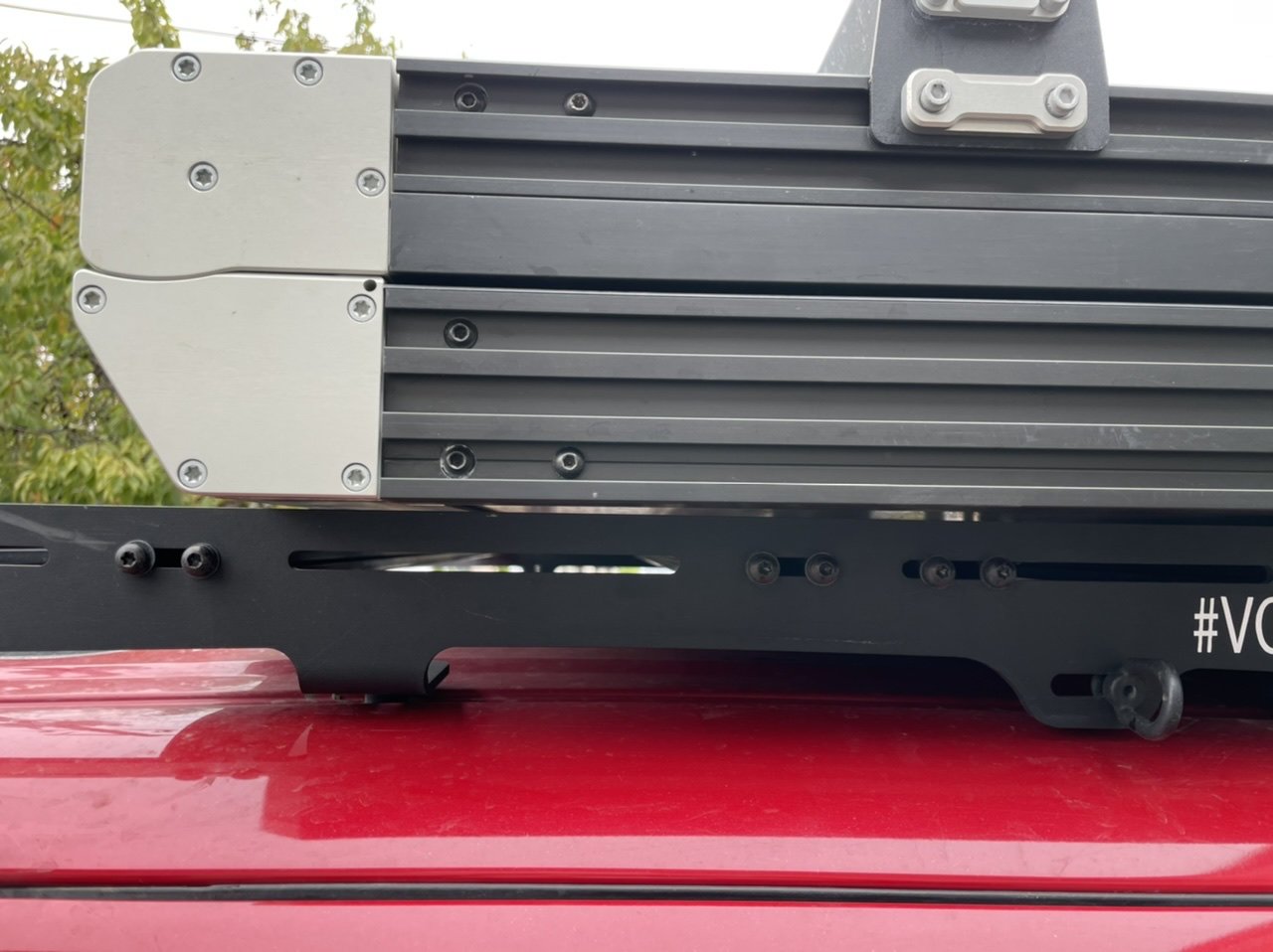

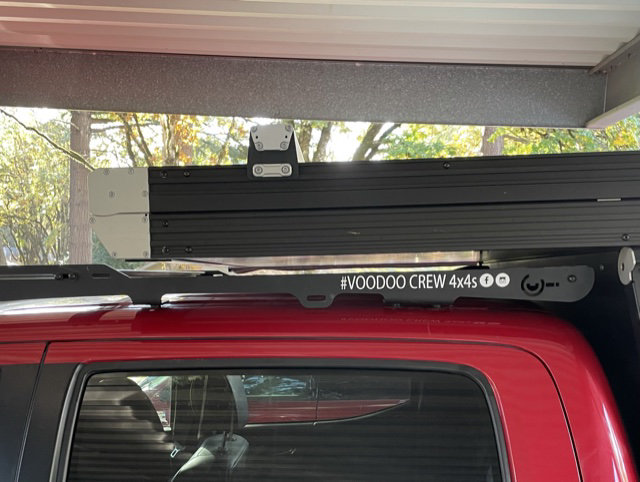

    Here is some photos of the Go Fast Camper fitting on a Short Bed Double Cab Tacoma. The GFC clears the Prinsu Cab rack by just a hair without any cutting.
    Did a bit of wheelin’ the other day and it definitely was coming into contact with the rack often. I plan on putting some shock absorbing spacers in between the small gap to see if this will help without putting too much constant stress on the camper and the rack.

    I wager you'll not gain good measures by insulating between the rear portion of the rack and GFC cabover.
    If you are keeping both mods, long term: cut off the Prinsu past the "B" pillar. You require more articulation between the bed and cab than your current setup offers.

    You could also try putting some vehicle trim on the prinsu to avoid metal on metal contact. Like the stuff they use for aftermarket bumpers when you make cuts.

    I personally recommend cutting down the rack to give yourself some more clearance. Other manufacturers (alucab) have a minimum clearance measurement that they recommend between the overhang and a rack.
    Hit a big enough bump on or off-road and it will cause decent damage.

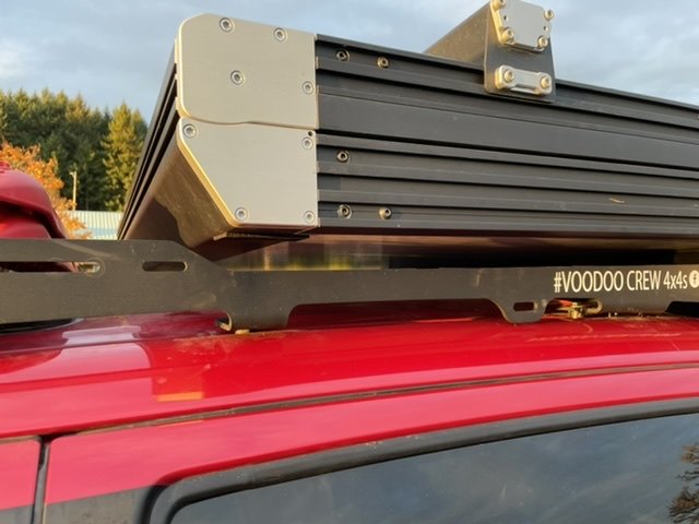

    Update: ended up cutting about an inch off the back end of the Prinsu cab rack. Haven’t had any problems with the GFC touching the rack now.

    It has alittle over 2inches of clearance between the cab rack and gfc overhead. My bed hasn't flexed enough to hit it anymore but if it does, I'm going to keep shaving the rack down until everything is good.
