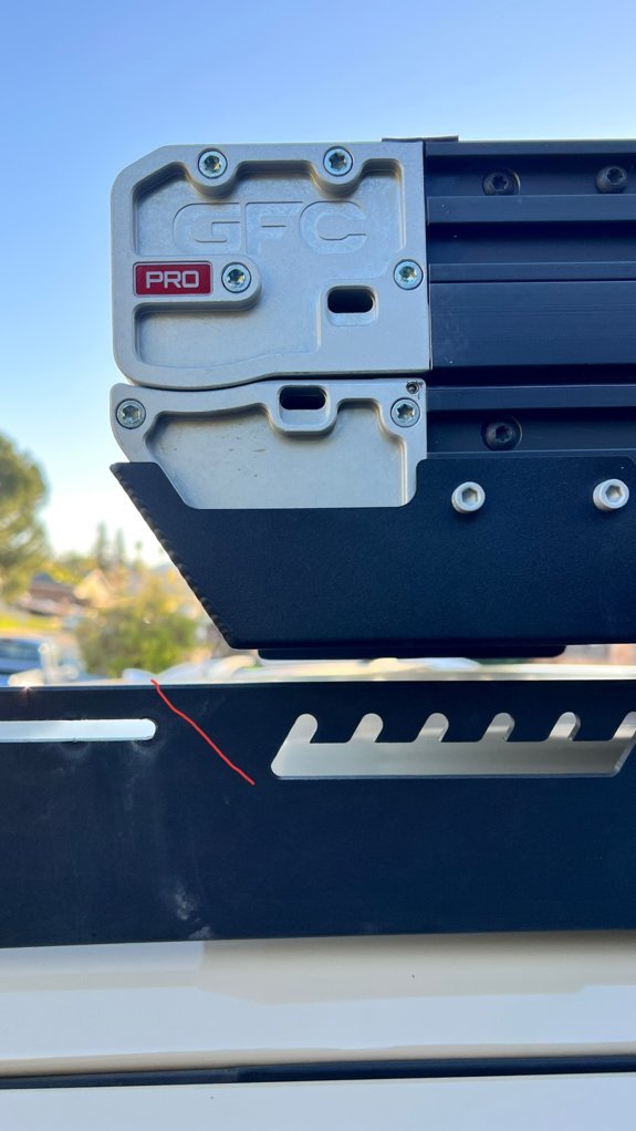

    Thanks for the photos. Can’t wait to do mine!

    What did you use to cut the rack? Did you have to take it off completely to cut?

    How did you cut it? I have same rack and ordered a V2. Stressed about removing it because of possible water intrusion issues.

    Found this thread pretty helpful. I have an UpTop rack and just recently got my GFC installed. Removed my rack for the install and was going to trim it similarly to yours. Mocked it back up to see where I’d need to cut and looks like I have slightly more clearance than you do. Do you happen to know how much the bed flexes? Deciding if I should even trim mine.
    Another possibility is that I just notch out a small area of my rack that would come into contact with the camper
