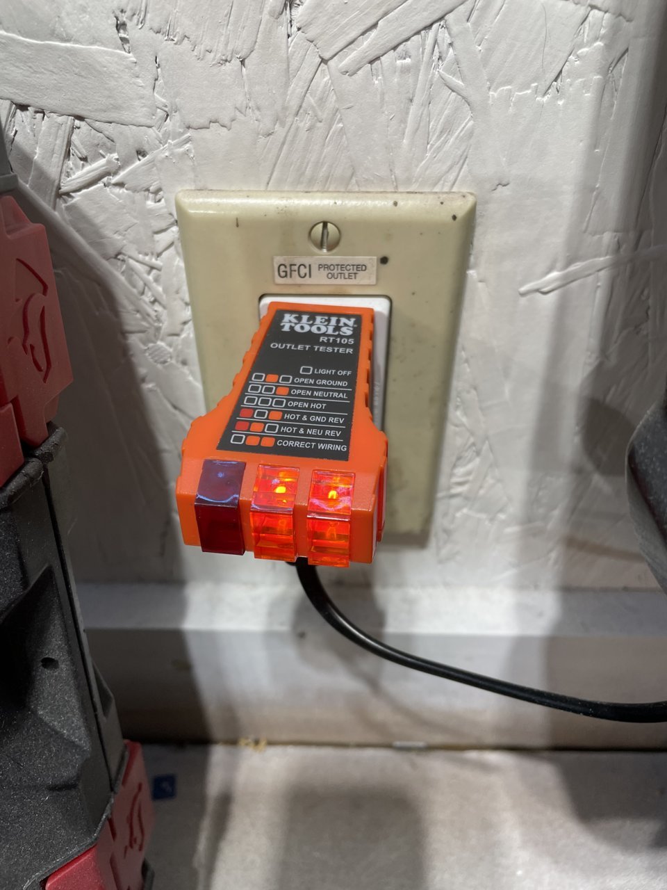

    0E945FCF-80E7-4148-8557-6D62D88E5EAA.jpg I made sure the line and load were correct. I have an outlet tester to confirm that

    Not what I'm talking about. Run a drill or hair dryer on the outlet your having trouble with. If it still trips. you have your hots and / or neutrals reversed. A tester will not show you what I'm looking for.
