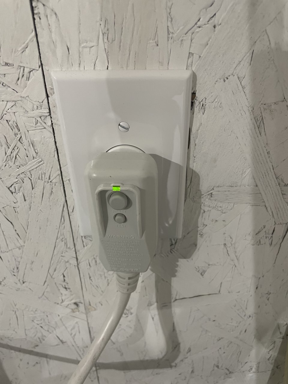

    Just curious? Does the new AC unit have a GFCI device on the cord? You can't run two GFCI devices in series.

    It does. Or I think it’s an afci device on the end of it. It has the test/reset button on it

    "Light-Bulb" !!!!!!!!!!!!!!!!!
    I can't say for sure. But that is probably the problem. I do know "for sure" that you can't run these devices in series.

    The GFCI branch circuit protector is being run in series with the GFCI equipment protection. This application will not work. I can't explain why this doesn't work. But I've seen it play out this way IRL many times.

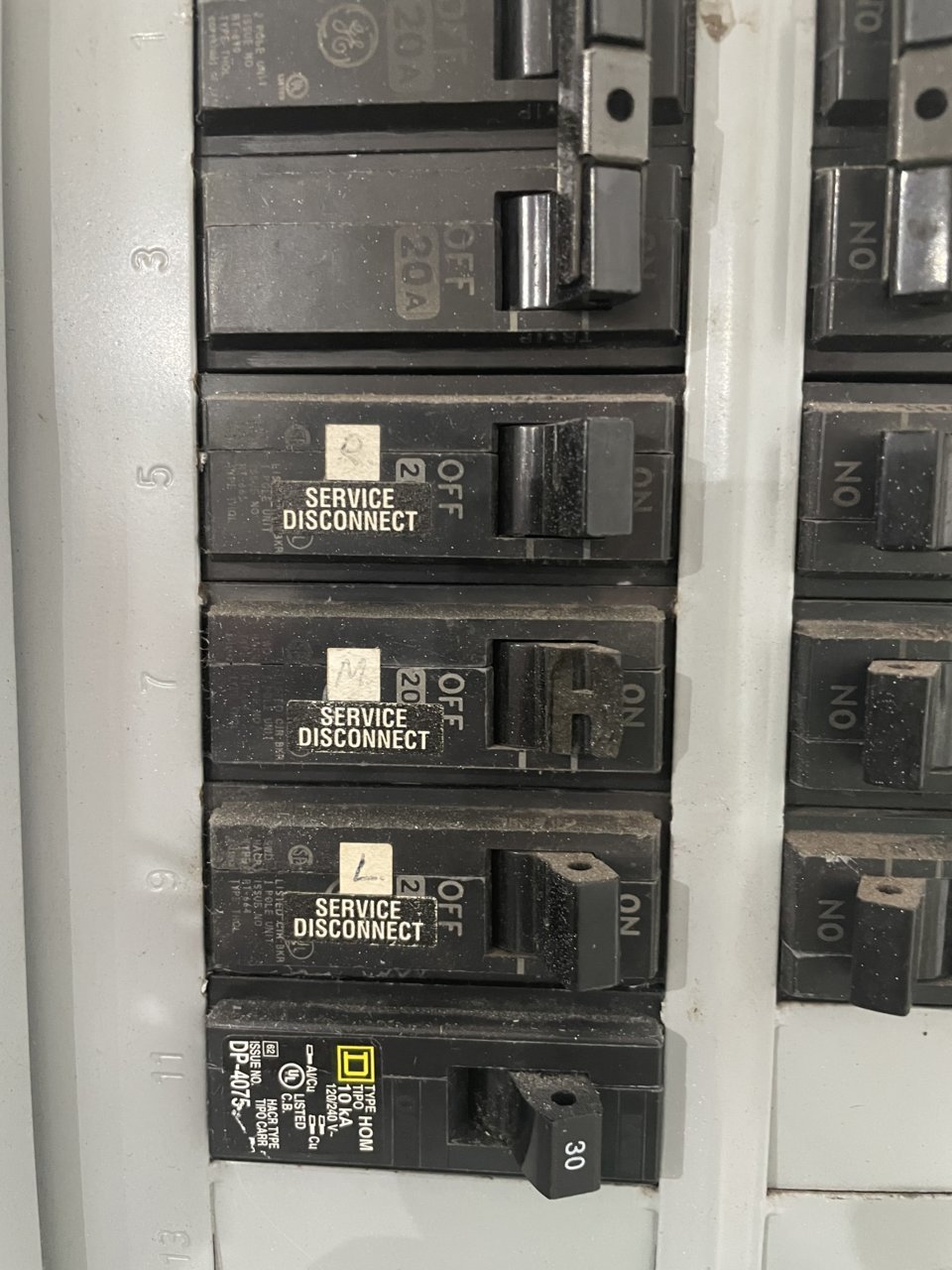

    #7 is the circuit the ac unit is on

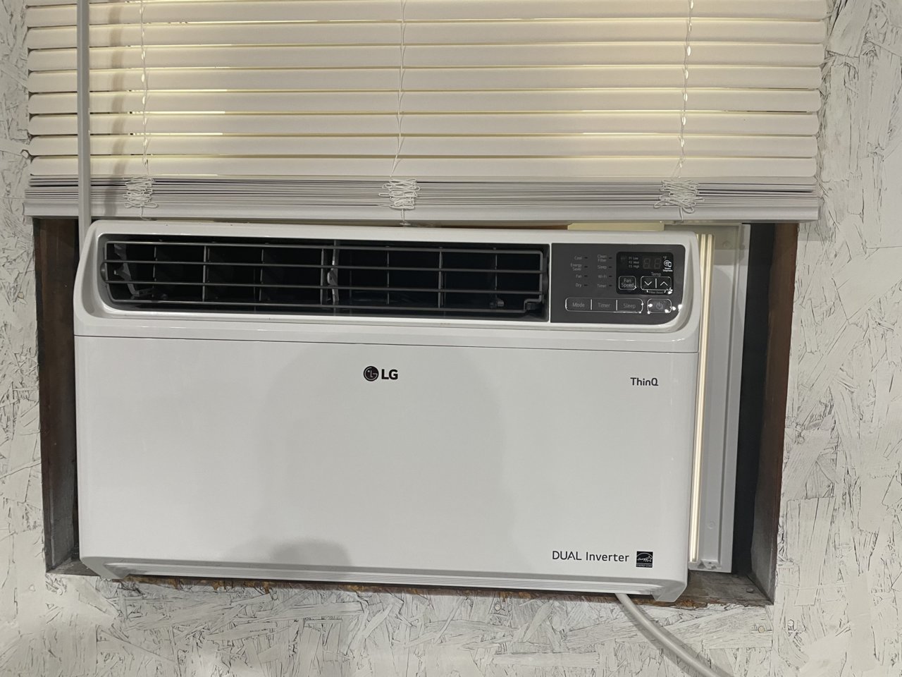

    End of ac unit plug going into a single 20 amp receptacle. The ac unit itself is designed for a 15 amp plug
    AC unit

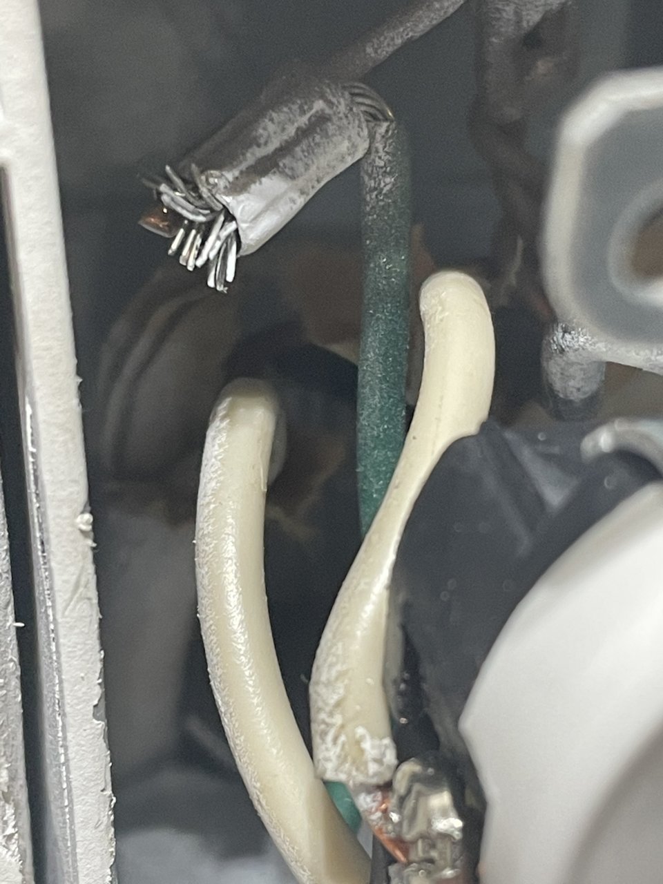

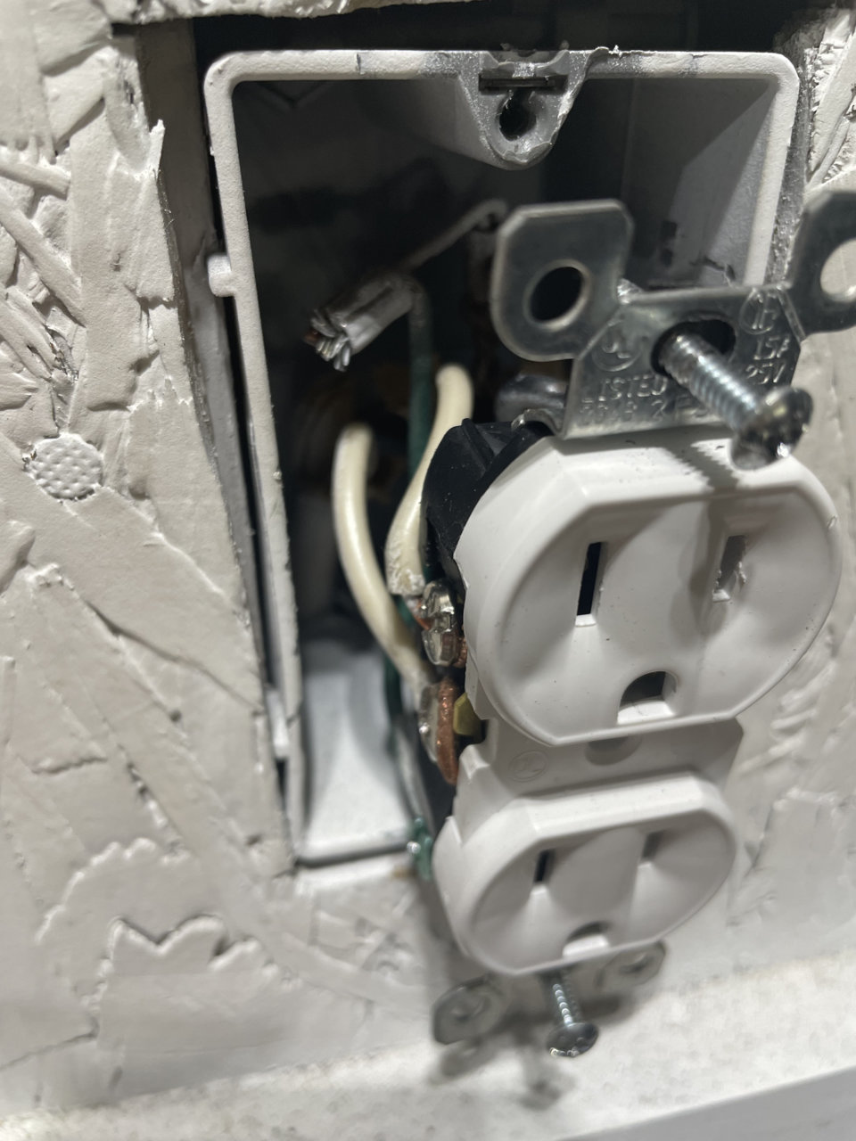

    Plug wiring. This is where the GFCI used to be but is currently removed for this standard 15 amp receptacle. AC unit works fine and so do the rest of the outlets without the GFCI.
    Hard to see but the wiring has white sheathing around it. That's 14 gauge, right? Which means it's only rated for 15 amp so adding the 20 amp GFCI or any other 20 amp receptacle does nothing?

    It's 12 awg wire.
    It's on a 20 amp circuit.
    Get rid of the GFI and use a normal plug.
    The unit is already gfi protected thru the chinga on the cord, like hair dryer.
    Also that plug I would replace with a 20 amp receptacle, pig tail the wires and fix the ground with a solid piece of wire.

    Also the Square D breaker is not rated for a GE panel

    Well it is on a 20A breaker. Personally, I can't tell from the pictures what the actual wire size is.
    Doesn't really matter what the current ratings are on the outlets.
    I wouldn't worry to much about the grounds. The bucannon crimp connector is just fine. I see that the primary ground splice is a little bit further back. Don't fix anything that isn't broken.
    What does that SP 30A go to?
