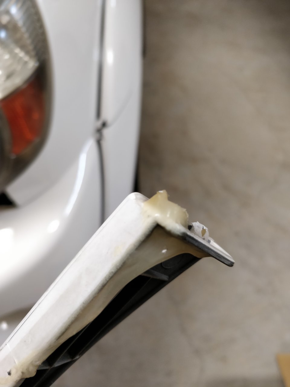

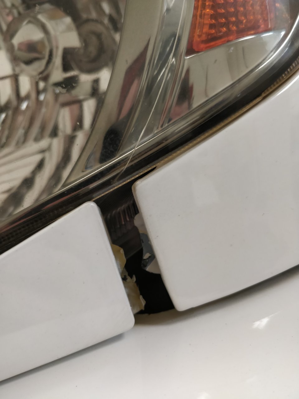

    So I just found this ghetto "fix" for what I presume happened when the head lights were changed previously at Toyota with the last owner.
    The crazy thing is, it came off like this. Was a tight fit and looked fine. Now it is physically impossible to put back on, and I mean impossible. Been messing with it for 45 minutes...
    Ideas?

    Looks like old hot glue or some type of epoxy? I think the tab you need to go into the quarter panel is broken off.

    The thing is I can see the paint on both parts and see how they fit together...but it isn't possible

    There is a tab that fits into the fender that is broken off.

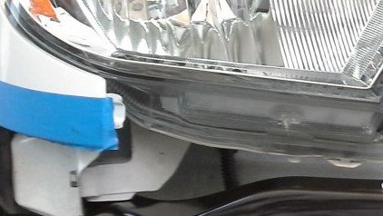

    Think your fender tab is bent .Might need to straighten tab and buy the black bumper filler clip anf filler .
    Like TomTom said
    jross20[OP], TomTwo and Boyk1182 like this.

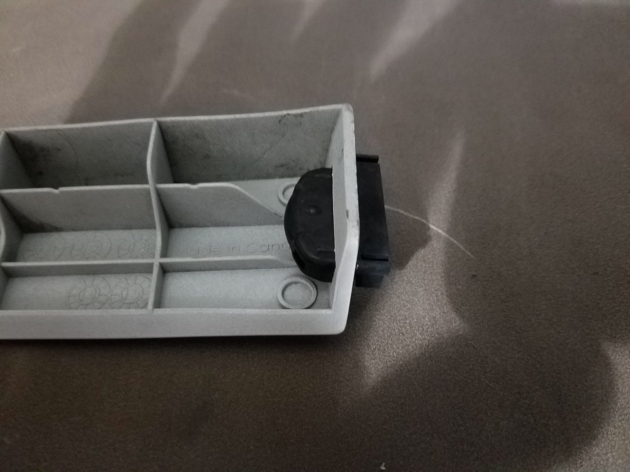

    Alright so the black plastic thing is missing and for some reason they choose to add this... Super strong crap.
    I got it back on after I realized changing the headlights was impossible... I think later I'll see about getting a dremal and cleaning the slot.

    In pic I posted of headlight you can see the bolt bellow the blue tape .
