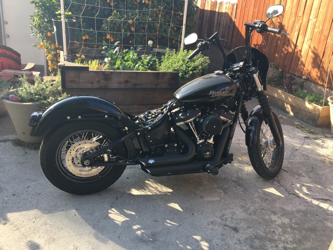

    Hans Solo in Carbonite bug, nice work Sergio!

    Thanks Bob!
    :fistbump:
    Oddly enough, my bike's named Robert... :anonymous:

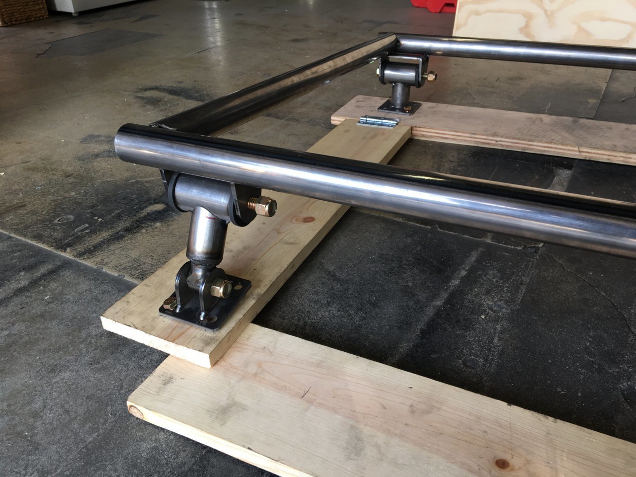

    What is this? I need to know if I want one.

    Its a spare tire mount that goes on top of a diamondback tonneau. The pivoting hinge allows the rack to be mounted on separate planes of the cover and still allows complete functionality of the cover. I’m actually pretty excited about this one. It’s getting powder coating once completed. Pics to come.

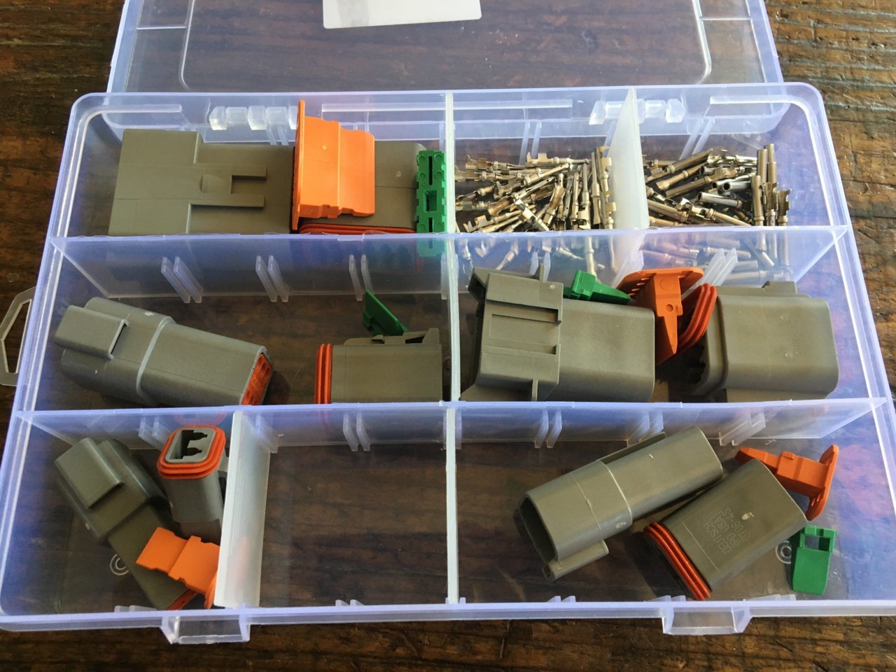

    Seeing these connectors excite me for no reason at all. :laugh:
    But dang, they're so satisfying to use and beat the weatherpack/bd connectors all day.

    I prefer the deutsch connectors and use them whenever I can. I have the cheap black and yellow ones on my truck from back when I did my fuse block way back and have been wanting to redo them all. The crimps are the same and require a ratcheting double crimper but I just like the look of the deutsch better.
    I used a three pin connector out of that kit for the motorcycle fender project.

    BD and a couple other vendors recommended me to use a butt connector or a crimp to connect my aux lighting to my factory up fitter switches. I couldn't stand that and wanted to try out the deutsch. Now I want to redo the BD weatherpacks for the two pins :laugh:
    They do look better! and I personally think they function a bit nicer when I connect/disconnect the points.

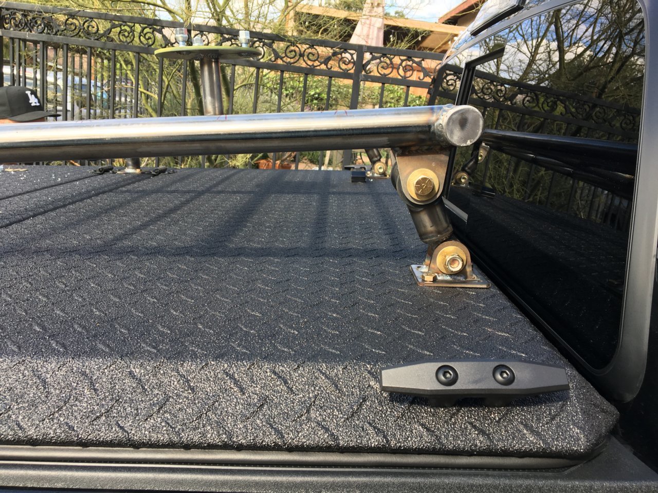

    Installed. Damn, I’m proud of this one.
    Owner is getting powder this week and has upgraded support struts to account for the weight of the rack and the spare that will go on top.

    That design is genius! I'm in once I can afford a cover like this hahaha
