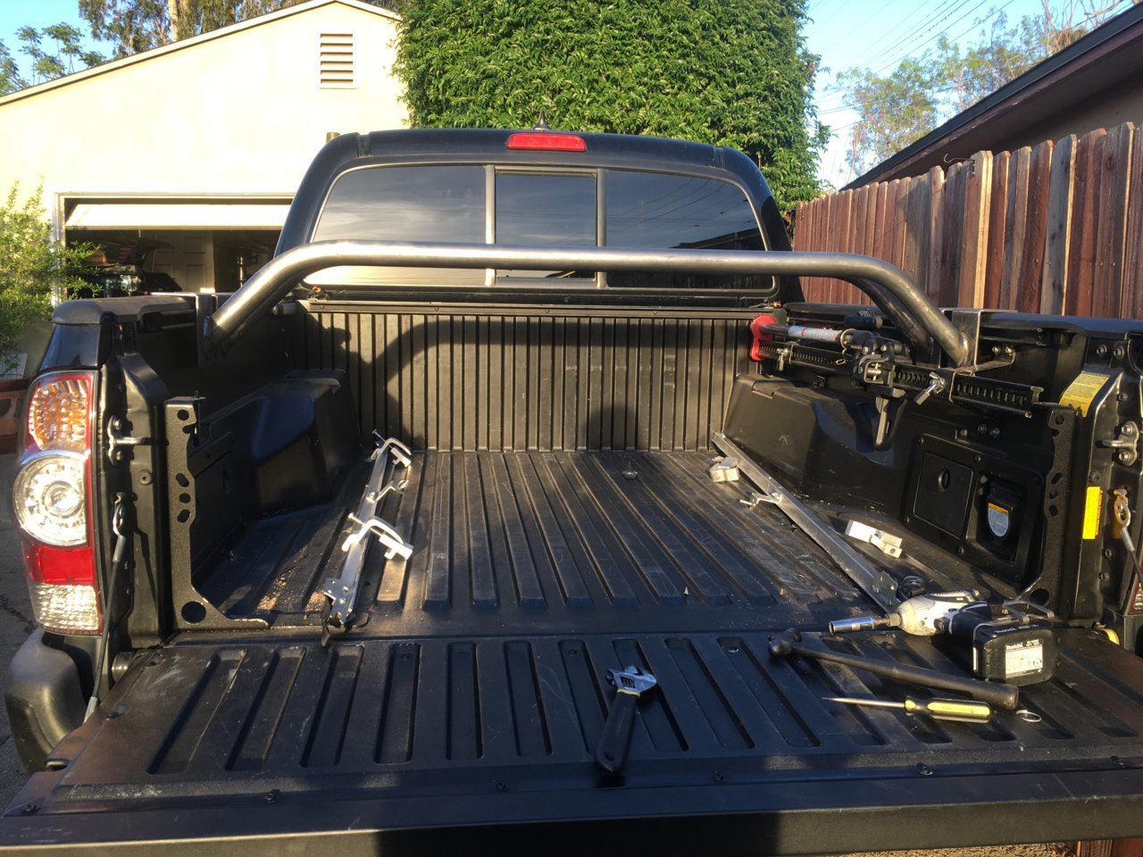

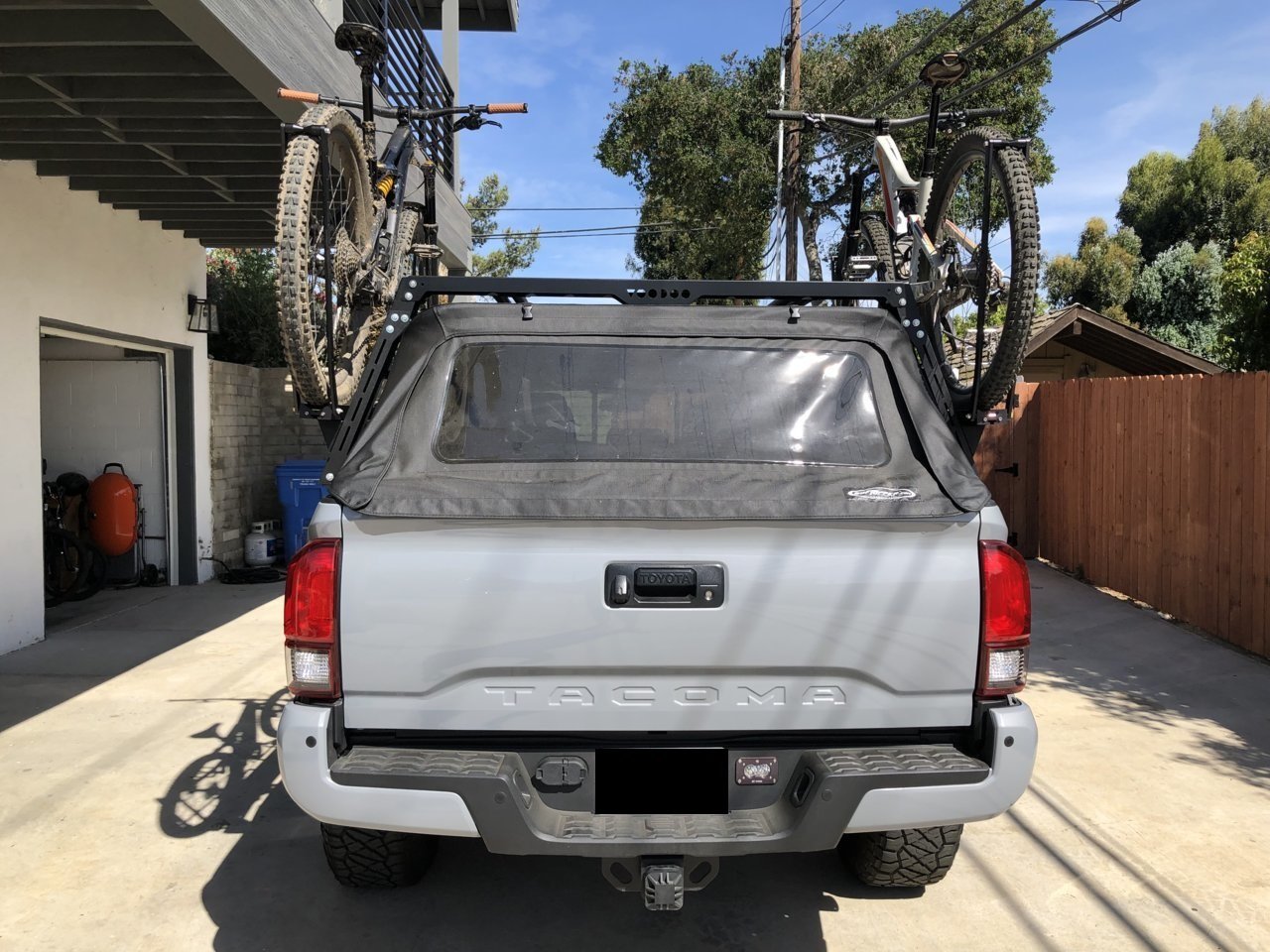

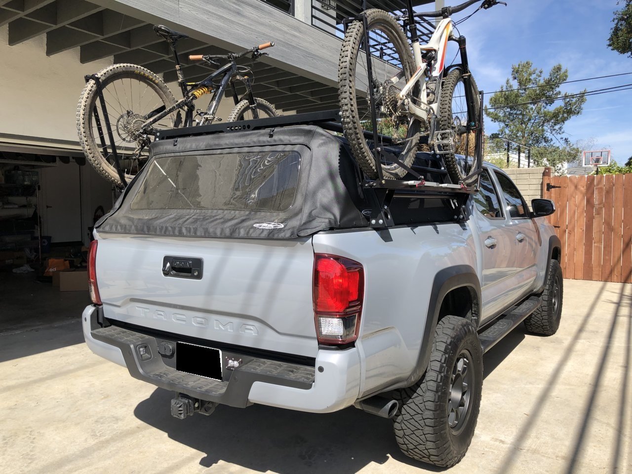

    Here’s a KB Voodoo bedrack that I modified to fit over a softopper, dimple died the holes to add rigidity, extended to full bedrail length with my own crossbars, and added custom mounts for a pair of 1UP bike racks on each side. really solid setup when I was done with it.

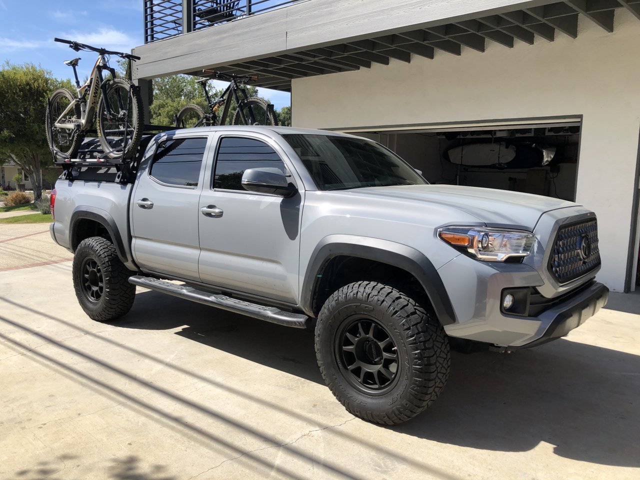

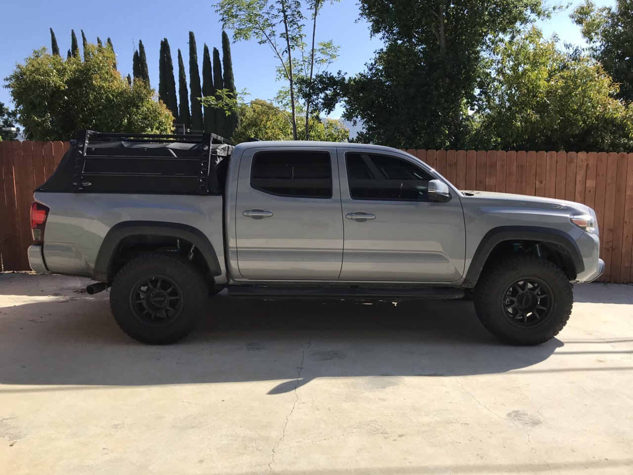

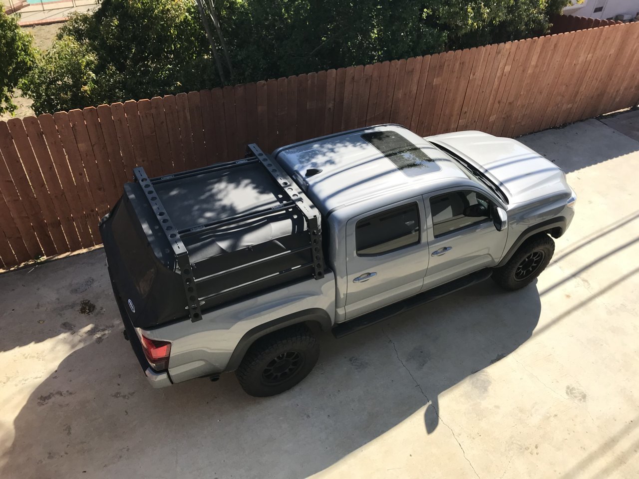

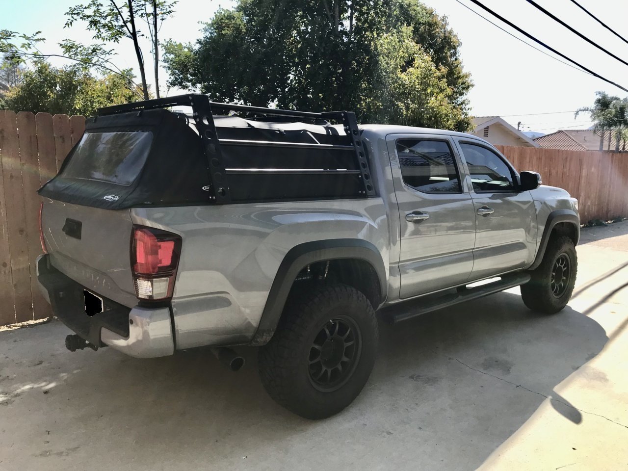

    Bed bars to fit an RTT under a softopper:

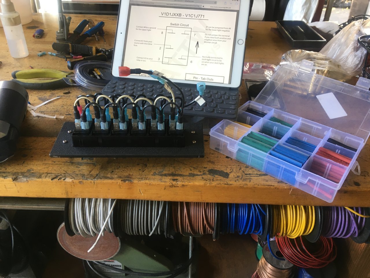

    Today’s project:

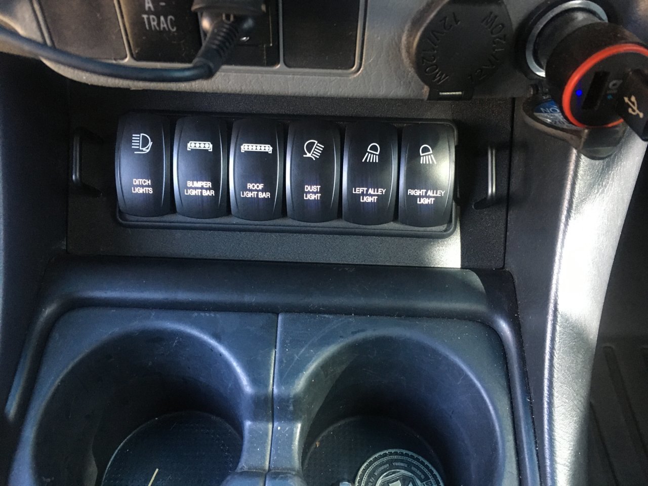

    Wiring OTRATTW switches in an Iggy panel- Lower independent. The words light up with the dash lights and the image lights up when the keyed acc is on. Accessories are constant hot.

    Thanks! Cleaning up some wiring from a previous install and adding new wiring for the new switches. Previous switches were basic single indicators that were u labeled. The driver would have to remember what each one activated.
