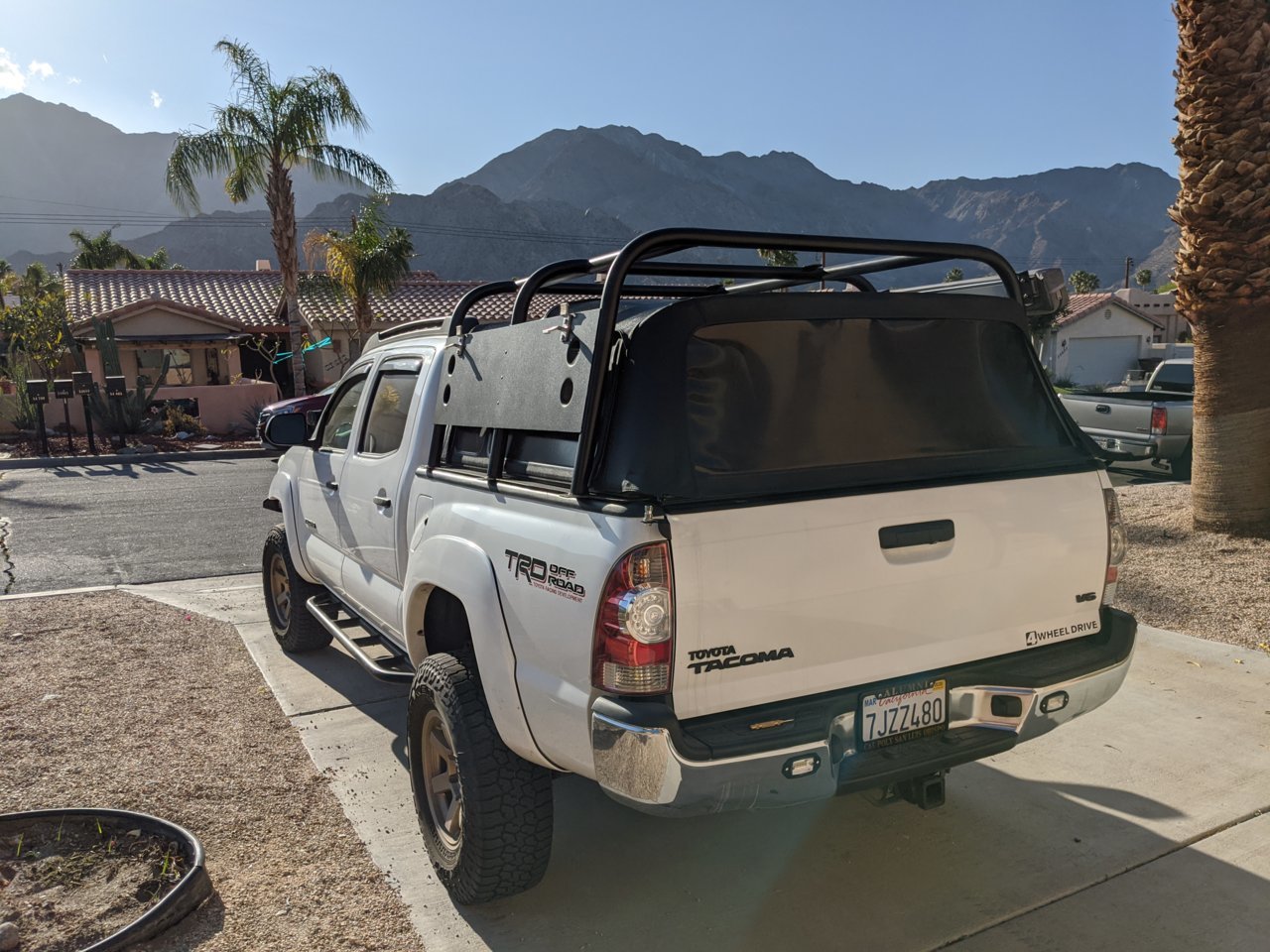

    Thanks Sergio for the awesome rack. I recommend anyone that needs some custom work done on their truck give this man a call.

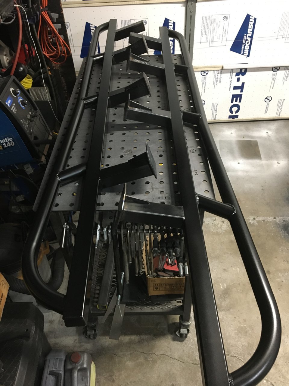

    Who wants sliders?

    Those look awesome Serge

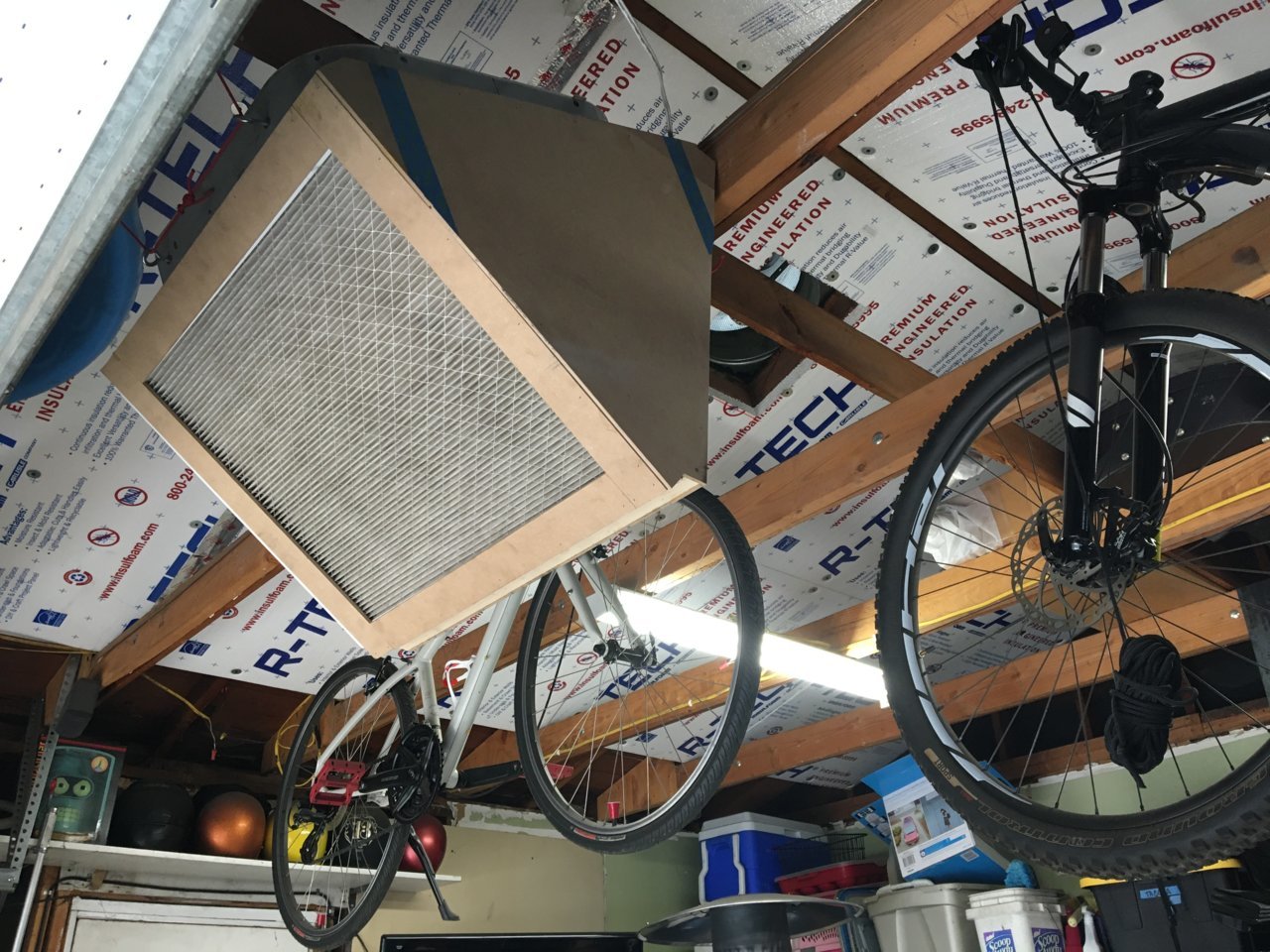

    Thanks Jason! With my DIY dust collection filter, the shop is a lot more comfortable to work in too. I’d greatly recommend it.

    How is that foam board working out? My garage gets hotter then hell during the summer and I hate it..
  15. Apr 9, 2020 at 10:13 PM
    #395
    GHOST SHIP
    GHOST SHIP [OP] hates you.
    Mar 9, 2015
    #150537
    22,398
    GHOST
    Works great to cut down on the radiant heat from the ceiling. I did it a few summers ago when we were over 110* here as a temporary fix because it was faster to throw up than traditional insulation. I haven’t felt the need to replace it so it stayed. I used 1.5” thick boards for the ceiling and 1” for my metal garage door that faces west and gets all the afternoon sun (you can see that in the picture of the sliders above). Both have made a huge improvement in the shop. The previous owner had illegally converted the 2 car garage into a rental unit and when he left, he partially tore out some of the makeshift walls that divided the space into multiple rooms. It was a quick and messy job to show it’s a garage agin but I still had a lot of demo to do when I moved in. Currently about 1/3 of the garage still has partial drywall and shitty insulation. I hope to redo it properly soon but I also have to rewire the whole thing (since it was wired as living quarters and not a working shop) and I want to add a sub panel for the welder and compressor. As you can see, that’s a project that snowballs into a huge mess. When I redo it though, I’ll probably leave the ceiling insulated as is.
    On the plus side, the new filter increases circulation in the shop without introducing a specific directional breeze that could disrupt welding gasses.

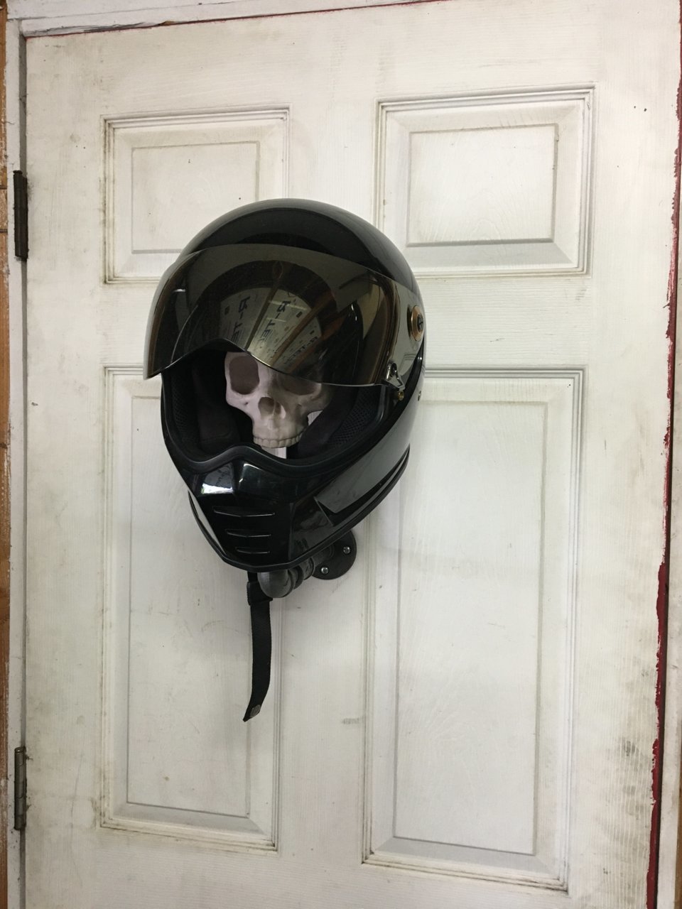

    Rainy day quarantine project. Needed a place to hang the helmet in my shop that wouldn’t get in the way. The black pipe means I’ve been on Etsy too much but I like it.
