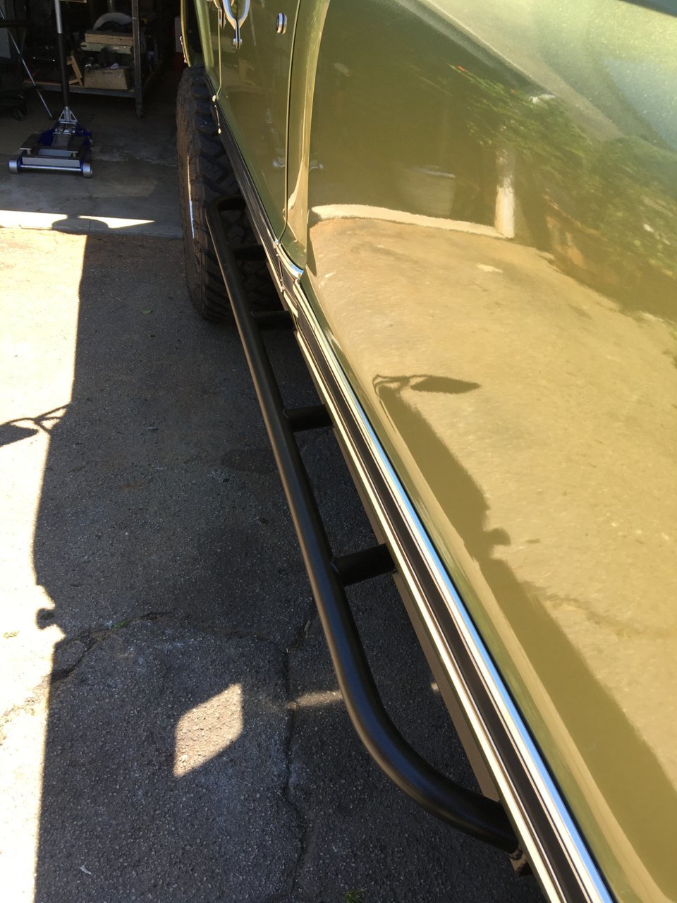

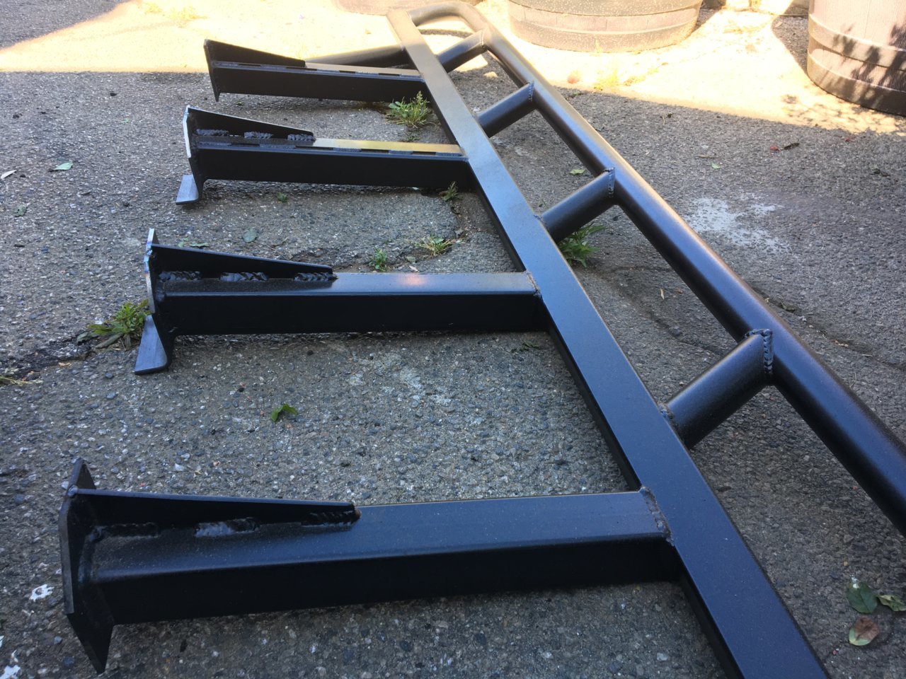

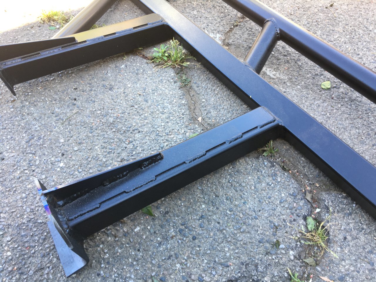

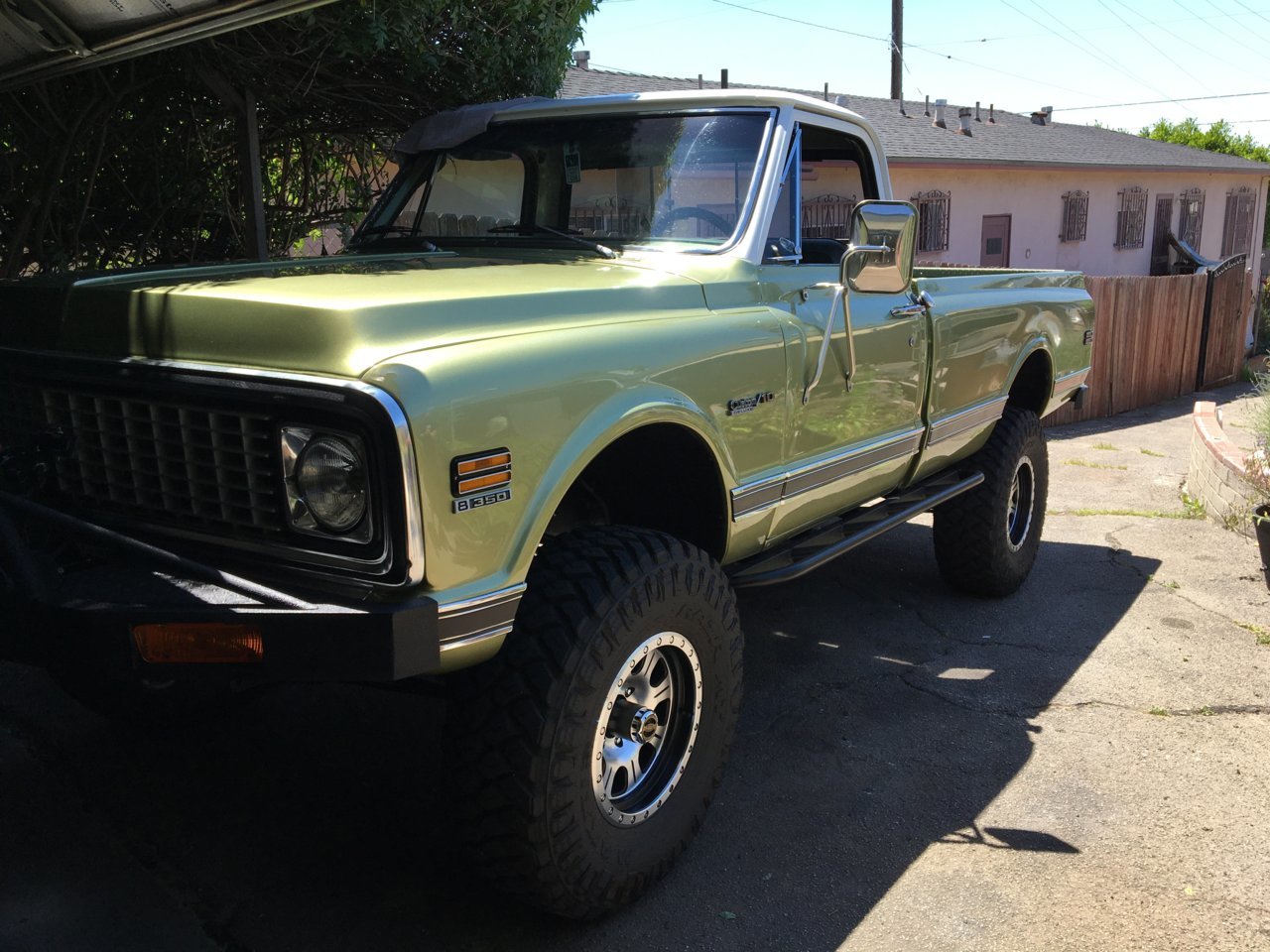

    Helluva fun day working today. Mega sliders installed on @Snow Cruiser ‘s 71 K10. This truck is fully restored and it’s an honor to have my sliders on it.
    Everything on these sliders is huge. The legs are twice as long as Tacoma sliders so I capped them with extra plate making them 1/4” thick to support the weight of the massive truck.

    So clean as always!

    The truck is badass and the sliders look great dude!!!

    Thanks so much dude! I get to see a lot of cool vehicles because of the fab stuff but this one is up there. Just clean and tasteful so I wanted my sliders to match that aesthetic.

    Did sliders exist in ‘71?
    well they do now.

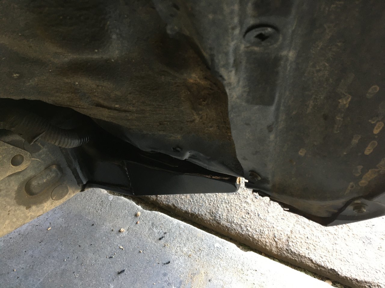

    CMC today on @Adoan ’s QS 3rd gen.
    So much room for activities! Hard to tell in this picture but the new plate for the CMC is behind the firewall. If there’s any contact at all, it’ll be the firewall before you touch the mount.

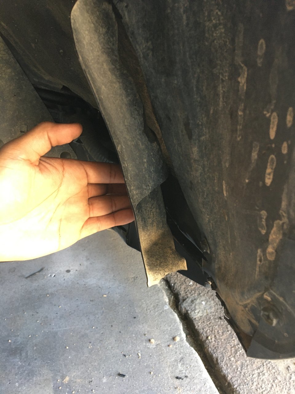

    this is a shot of the plastic fender well liner that previously covered the pinch weld. It shows just how much more room is gained by flattening it in addition the the CMC.
