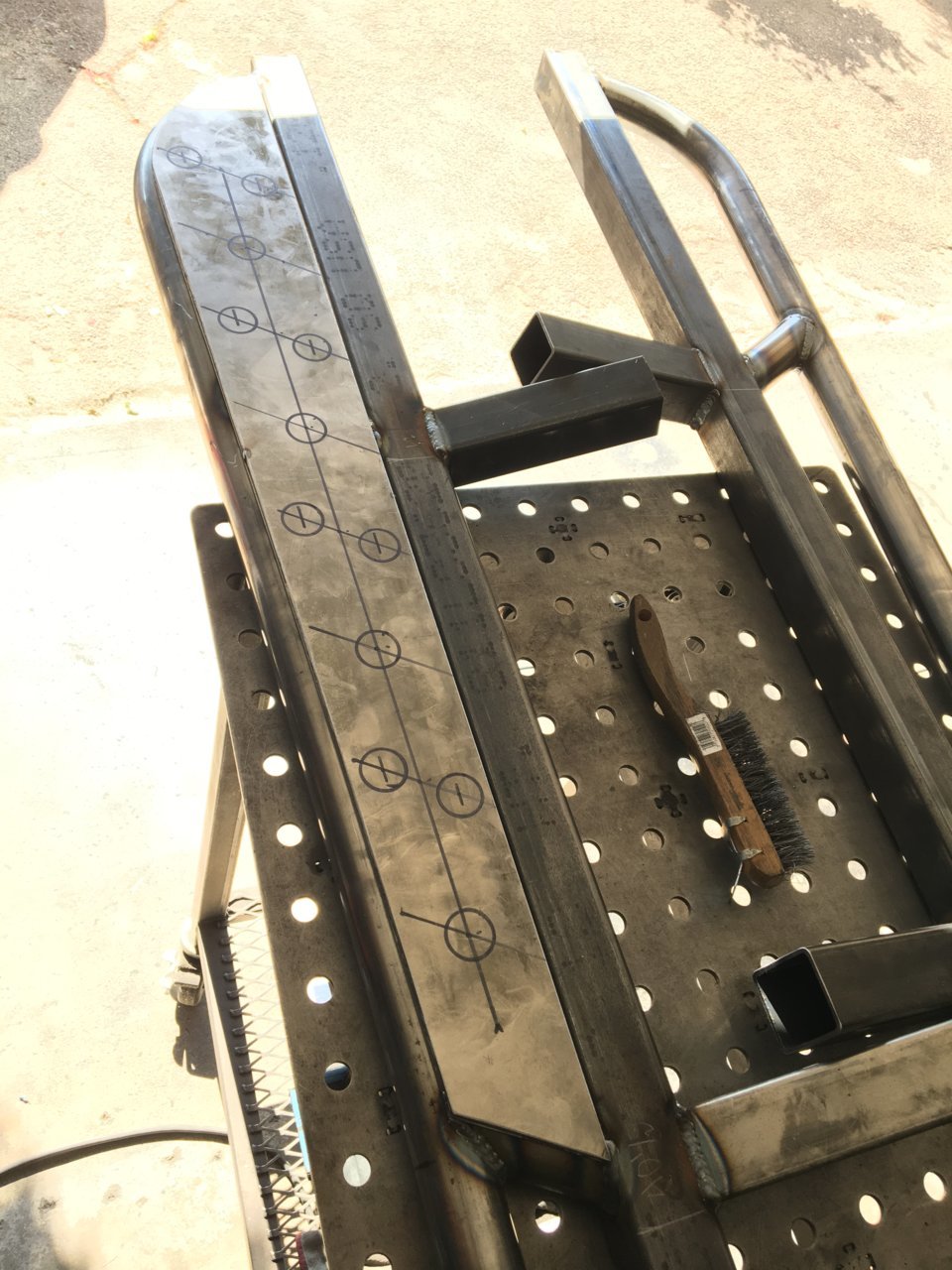

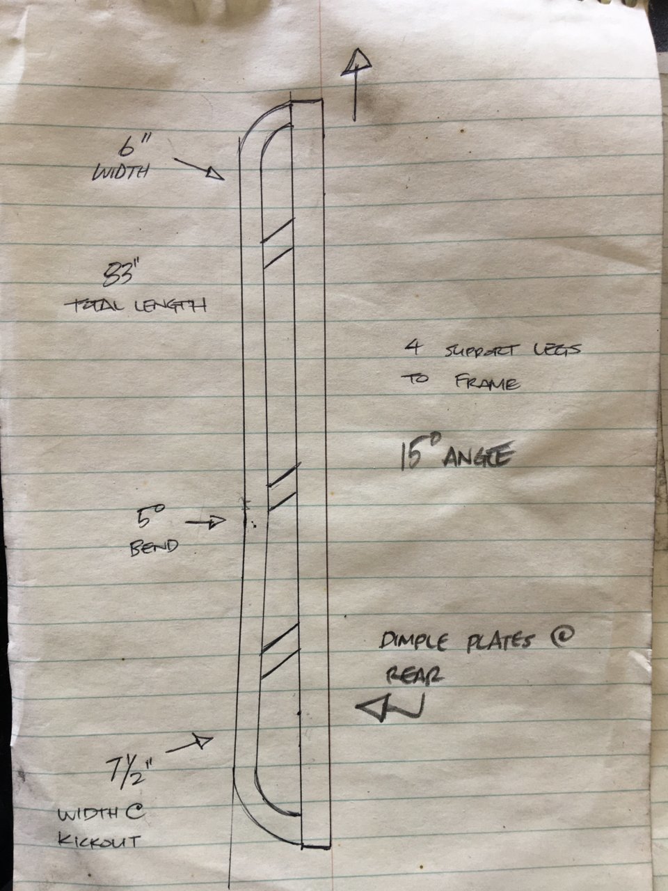

    I figured I’d document something here for anyone that’s a fan of the show “How It’s Made”.
    When contacting me for sliders, I’m more of a boutique builder than a production guy. Meaning that I take the time to talk over each build with the customer and what you want and how I can accommodate your intended use of your truck. Once we decide on the build (width, kickout/no kickout, angle) I’ll send a quick sketch as a “proof” with my notes. I realize the sketch isn’t to scale and the support tubes aren’t evenly spaced but that gets taken care of in the next step.

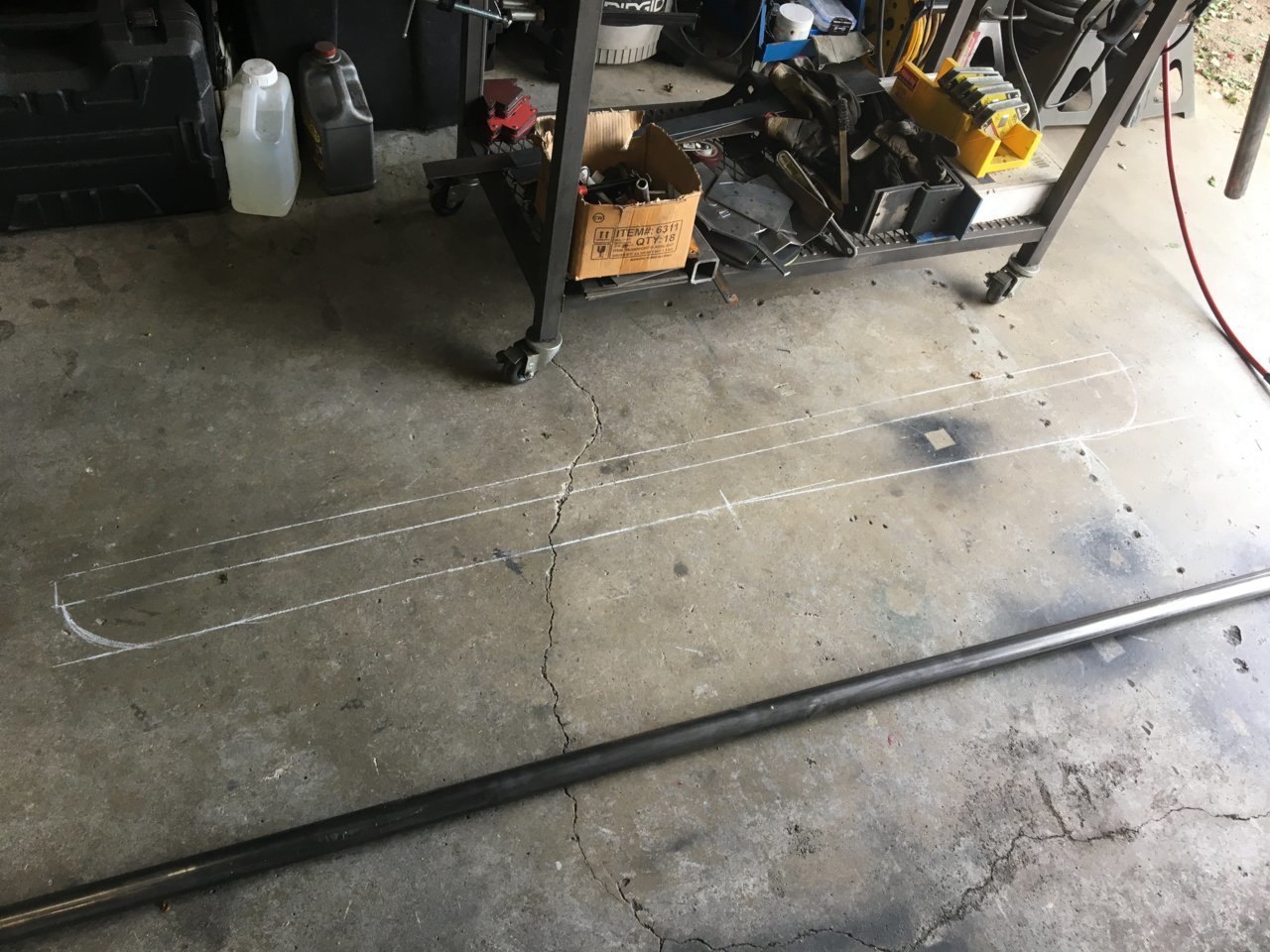

    Once that gets approved, I can start building. That begins with drawing a full scale version of the sliders on my shop floor in soap stone.

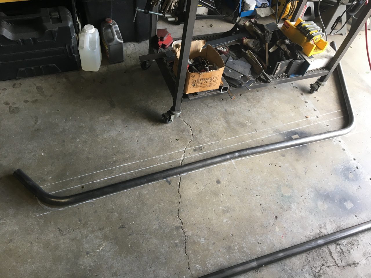

    Then I bend the tube to match the angles and curves of the drawing:

    This set in particular is being put together with top plates on the rear section and I layout the holes (which will be dimpled) after the sliders are built so I can verify that they flow well with the design of the sliders and are evenly spaced.
    As an added display of my commitment to symmetry, I stack and tack weld both top plates together and layout/drill the pilot holes at once to ensure that they are laid out exactly the same. Each hole is drilled and dimpled manually and then each plate section is cleaned up and sanded prior to welding to the sliders.
    These are teasers for now but I’ll post some finished pictures as I progress on this set.
