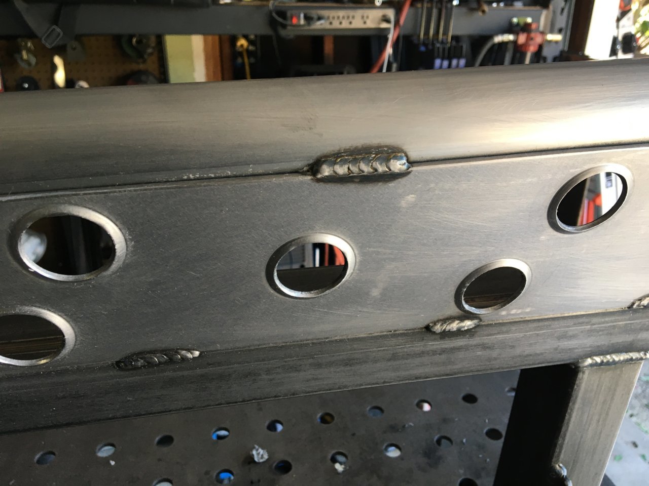

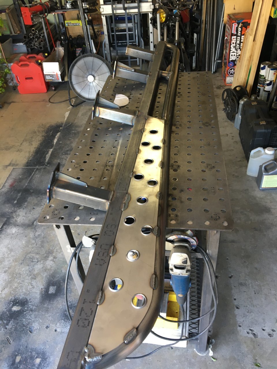

    On today’s episode of “How he do that?”:
    After the top plates have been drilled, I sand them with 60 grit. Even if that sounds aggressive it’s enough to give the metal some tooth for applying paint later. Then I can dimple the holes in the plates and weld the plates to their respective sliders.
    this is followed by fully sanding the entire slider and prepping for paint by wiping them down twice with a heavy duty degreaser followed by a final wipe of acetone before paint.
