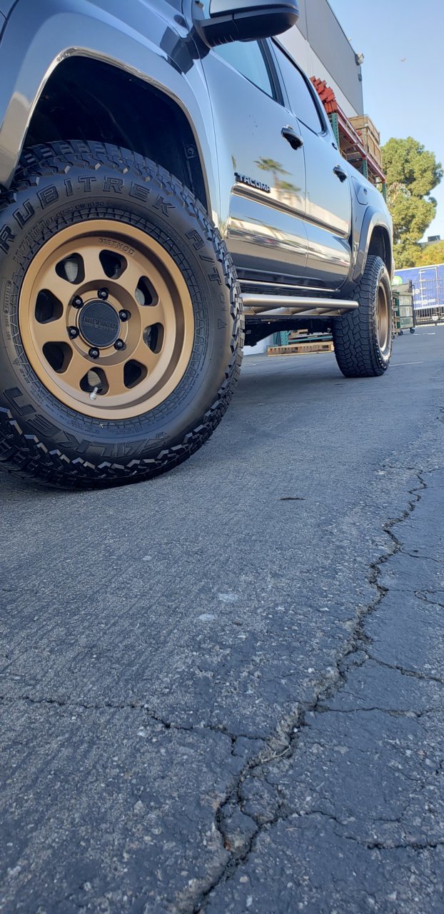

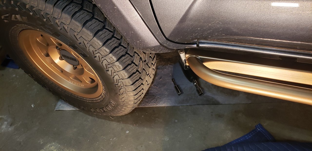

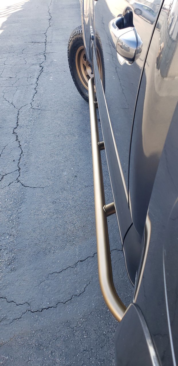

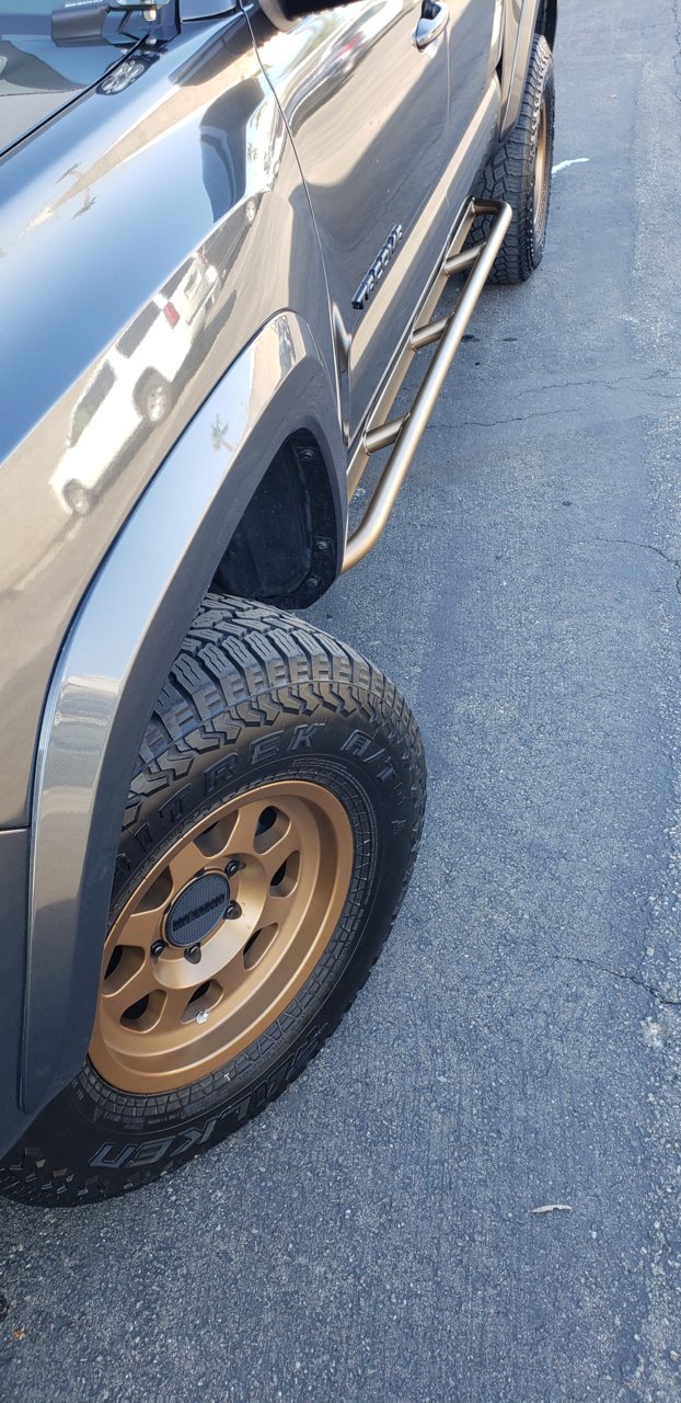

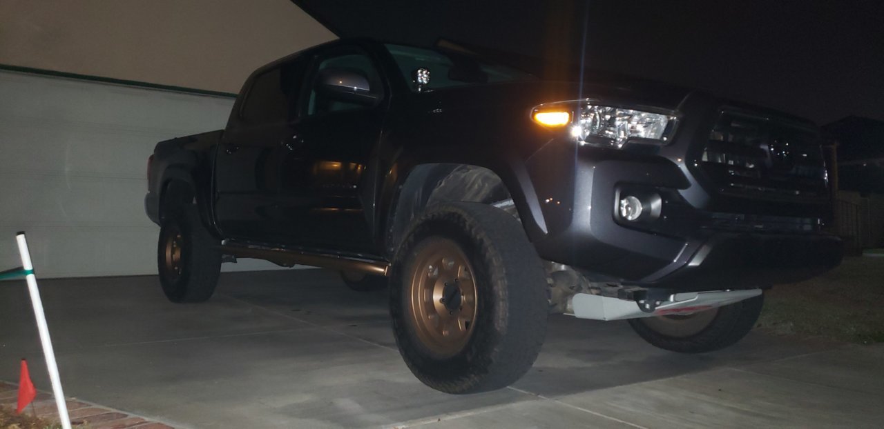

    Thank you Sergio. Thank you Maverick PowderCoat.

    Those look great! You should PC the skid the same color!

    I was smacking my head last night during installation..."why didn't I drop off my skid too?"

    That would make it POP.... looks like you're making another PC run.

    OH MAN !!! Those are pretty !!! Nice job !!!

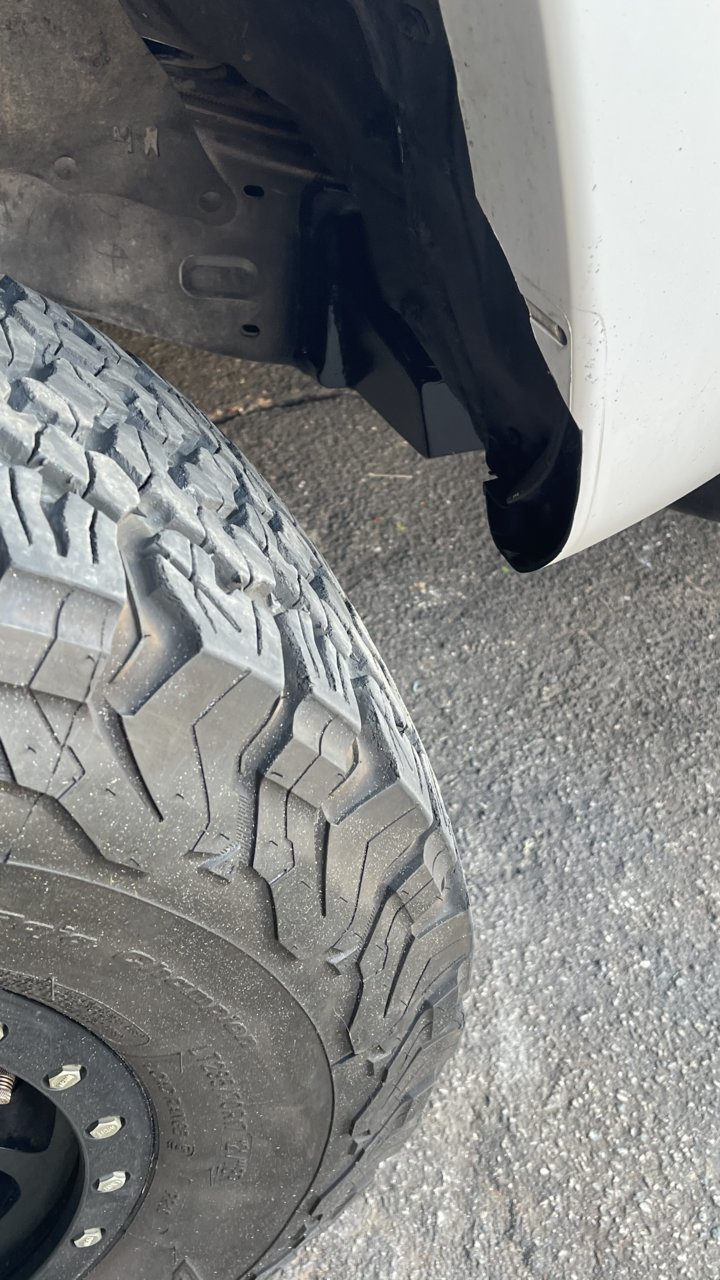

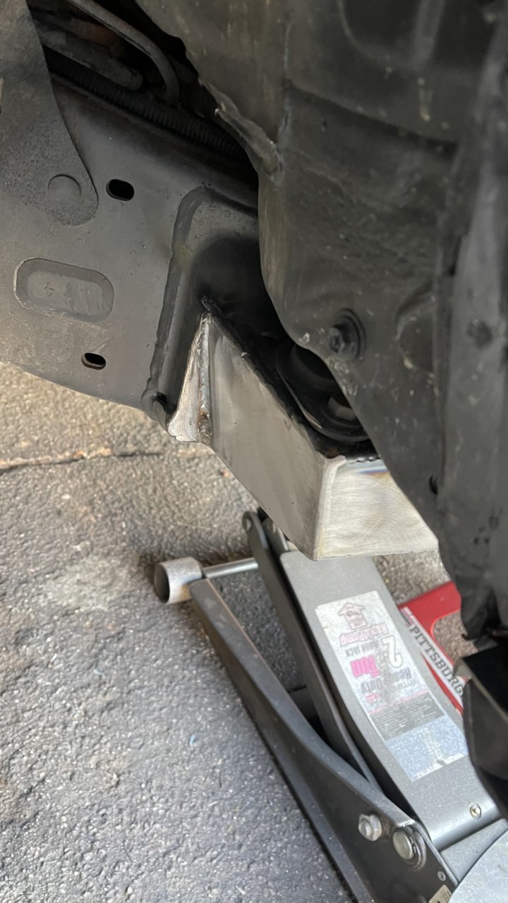

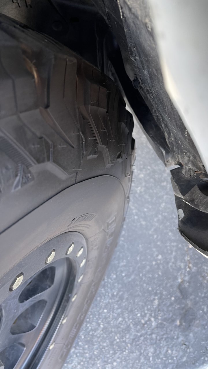

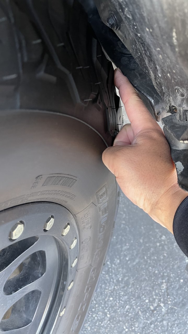

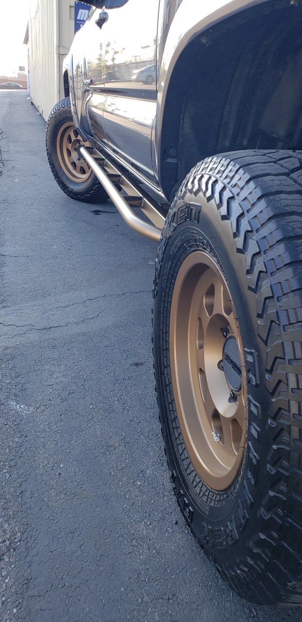

    Correcting a previous CMC done by another shop. They left a lot of meat on the bone and @Dansly56 was still having rubbing issues with 285s.
    before:
    After:

    Beautiful!

    I was more surprised to find they used 18ga steel for their “repair”.

    Thanks again for saving my weekend trip and doing the work on a short notice!

    Wow 18 gauge lol! Thinner than 1/16th hahaha
    Dude, at least the shop used different material to enclose it lol. I’ve fixed 2 CMC’s in the last couple months that were done by 4wheelparts and all they did was take a cut off wheel to the top and bottom line and then hammer it in as far as it could go and then weld those seams back up lol. With the weld they seemingly stuck out just as far as they were before haha. I asked both customers how much they paid and, let’s just say they both got kinda screwed over.
