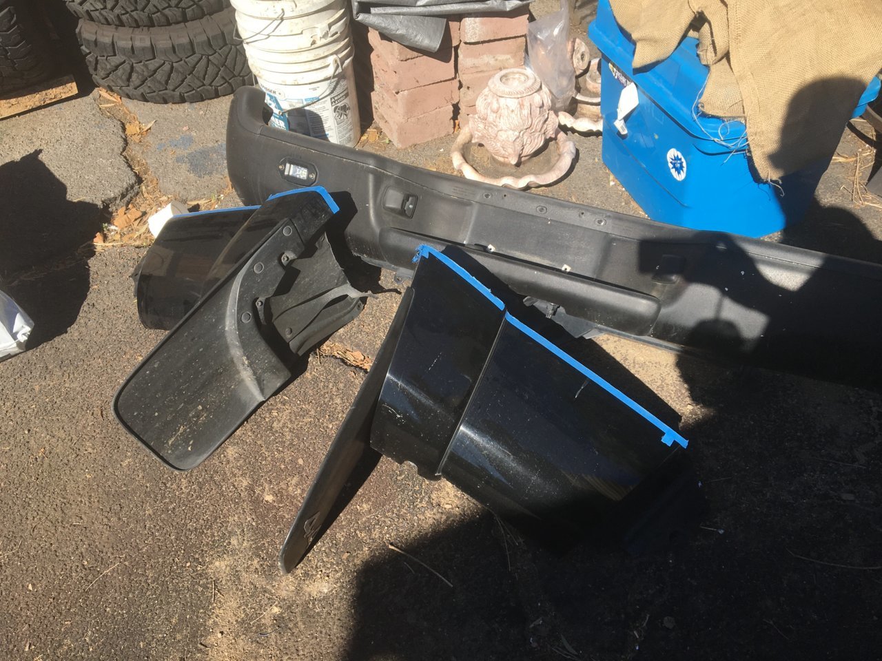

    I didn’t see the bolts until I had already cut the fenders off.

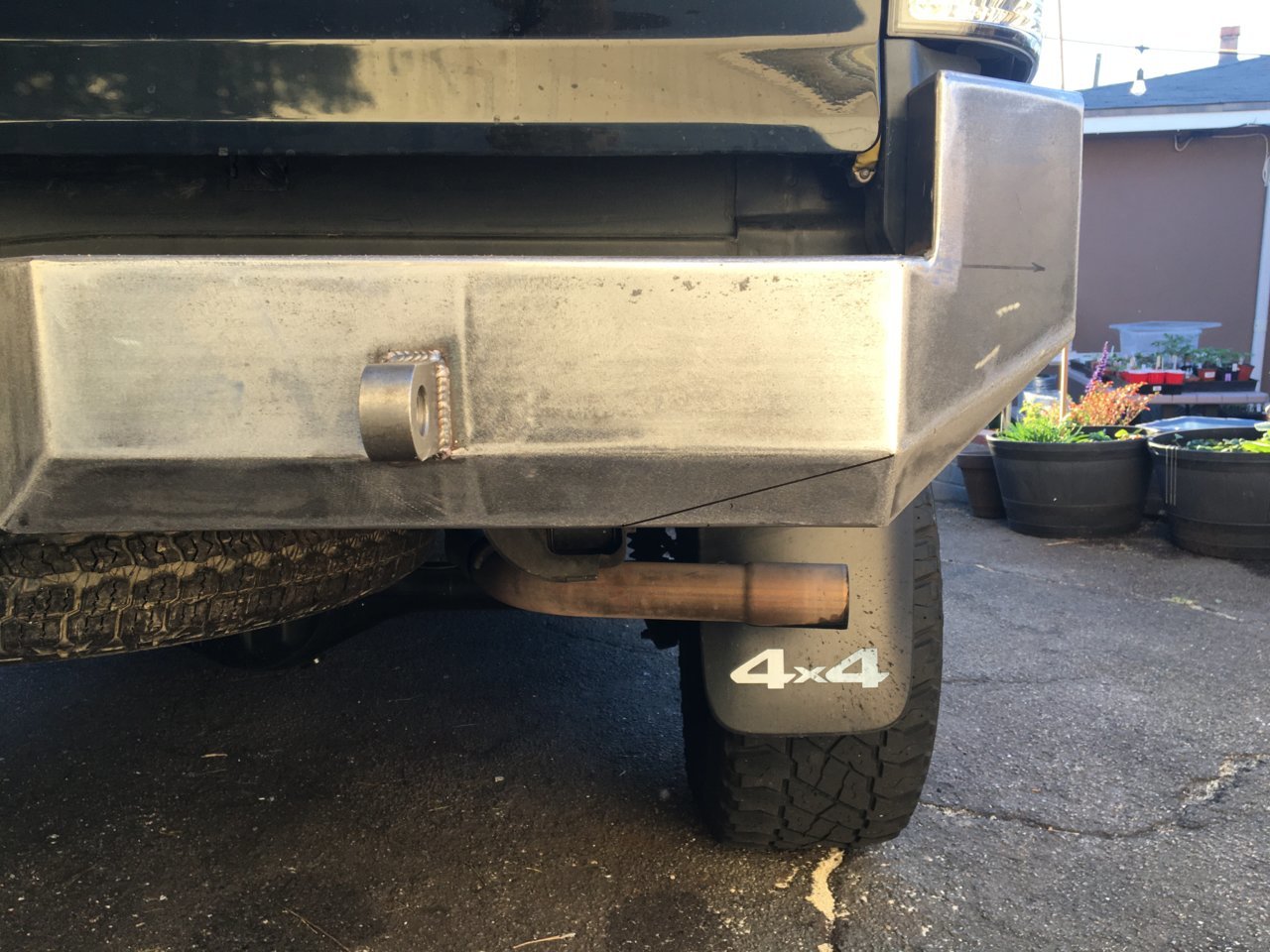

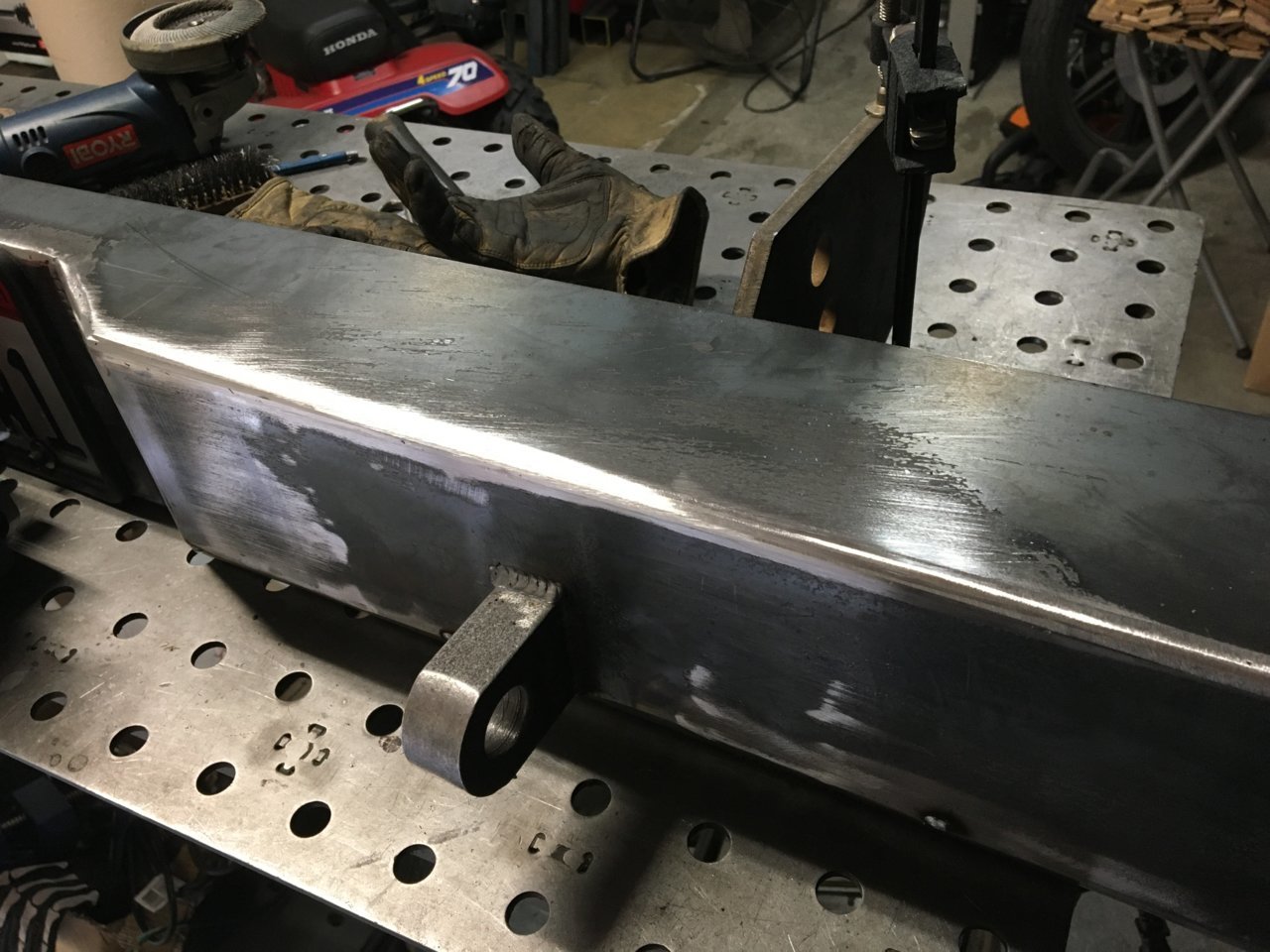

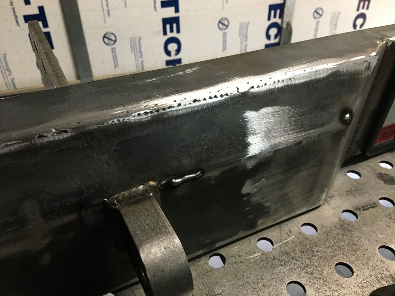

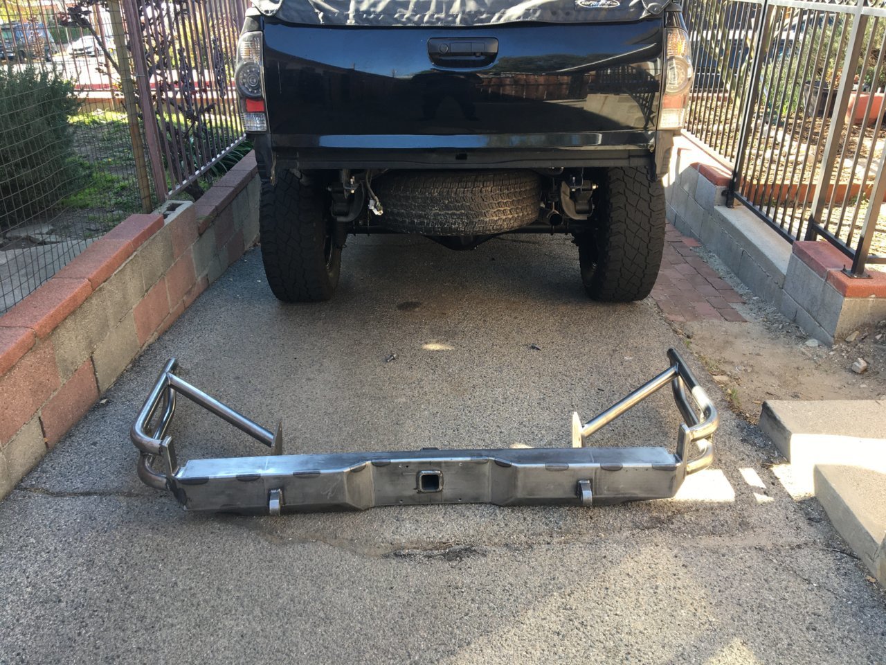

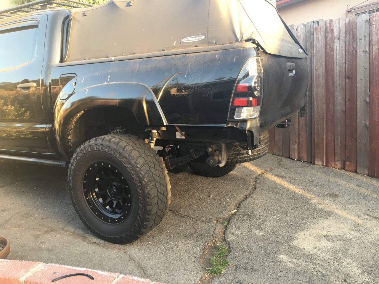

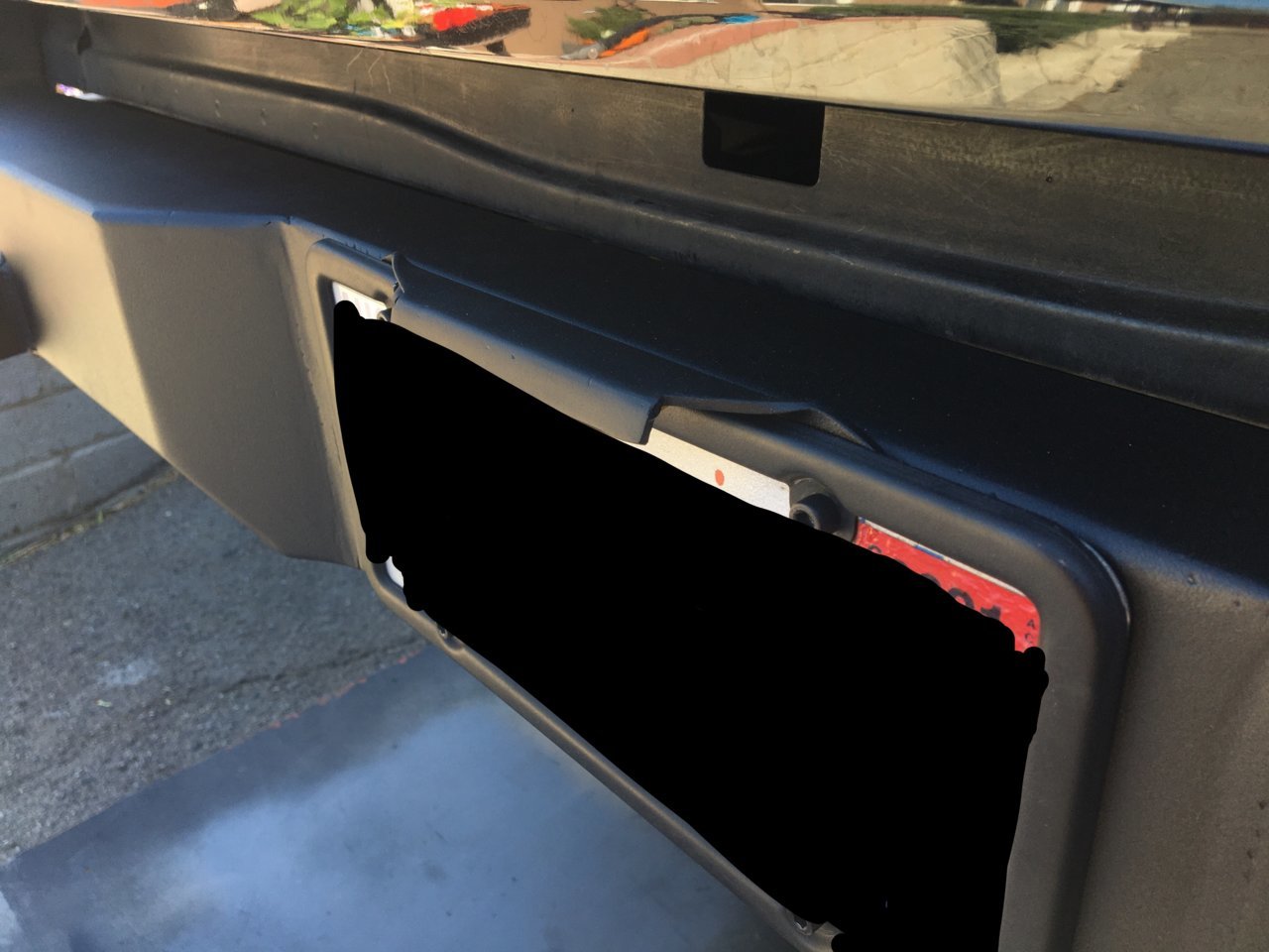

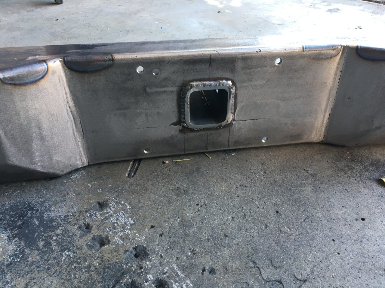

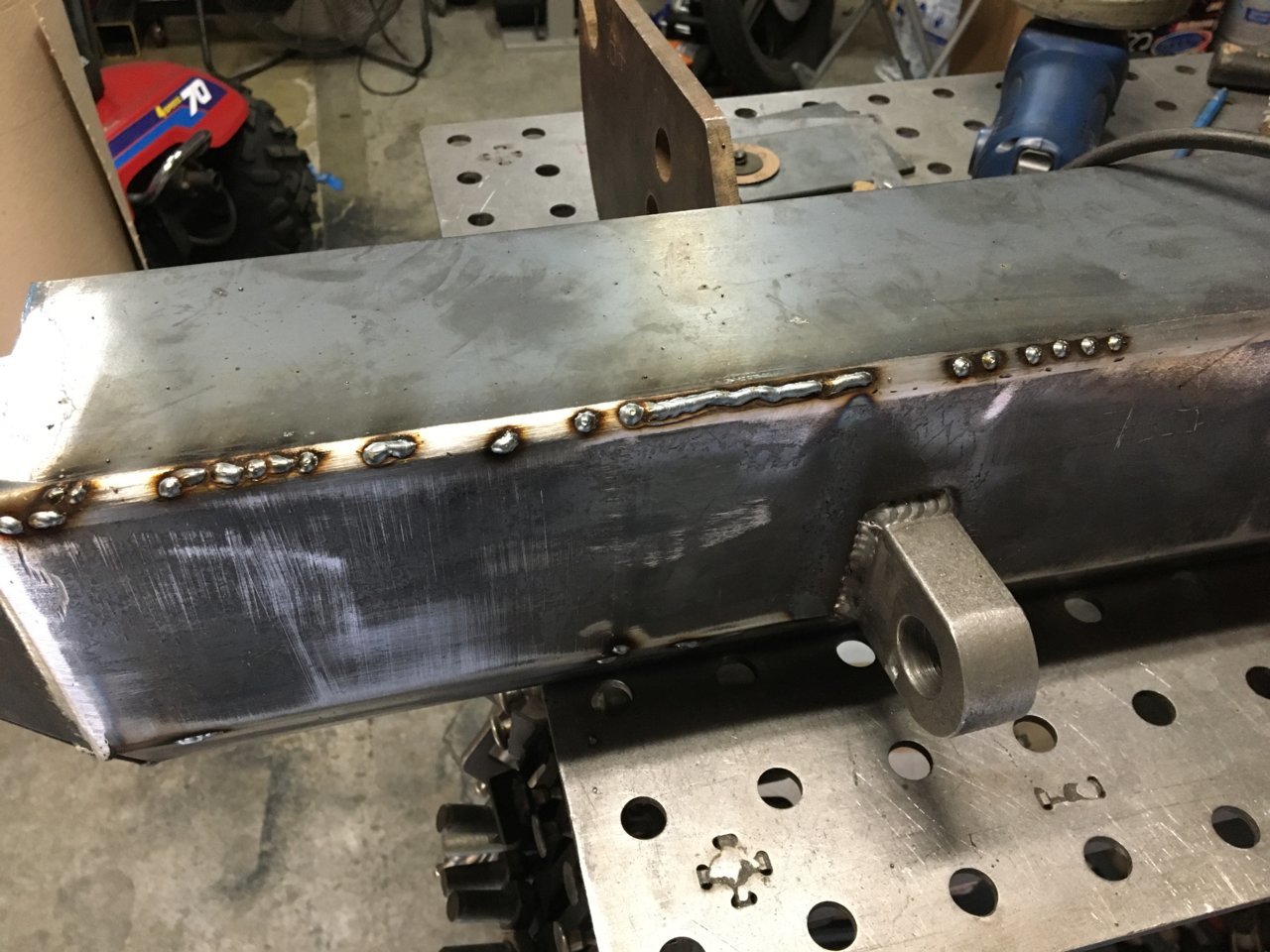

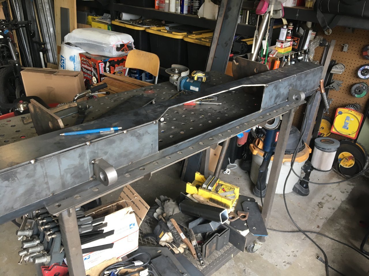

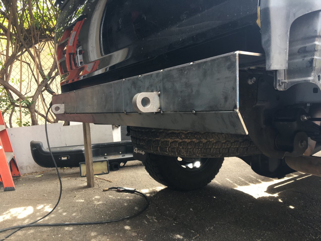

    Bumper is back from powder. Here’s some in progress pics and the finished install. Before anyone asks, I’m not building this as a production bumper. It’s something I wanted for myself that nobody really offered- a hybrid rear bumper that matches my hybrid front. Special shout to @WarFab Armor and @JLee for their help and inspiration.
    here’s where I started. Bolted up the frame plates and got the general profile that I wanted for the bumper. Skinned it with 3/16” plate and cut out the openings for the pass through recovery points.
    After some measuring, I cut back the recess for the license plate.

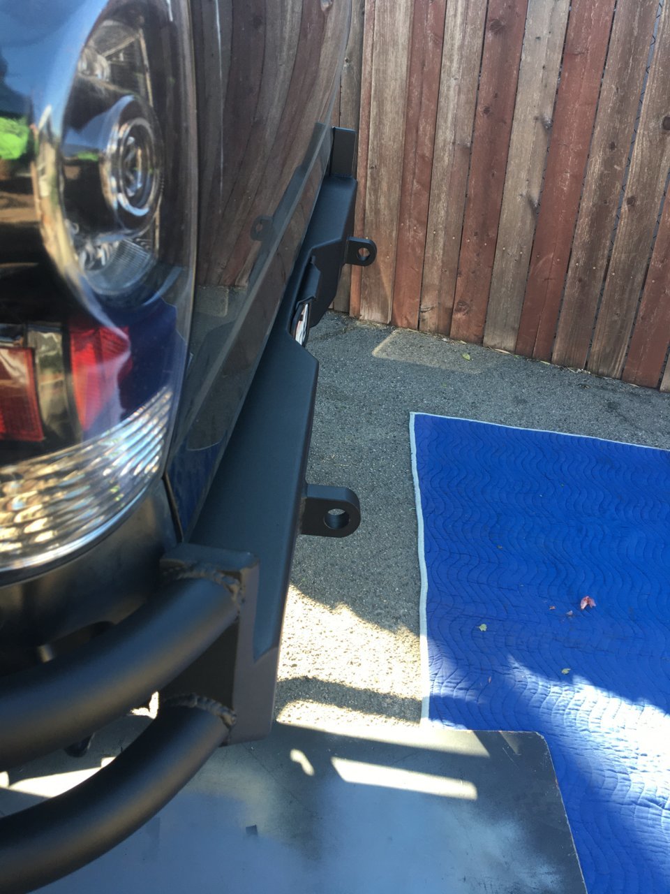

    Here’s a shot from the rear of the recovery points. Welded them to the frame plates and on both sides of the bumper skin. Some of these areas had to be fully welded as I was building because once the bumper was put together they’d be covered and harder to get to comfortably.
    I finish welded the seams, moving around the bumper as I went to mitigate warping. Once I started to smooth everything out I noticed divots where I didn’t build up the weld puddle enough to blend the radius.
    No problem. A little more weld in those area to fill them in and more time with a flap wheel and sander and we get a smooth finish.
    A8FCCCC3-1273-4907-8E3E-78601274EC36.jpg 8EFAB80E-A925-422D-9D98-22DB84BC528F.jpg

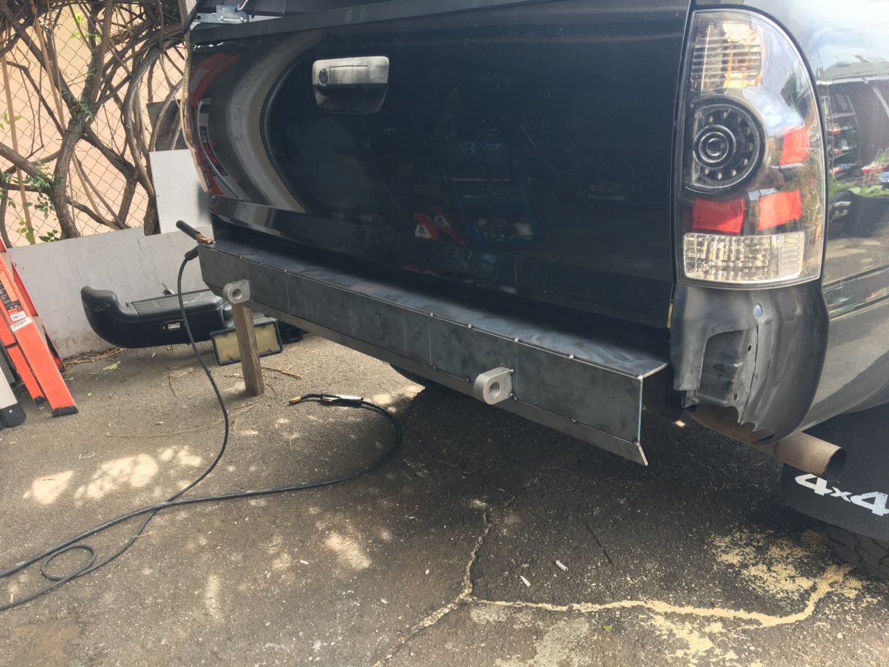

    Test fitting the bumper I didn’t like how boxy the lower corners looked so I made some adjustments.
    Cut my bedsides. No turning back now. One thing I found interesting was that the body line just below the taillight isn’t parallel to the bed rails. It has a slight downward slope as it goes forward so my OCD had to make a decision to follow the body line or follow the bed rails. Either way one of the two lines would appear off. It was just a matter of which one bothered me more. Spoiler alert: following the bed rails made for a better look since the wings of the bumper looked stupid sloping downward- it looked like the bumper was installed out of alignment and didn’t look intentional.
    #measure four times, cut twice.

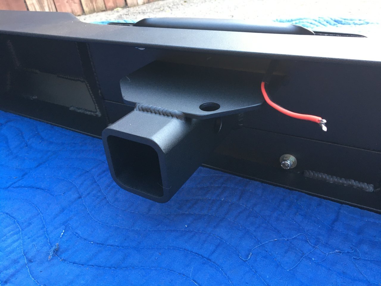

    Hidden hitch behind the license plate. I don’t tow, nor do I ever intend to. Because I built the bumper to be low profile and close to the back of the truck, I didn’t have a lot of room to reinforce it for maximum strength before I ran into interference with the stock spare tire I keep under the bed. This hitch isn’t built to tow a boat but will be used for my hitch mounted tire carrier and I reinforced it to where I feel confident that it’ll support the weight of the carrier and full sized spare tire.
    Last looks before I send it off to powder.

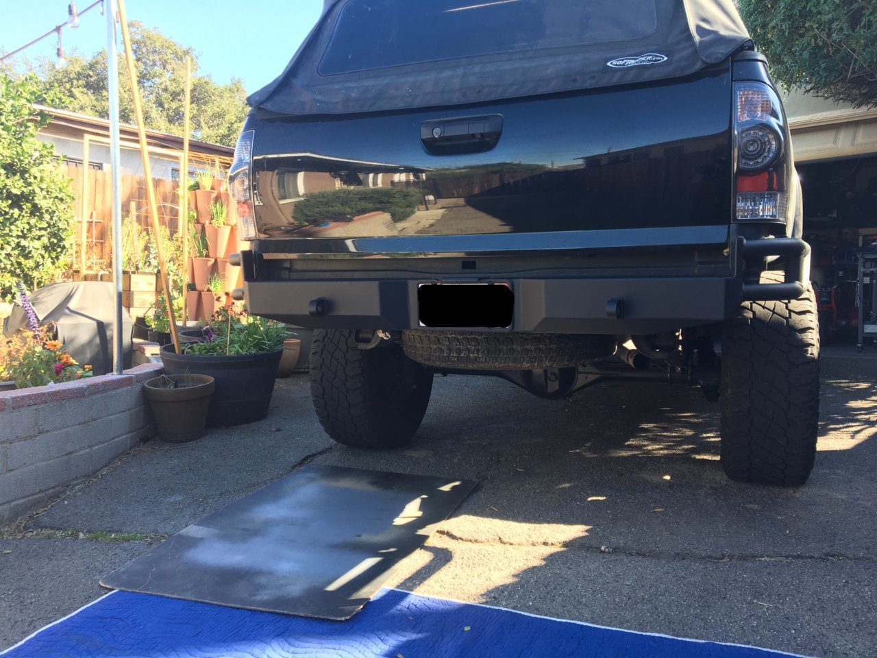

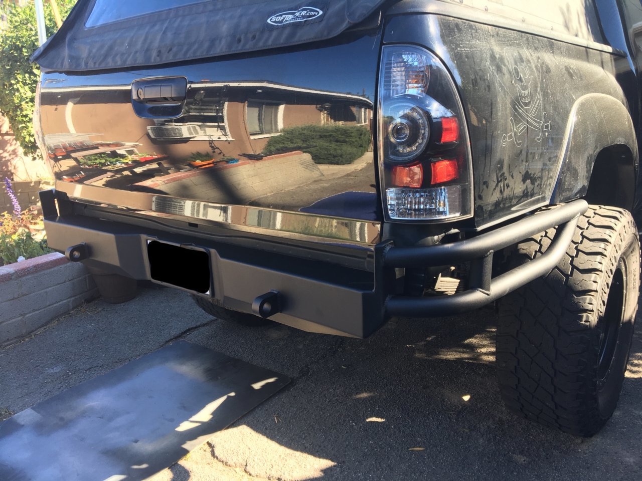

    Finally mounted. I’m super happy with the way it came out and it matches my front bumper just like I wanted. Here you can see the clear inspiration from @WarFab Armor ‘s phantom bumper which Ive always really liked. I just wanted a steel center section out back.
    2F0995DB-B81F-4B56-B986-13E071B089C0.jpg C7D0F2D5-4D25-4A8C-A1E5-33CE1EAF64FB.jpg 34EDABFC-BE0D-48C9-8862-FB6CA732C4E8.jpg

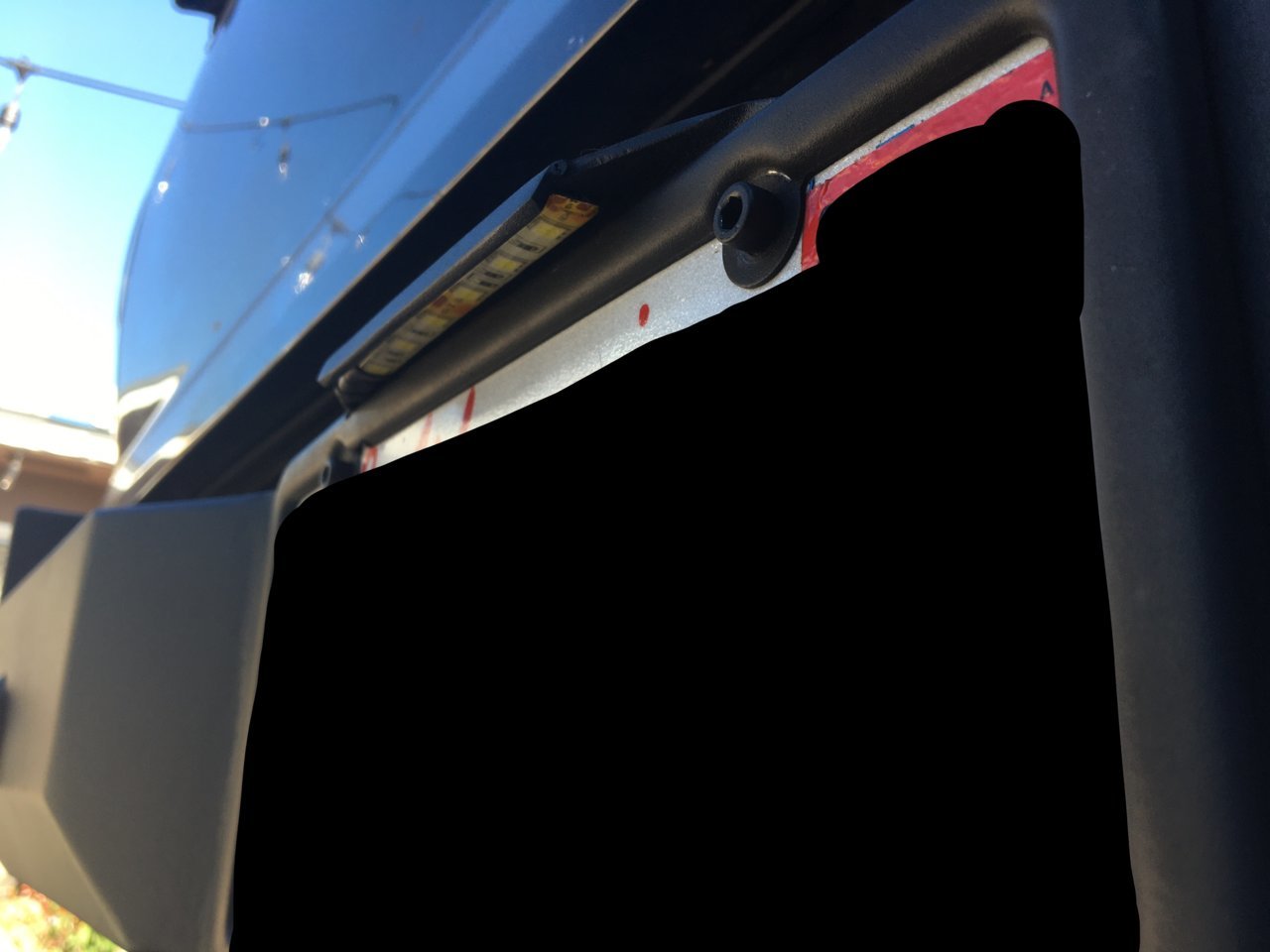

    Here’s a close up of a small detail I added. I didn’t want side shooting license plate lights so I made a small bracket for an overhead led strip that plugs into the factory light socket. I made the light myself too. Nothing fancy just a small piece of LED strip and some solder.

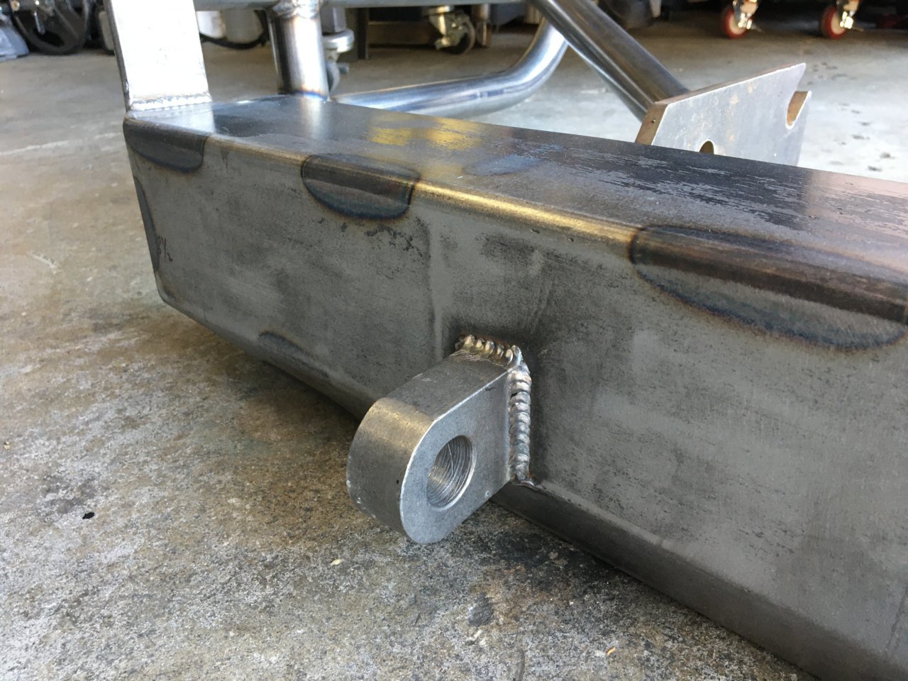

    GHOST

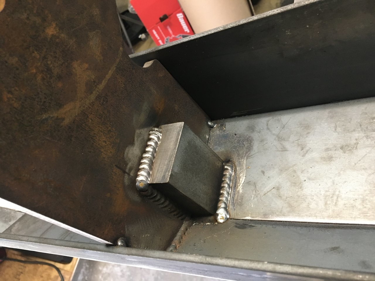

    Here’s a detail for how I reinforced the hitch. It’s just a piece of plate that acts as a spanner to spread the load out a bit. Nothing fancy and definitely not tow rated but it’ll serve my purposes just fine.
