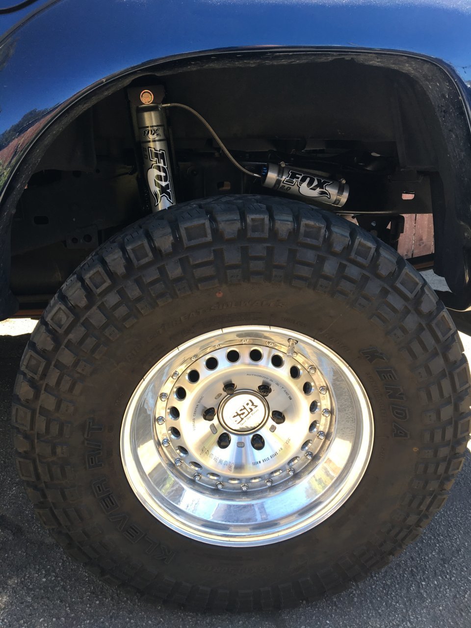

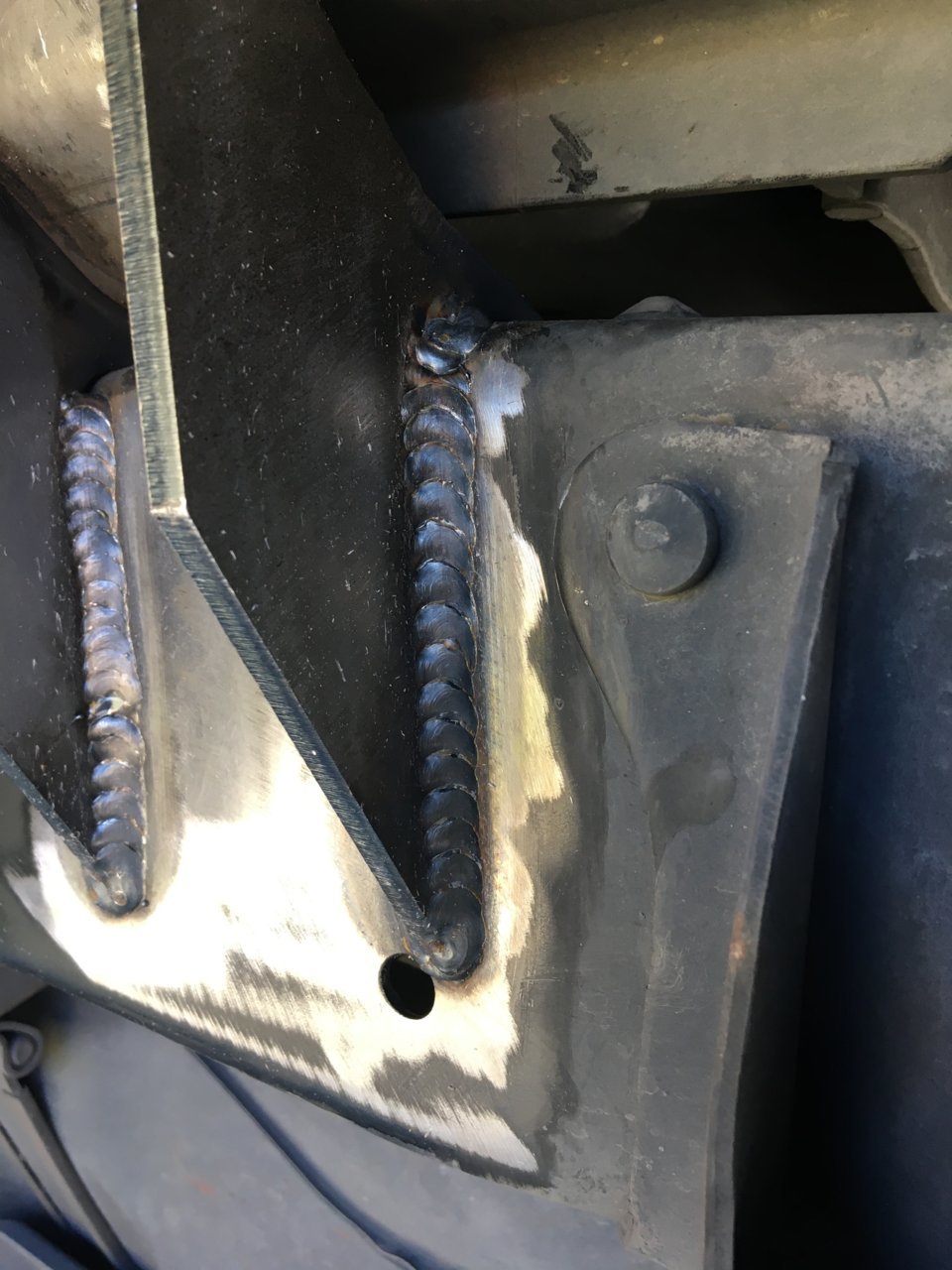

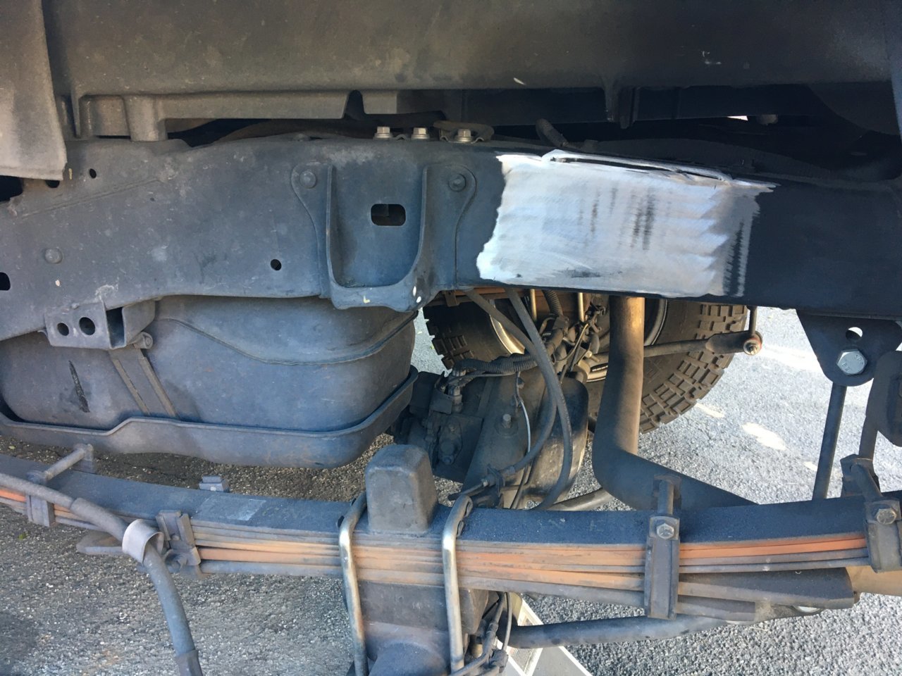

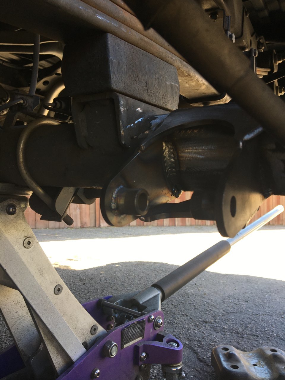

    BAMF shock relocation today on @SUMOTNK ’s clean second gen. He came down from the Bay Area and was taking a tour of SoCal members’ home shops. He had 3* cam gears installed yesterday by @greenEFSI and stopped by today on his way home. That’s dedication.
    Old mount cleaned off
    He also brought these awesome lower shock mounts from Defined Engineering. I was able to get everything mounted so he’d have 3/4” of shock left at full stuff (once he gets his new bump stops) 1FFBABBE-6B77-43E8-ADD3-D2266EF2674B.jpg
    and a glamour shot with the vintage two piece SSR wheels. I want them.0C48537E-2DE9-4C68-9A7E-A171BE118E14.jpg

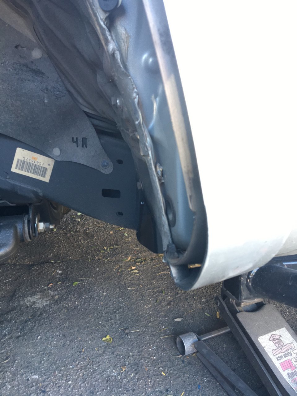

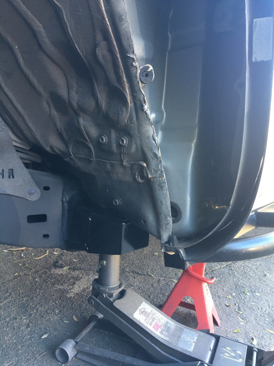

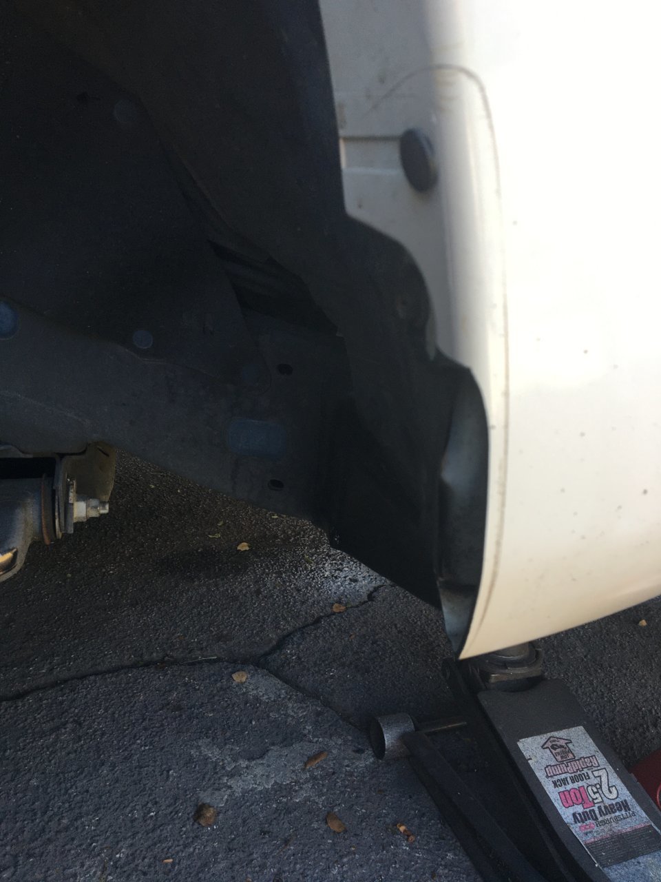

    Aggressive CMC and 2” fender trim on @TREKNTACO ’s 2ng gen today. Should have plenty of room for 35s now.

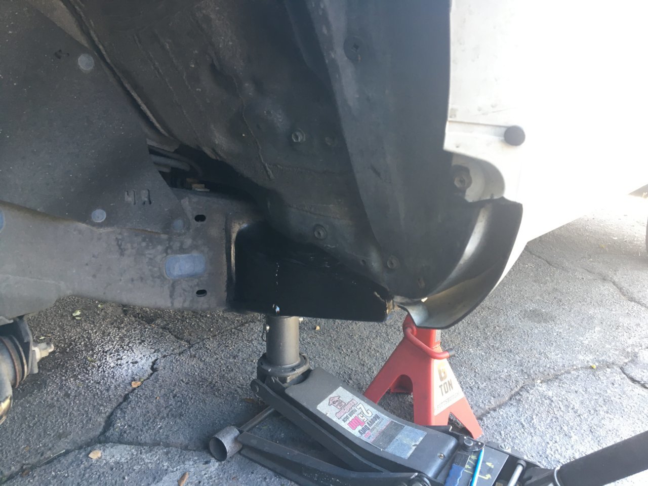

    CMC today on @taco_stat ’s clean second gen.
