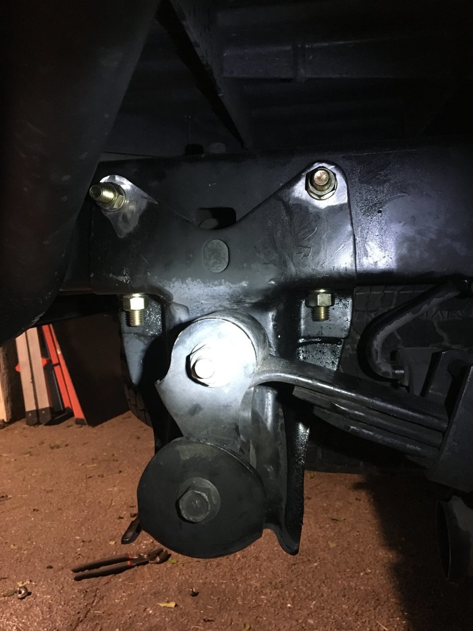

    If anyone follows local threads, there’s some big stuff going down tomorrow. In preparation for that, I converted my stock shackle hangers to bolt on. :anonymous:

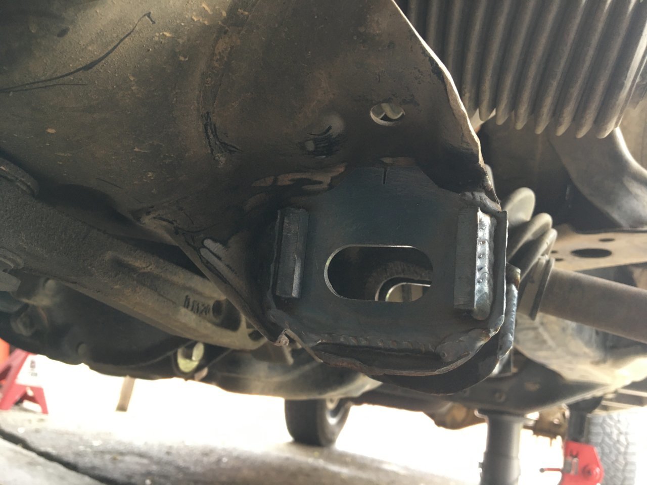

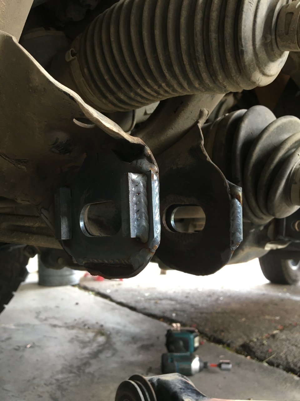

    CMC and TC cam tab gussets today on @Willyummk ’s 2nd gen.

    Yes!!! The TC cam tabs are great! I also did the weld on spindle gussets at the same I also suggest those next time you go see @GHOST SHIP

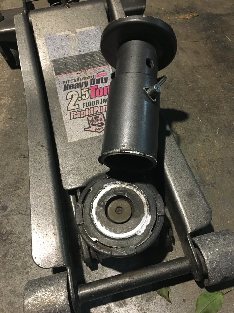

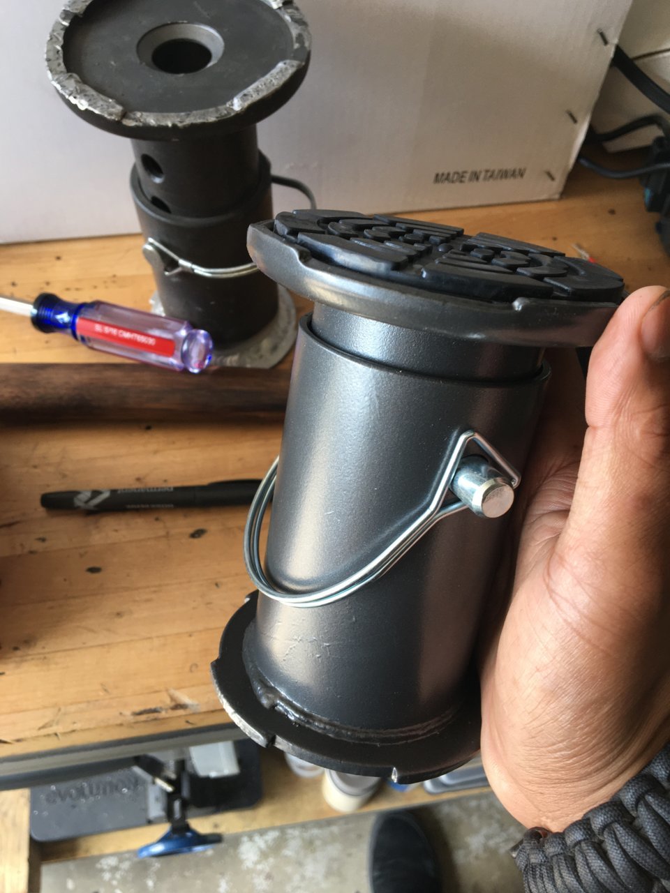

    Today’s PSA:
    Keep an eye on your ProEagle jack extension. I was working under a truck when I heard a pop. Didn’t know what it was and the truck didn’t move because I keep pressure on the floor jack even when there’s weight on the jack stands.
    Close inspection shows a lot of porosity in the aluminum which indicates a poor alloy mix and little to no prep at the weld area. I bought this extension a few years ago and it’s worked perfectly until this past week.
    I ordered a replacement from Kartek and the new version I received is made of steel. The weld still looks suspect and doesn’t appear to have full penetration but I can correct that if it ever fails.

    Need to check mine. Bought it a week after you got yours.

    Granted I probably use mine more than most people since I have several trucks in here every week, but it’s something to keep an eye on.
