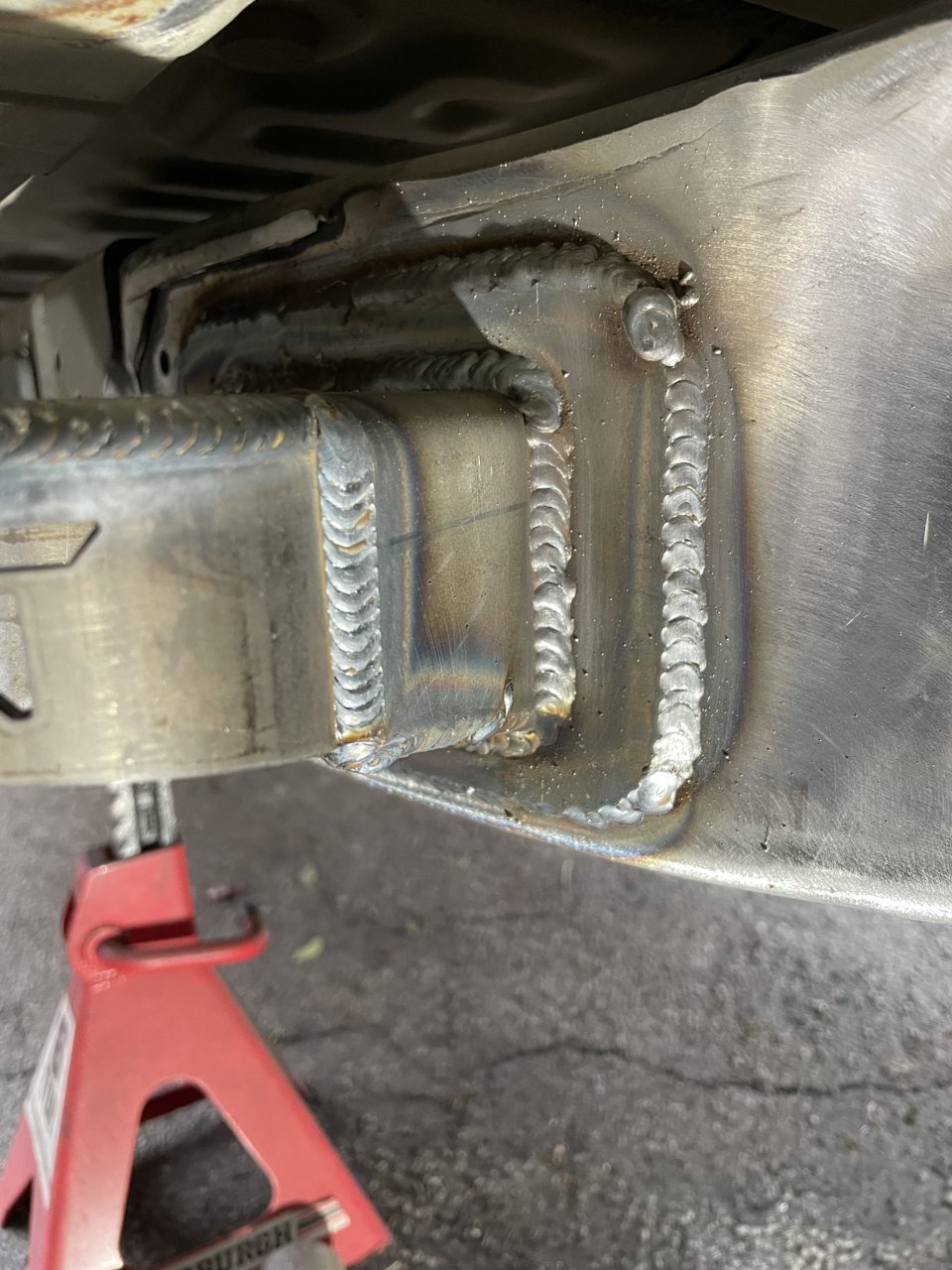

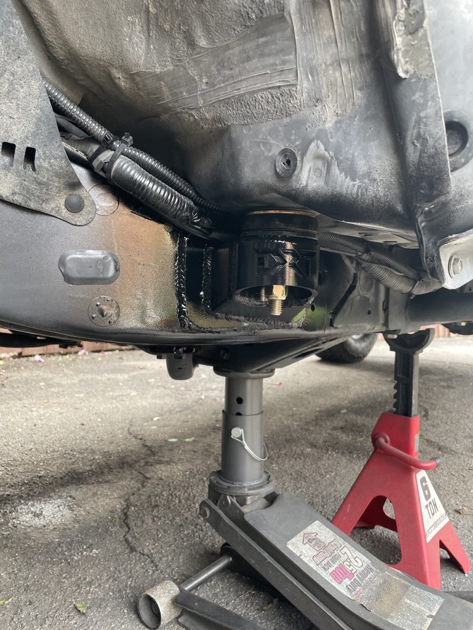

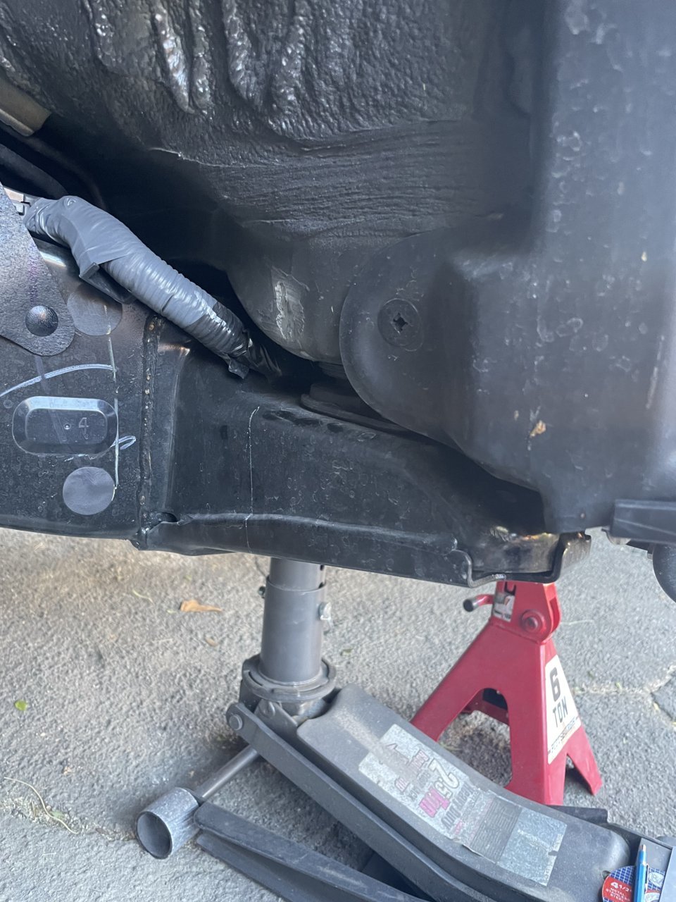

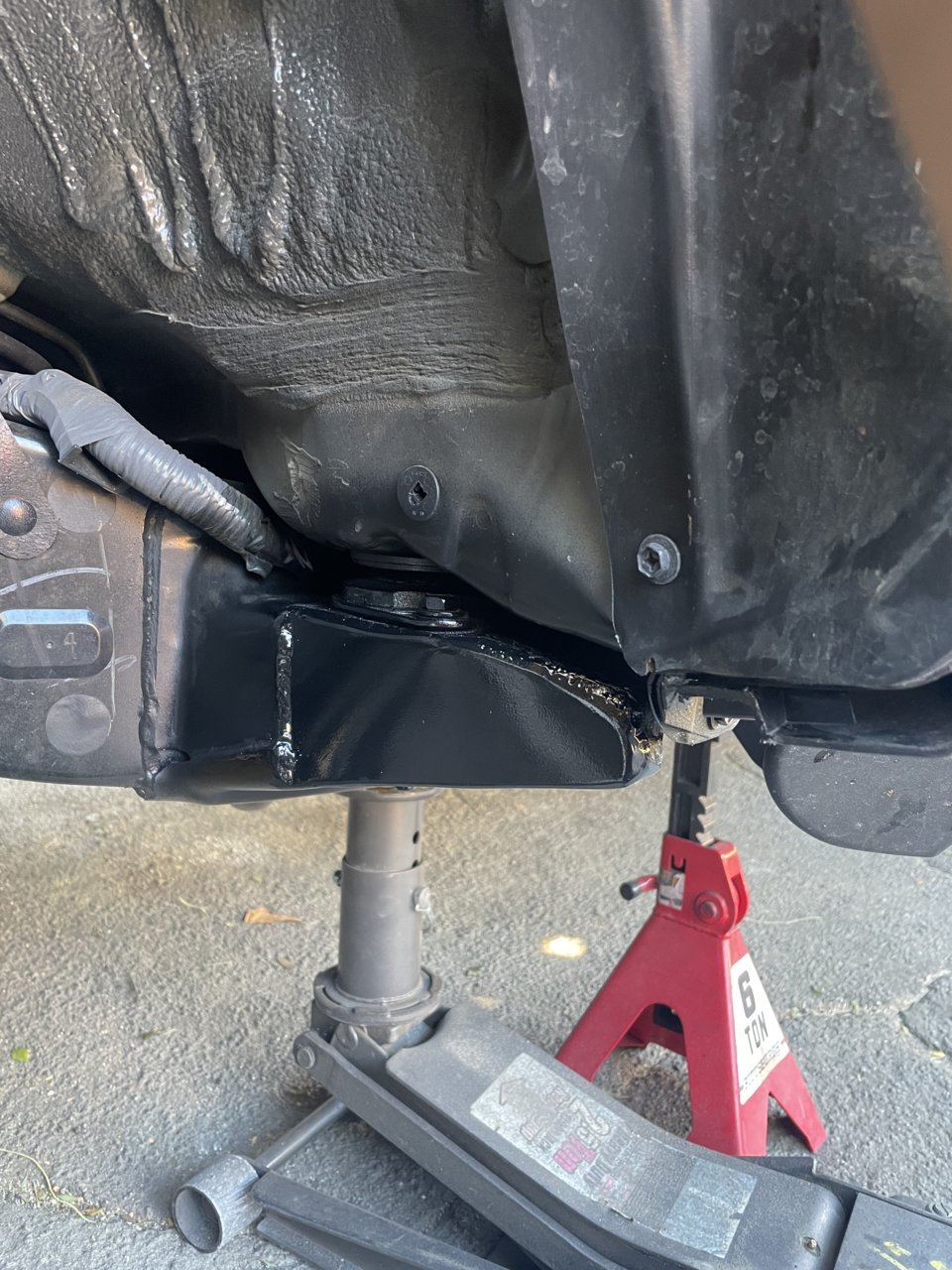

    CMC. I actually remembered to take a “before” picture this time. You can see my cut lines- this puts the face of the mount behind the firewall. The last thing protruding in the bolt for the body mount.

    That out-of-position welding tho :fistbump:

    Now you know what’s up. Haha.

    Oh just seeing you looked uncomfortable.
    Even now doing it in a controlled environment I don't like it cause mine don't look anything like I'd want them to :laughing:

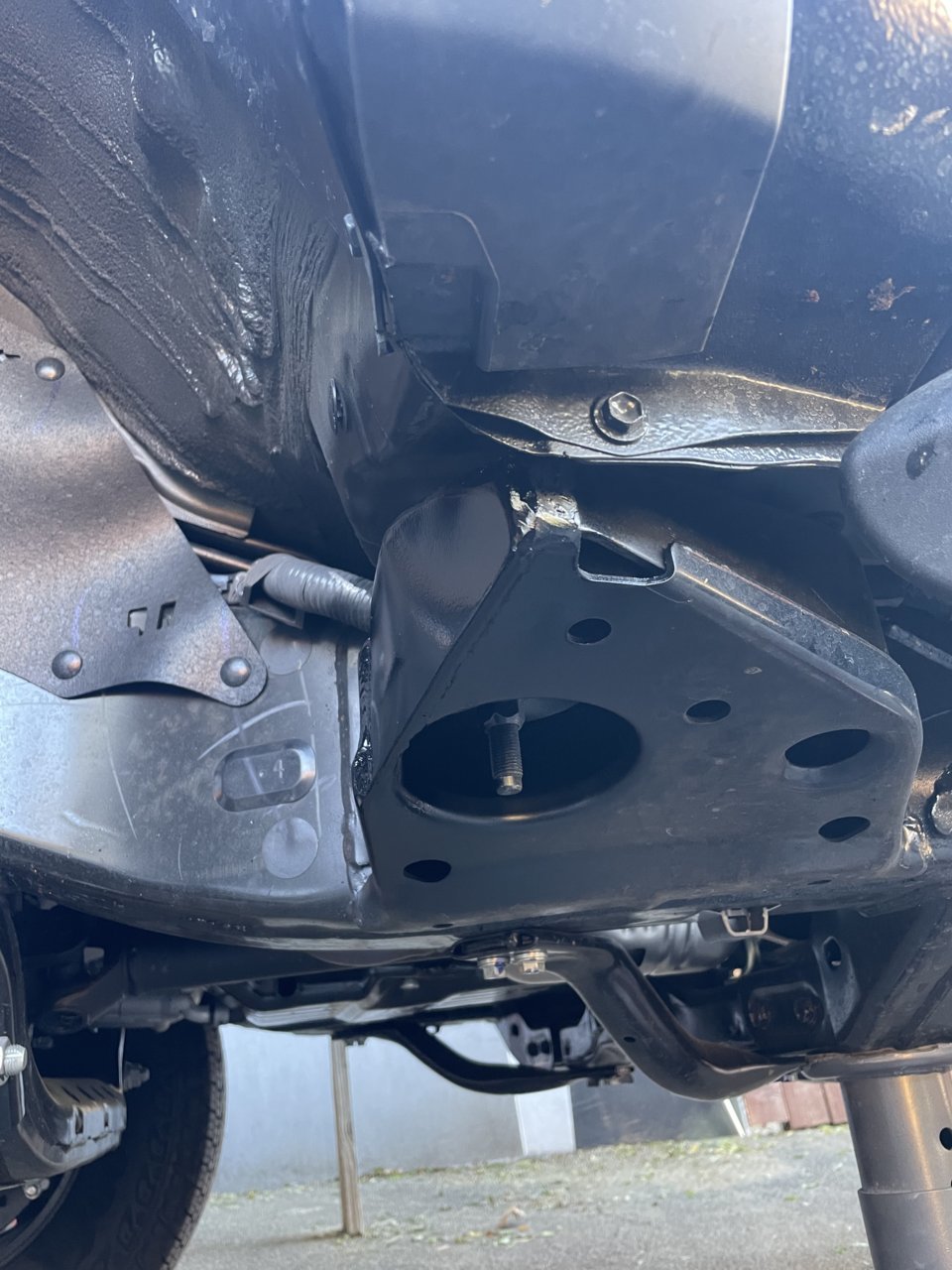

    I do and I have. I have one scheduled this coming week. I generally advise against it but if that’s what someone wants, I’ll glue it on.

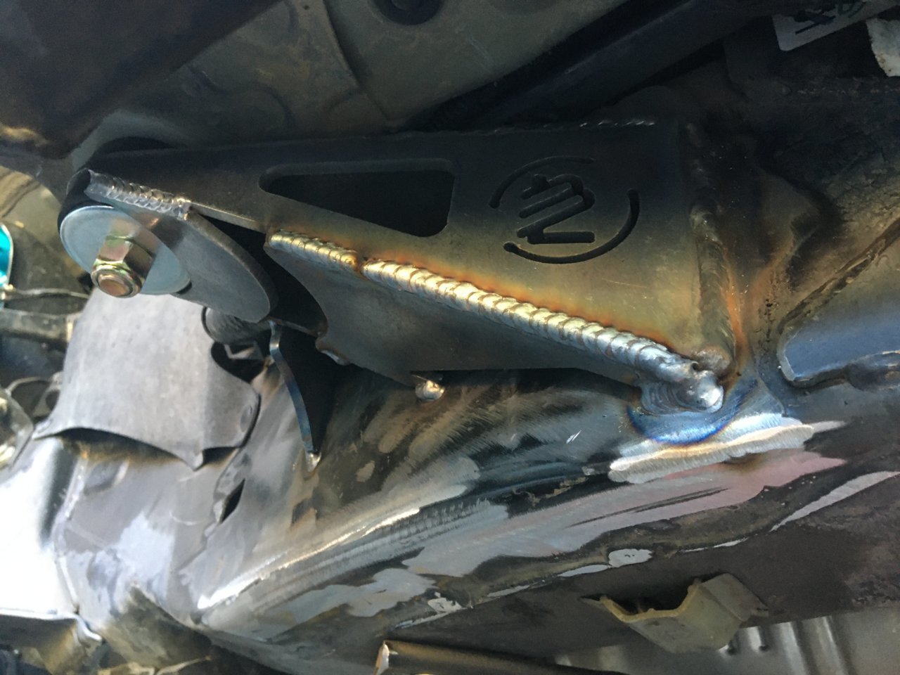

    A LilB CMR I did a while back:

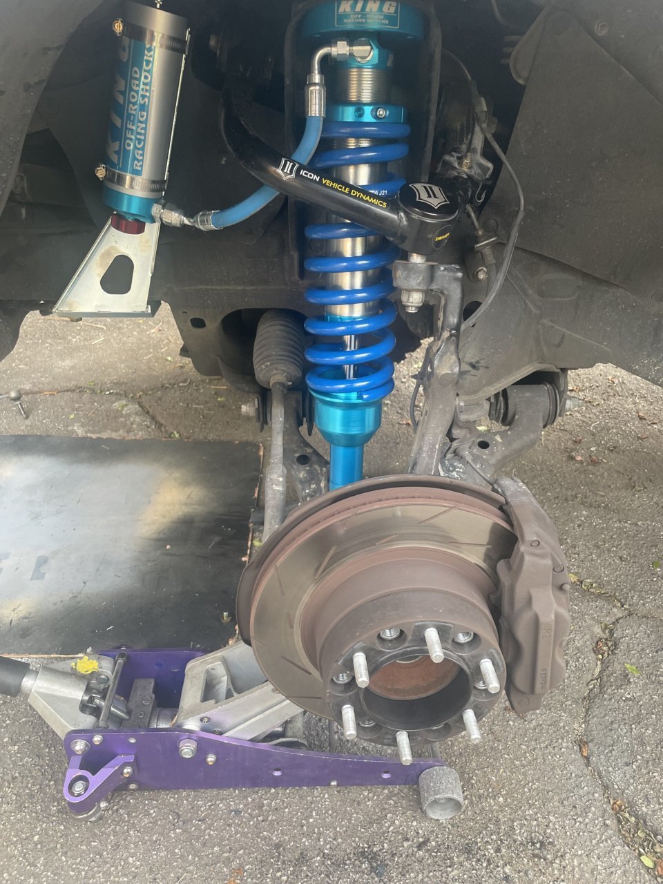

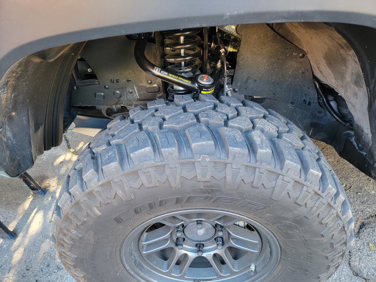

    Icon Delta UCA install today.

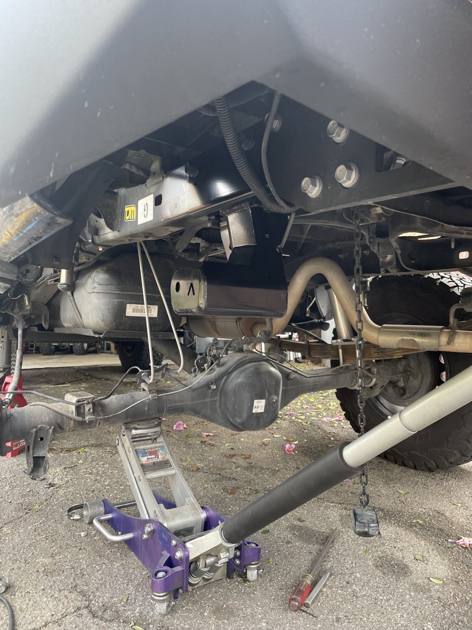

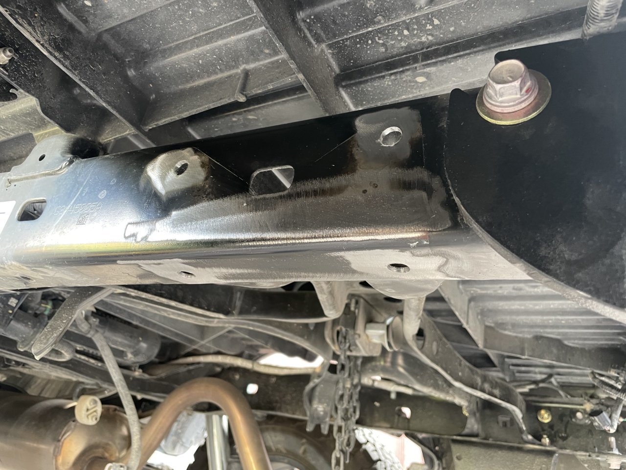

    I didn’t get an “after” picture but installed some BAMF shackle hangers on @lamjam ’s third gen above.

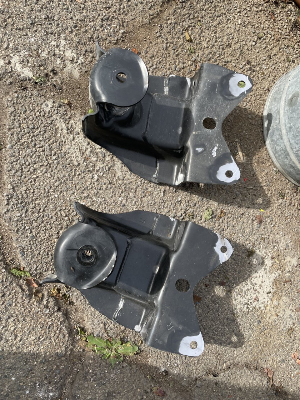

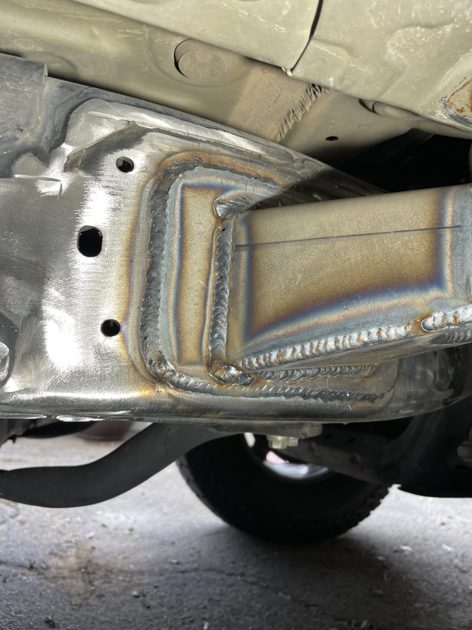

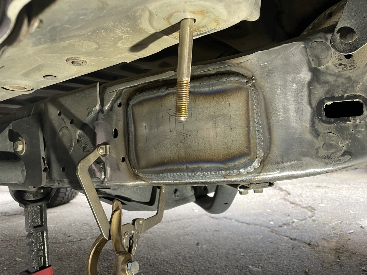

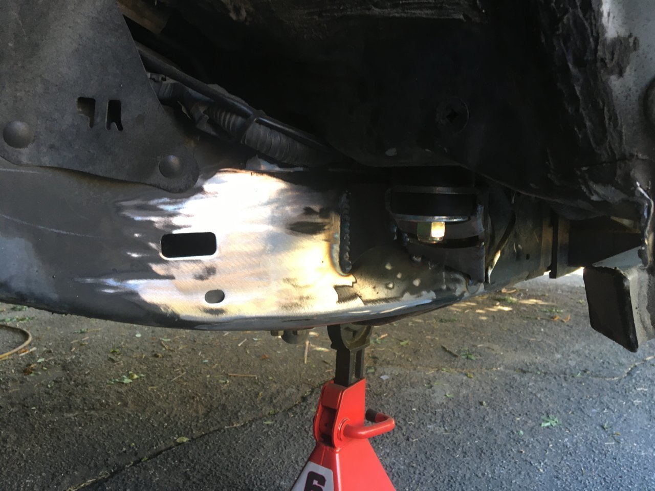

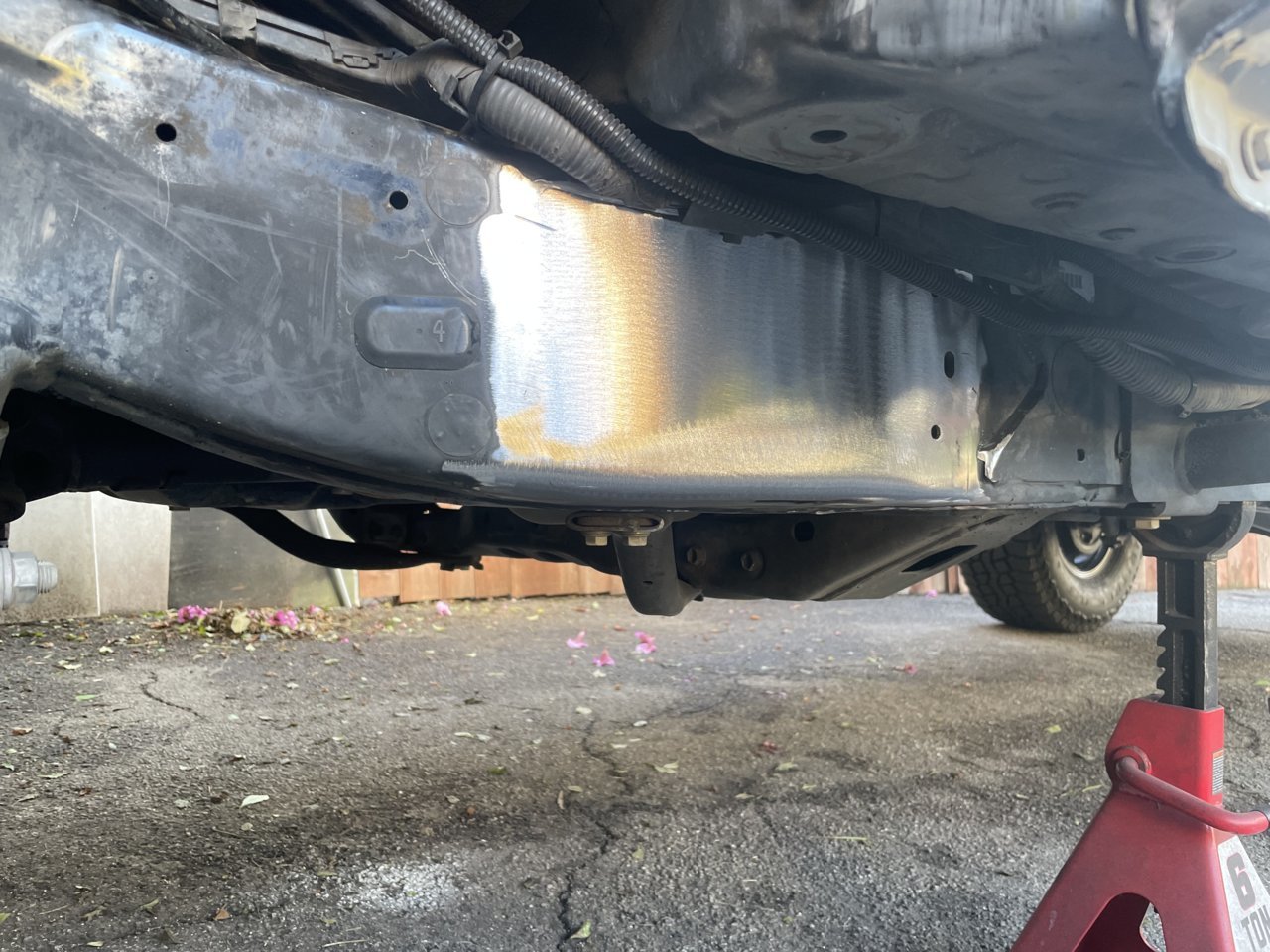

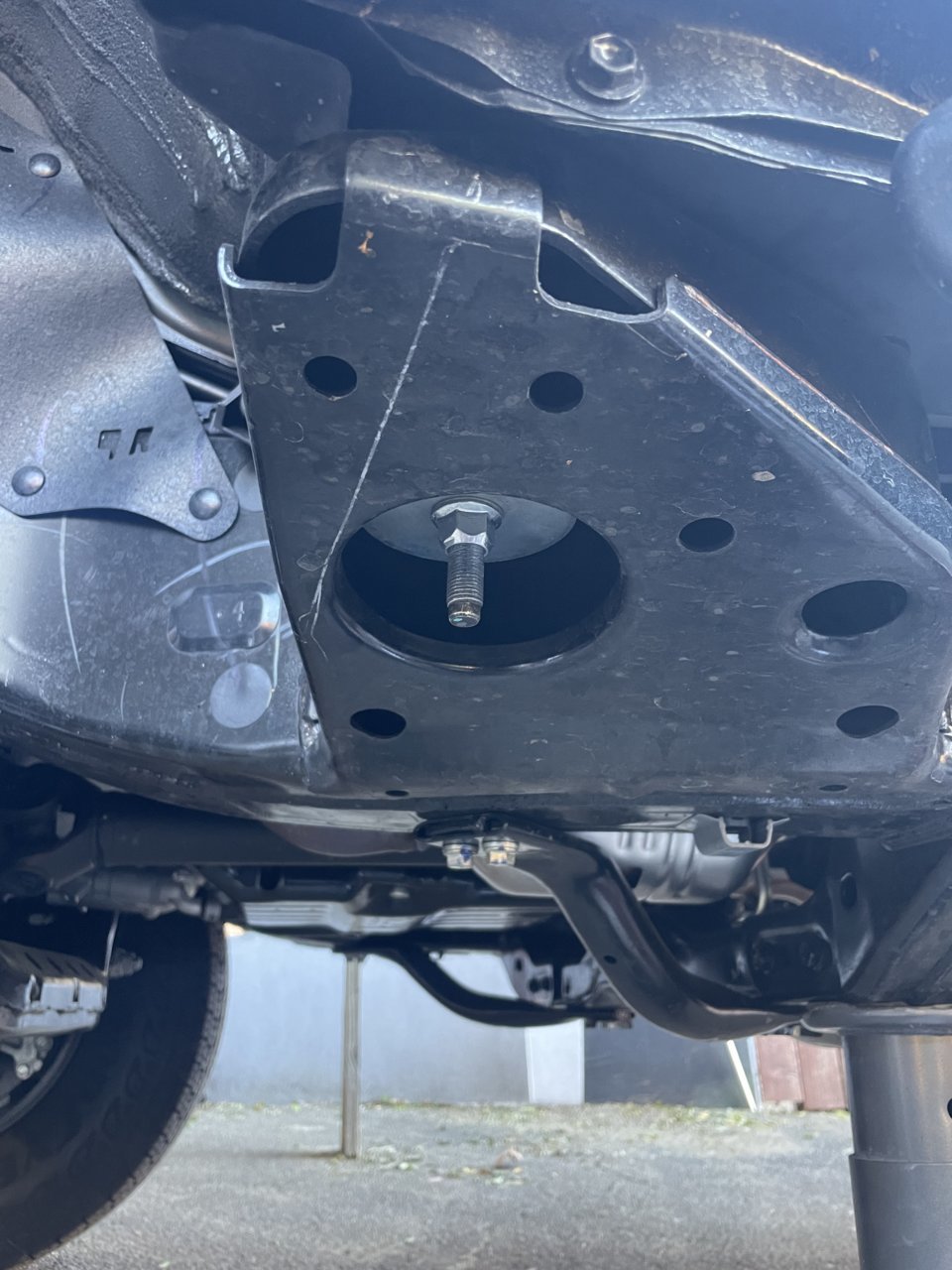

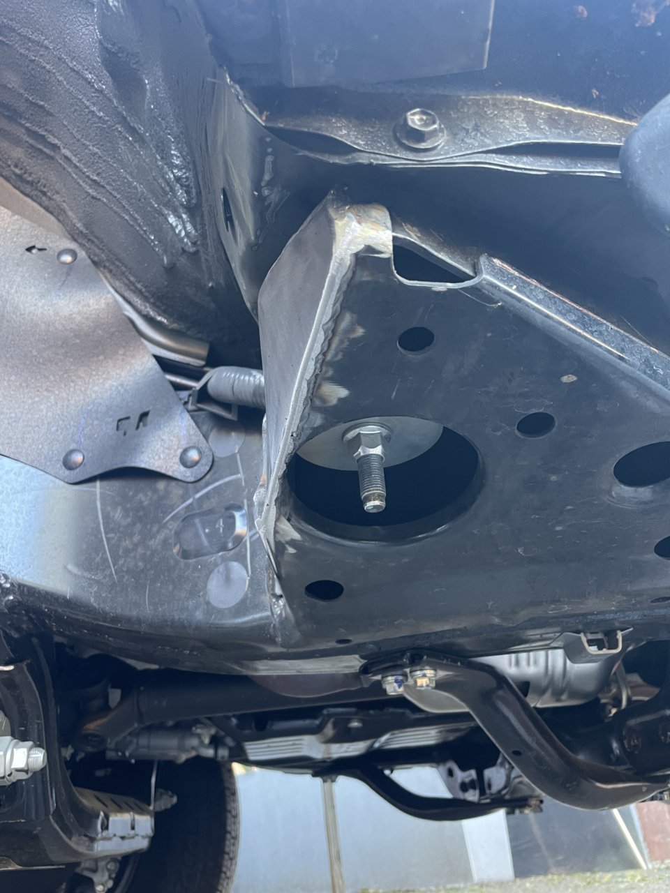

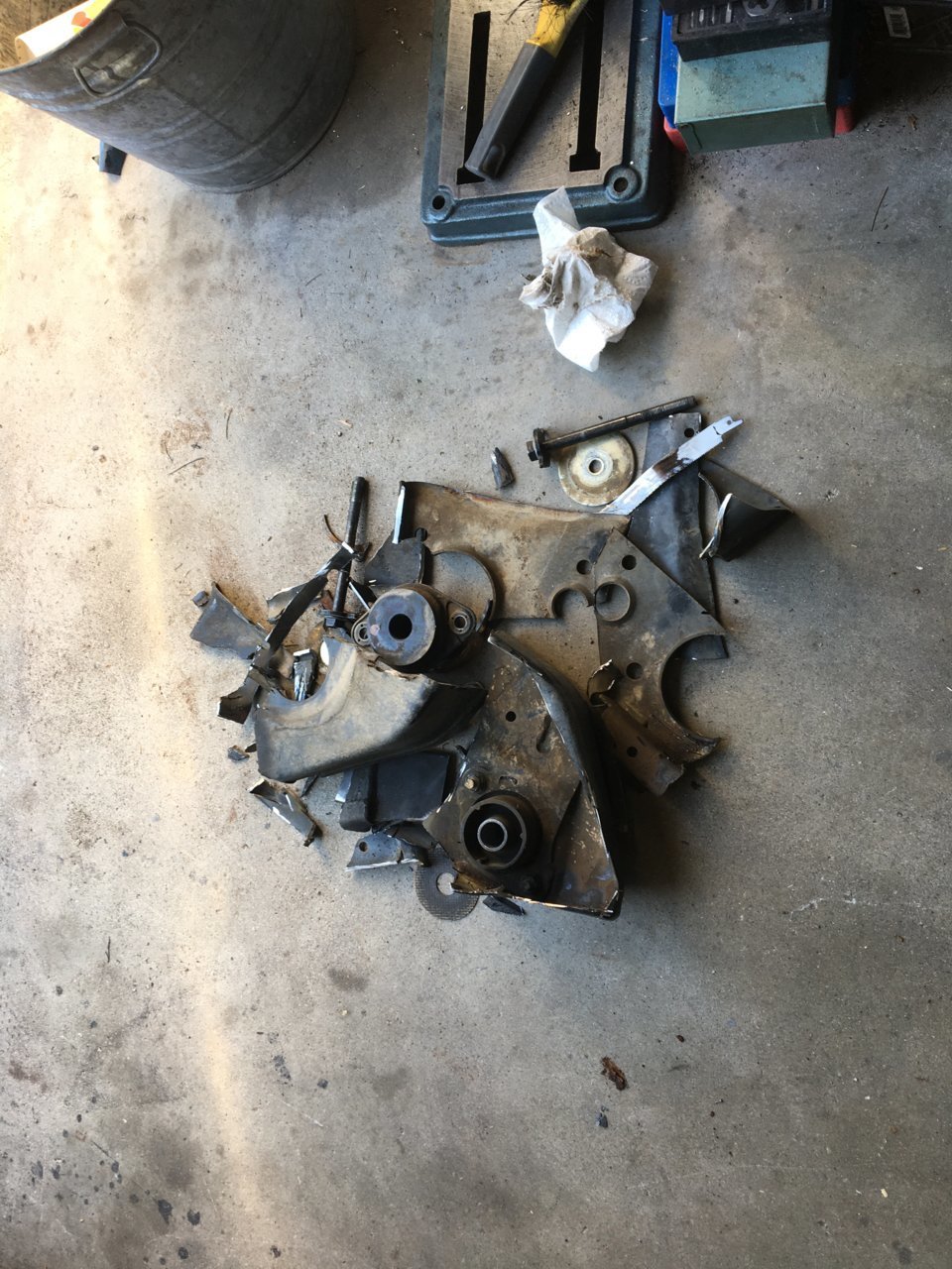

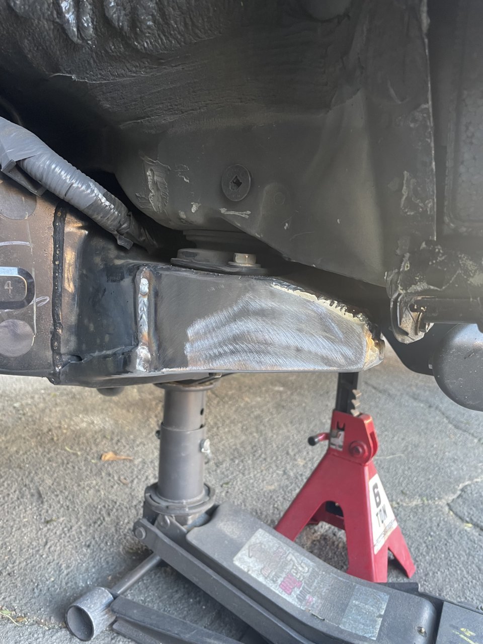

    DRT CMR today on @vitistop ’s beefy third gen. The hardest part about this job is getting down to the clean frame. Third gens have a body wiring harness just above the stock cab mount so it’s delicate work on the driver’s side. I realized I mixed up my pictures from drivers and passengers sides but you get the idea- same same.
    Also don’t forget to smash the living shit out of your trigger finger while you’re in there. Have to drain this thing now.

    Clean work as always. :bowdown:
