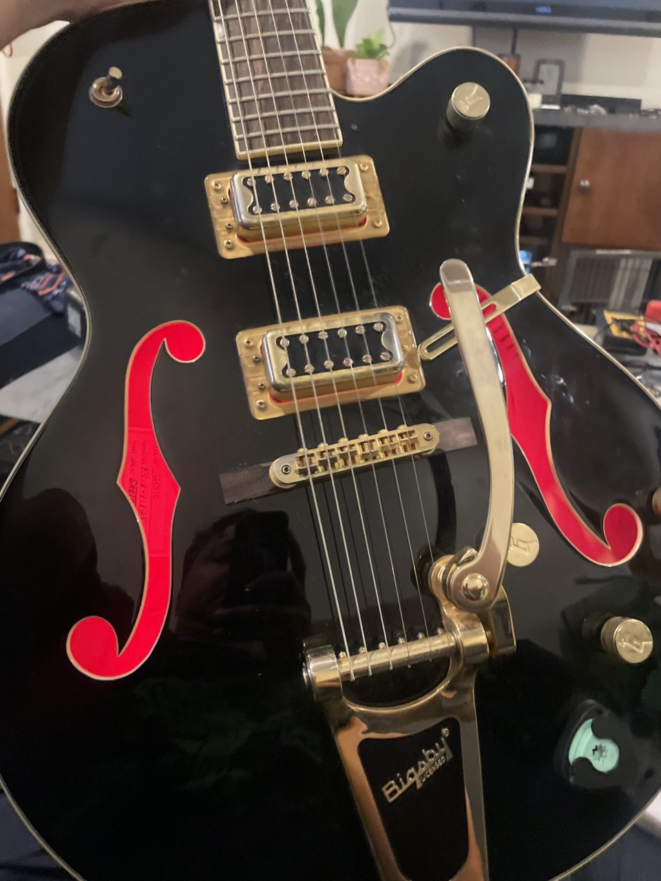

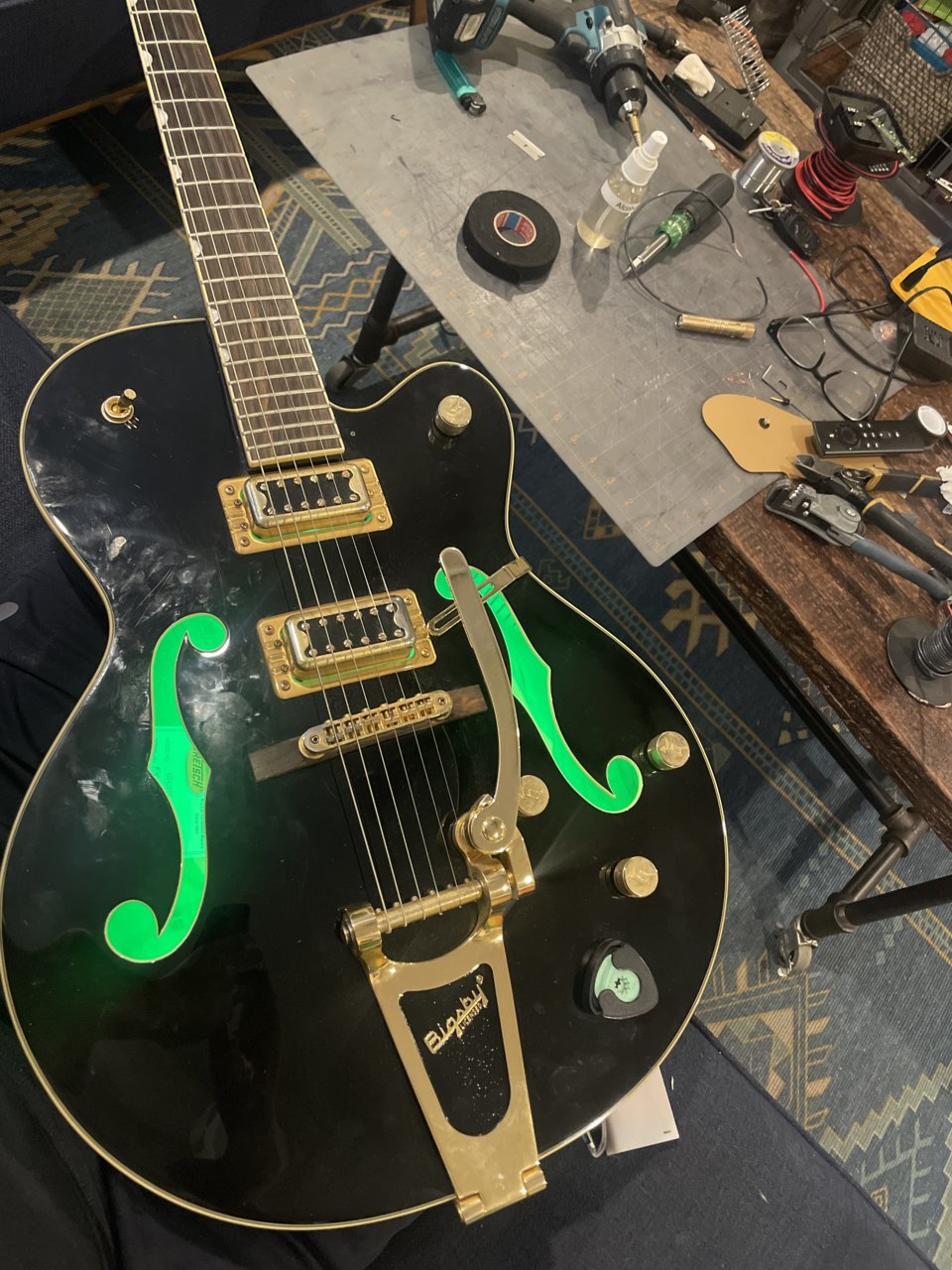

    More chingaderas today. My neighbor is in a horror punk band (Think: The Misfits) and asked if I could wire some lights for him… inside his guitar. Fuck yeah brochacho.
    They’re controlled via a wireless remote and the small external battery pack will mount to his guitar strap. Here’s the power port for the battery box. Matches the 1/4” jack for the audio cable, but is a smaller size so I was able to I keep everything small and in line with the aesthetics of the guitar.
    Should look killer on stage.

    I ran the serial number out of curiosity. It’s from 1991 so not super old, but has been taken care of for that age. He has several high end guitars but that one does tour duty.
    When he first approached me for the project I had to check in multiple times: “you sure you’re ok with me drilling a hole in your guitar?” He said he trusted my work and gave me complete freedom to do what was necessary.

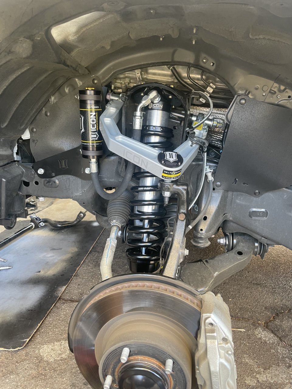

    Icon install on a Tundra today. Pretty much yhe same process as a Tacoma but everything is bigger (and heavier).
    same truck has the Air Lift bags in the rear for towing and I also installed the air lift compressor kit under the hood.

    It’s actually not that bad. I prefer this style to the Tacoma in terms of difficulty. The key to reinstalling sway bars is to have both sides either on the ground or equally drooped. That way you aren’t fighting the sway bar and trying to twist it into place. Because I’m working one corner at a time on a sloped driveway with a floor jack and jack stands, I usually install that last after everything is on and both tires are back on the ground. I rarely jack both wheels off the ground at the same time.

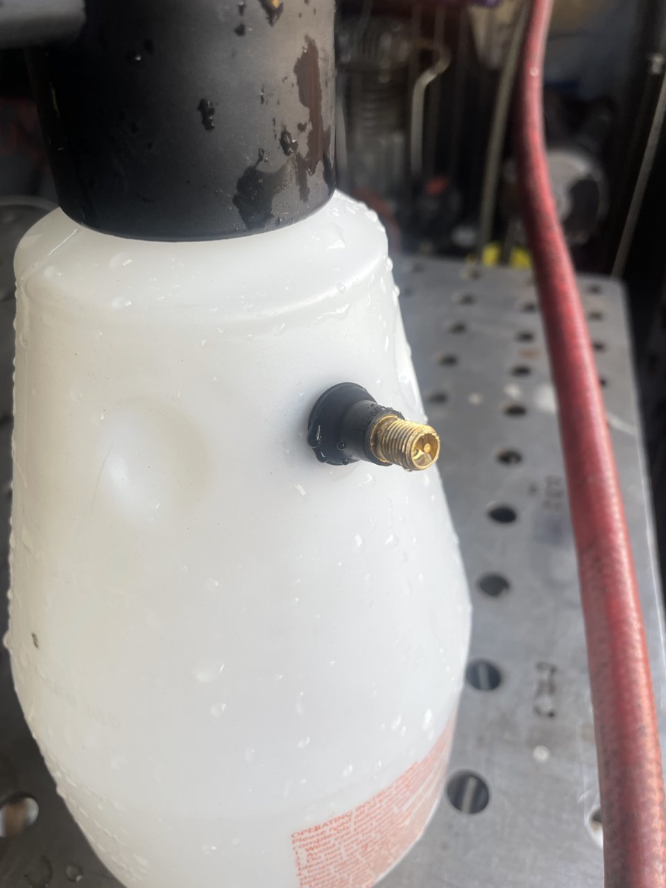

    Homeowner hack today. Got one of these pump sprayers for random stuff around the house and the garden.
    I got tired of pumping it like a chump so I drilled a hole and added a schrader valve. Now I can add pressure with my compressor and be good to go. The hand pump still works if I’m not near an air line and it also acts as a pressure relief when the work is done and you’re going to store it.
    The only caveat is that you can’t add to much pressure for the plastic housing. You’re also relying on the seals in the pump and nozzle which are just rubber o rings in a plastic seat so you can’t overfill it. I had this up to 30 psi and didn’t fear blowing out the container or seals. I’m sure a larger vessel would work better and allow for more pressure and a sustained working time before you have to add more air.

    Removed 88Rotors “modular” AAL in favor of an icon RXT pack better suited to @Mr. Excitement ’s third gen.
