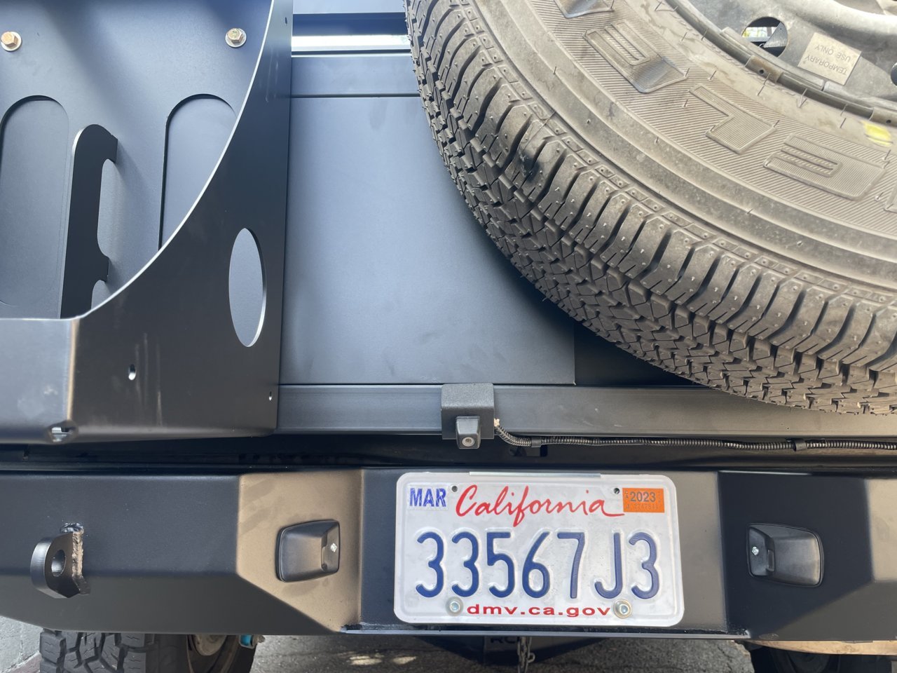

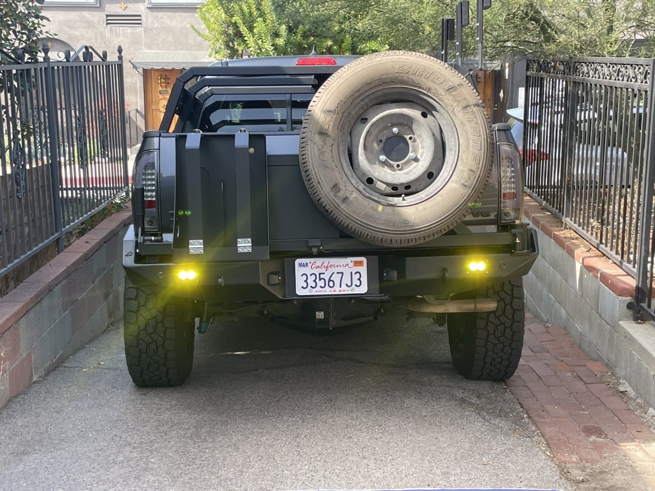

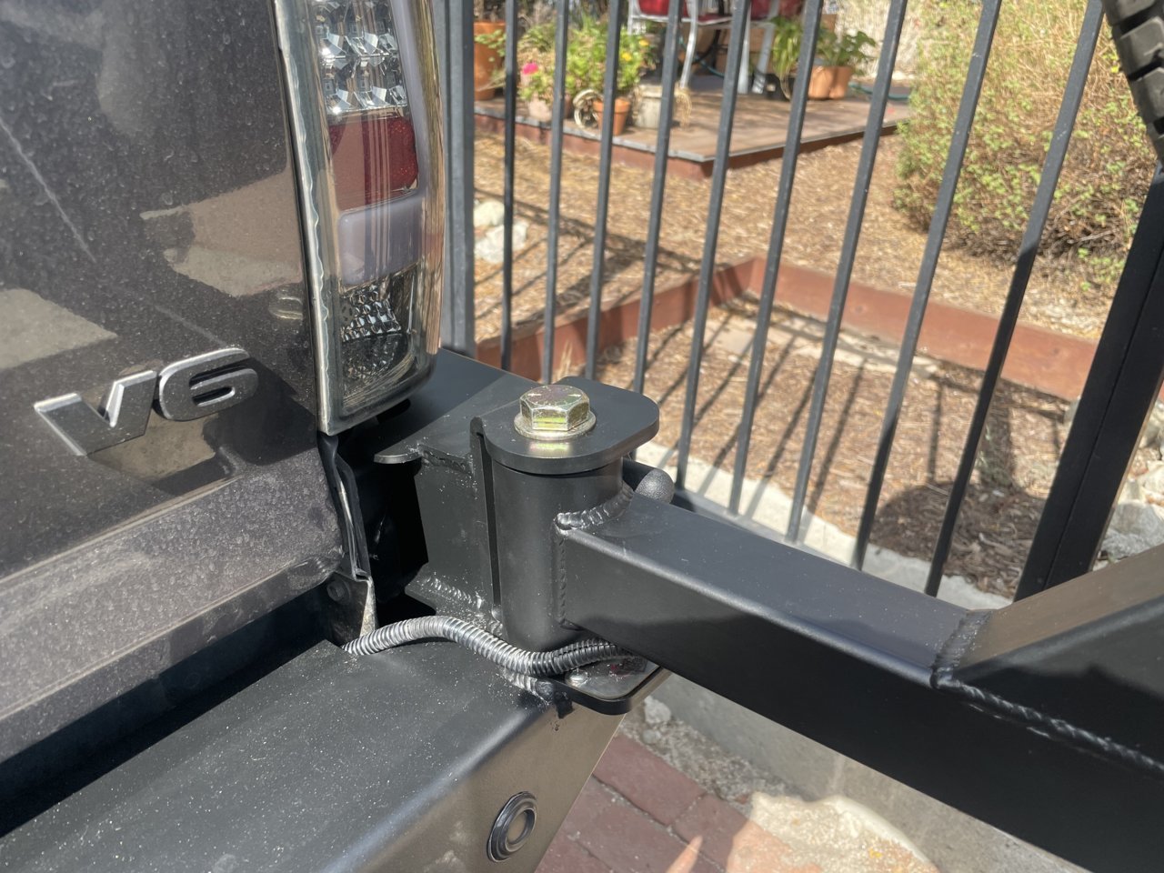

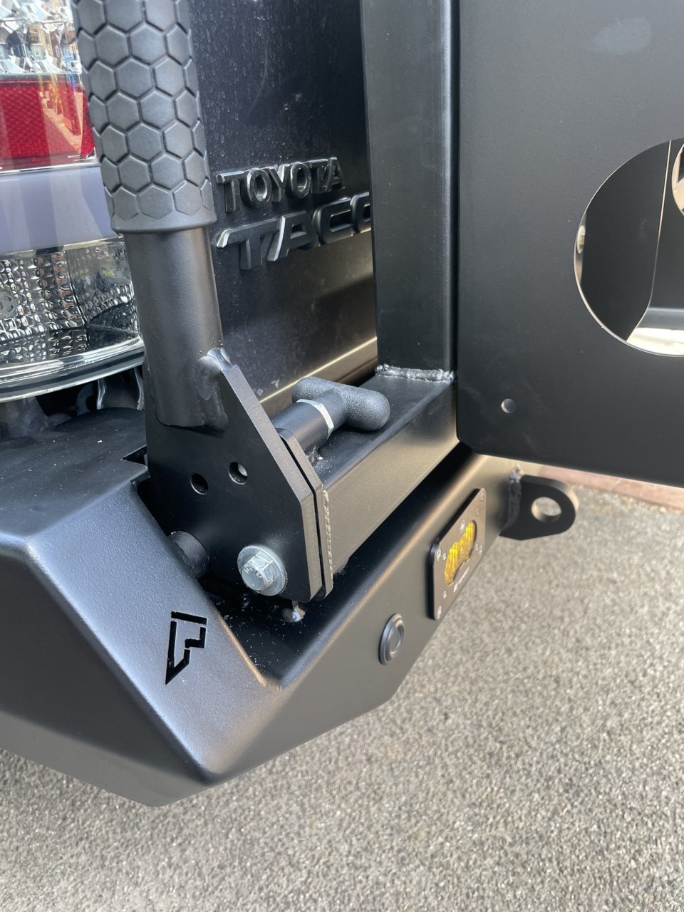

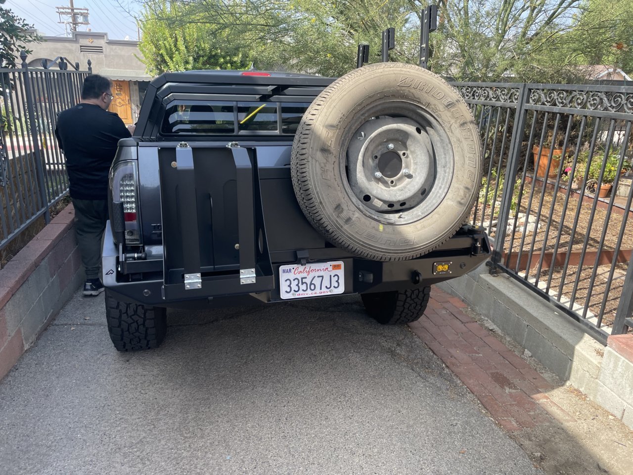

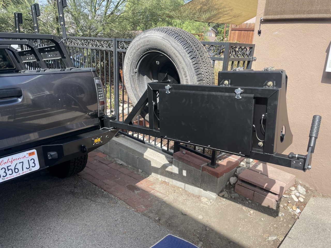

    Install day. Finally got another big project out of the shop.
    One of the last Pelfreybilt bumpers from the warehouse sale. @rangergs007 found this gem on OfferUp but it was incomplete and missing a bunch of key components to finish. (Funny enough, I had a few people message me about this same bumper before it sold but he beat everyone to the purchase.) It was bare steel and had some surface rust which is expected since it’s been sitting for so long, but the main body of the bumper was mostly complete. So with some parts from 4XInnovations, I built and added the swingout with double Jerry can holder and drop-down table on the inside. Little odds and ends finish it off like making my own camera relocate, adding provisions for backup sensors and wiring in the Baja Designs S2s for backup lights.

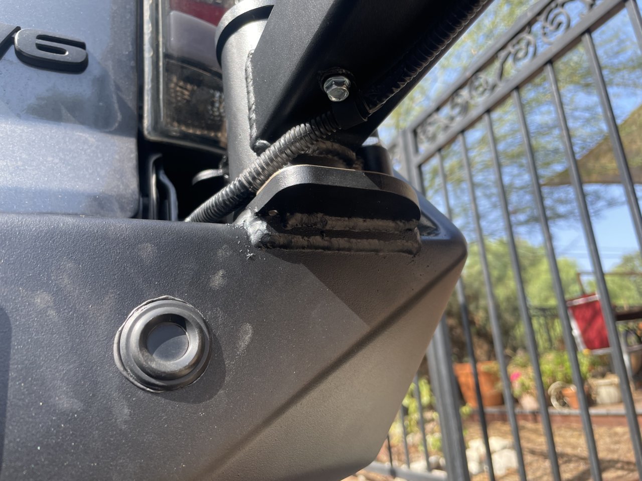

    Are you using self-tapping screws for those 1/2" (1/4"?) cable guides for the backup camera wiring? I'm using adhesive-backed ones currently, but I've been thinking about getting something more permanent.

    Some nudes of work in progress:
    Yes- Self tapping. FWIW, I’m always super cautious of drilling into completed projects so I predrilled the holes and added some permatex gasket maker before tightening the bolts. They’re under the swingout arm, but I still treat them to seal everything up. If you look at your local hardware store for self tapping screws used in metal siding or roofing applications, they have some that come painted and have a washer with a foam gasket attached for an added seal. I use those often enough and haven’t had an issue with leaks.

    I was hesitant about doing it for precisely that reason. Thanks for the advice!

    The stick on zip tie tabs have their place, but it think there is always a different way to do things depending on application. It’s always good to have options. Had I thought about it before sending the bumper to powdercoating, I would’ve added weld-on zip tie tabs.

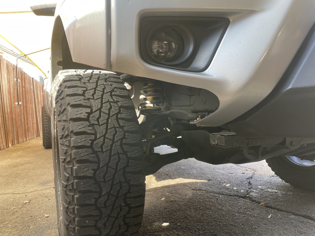

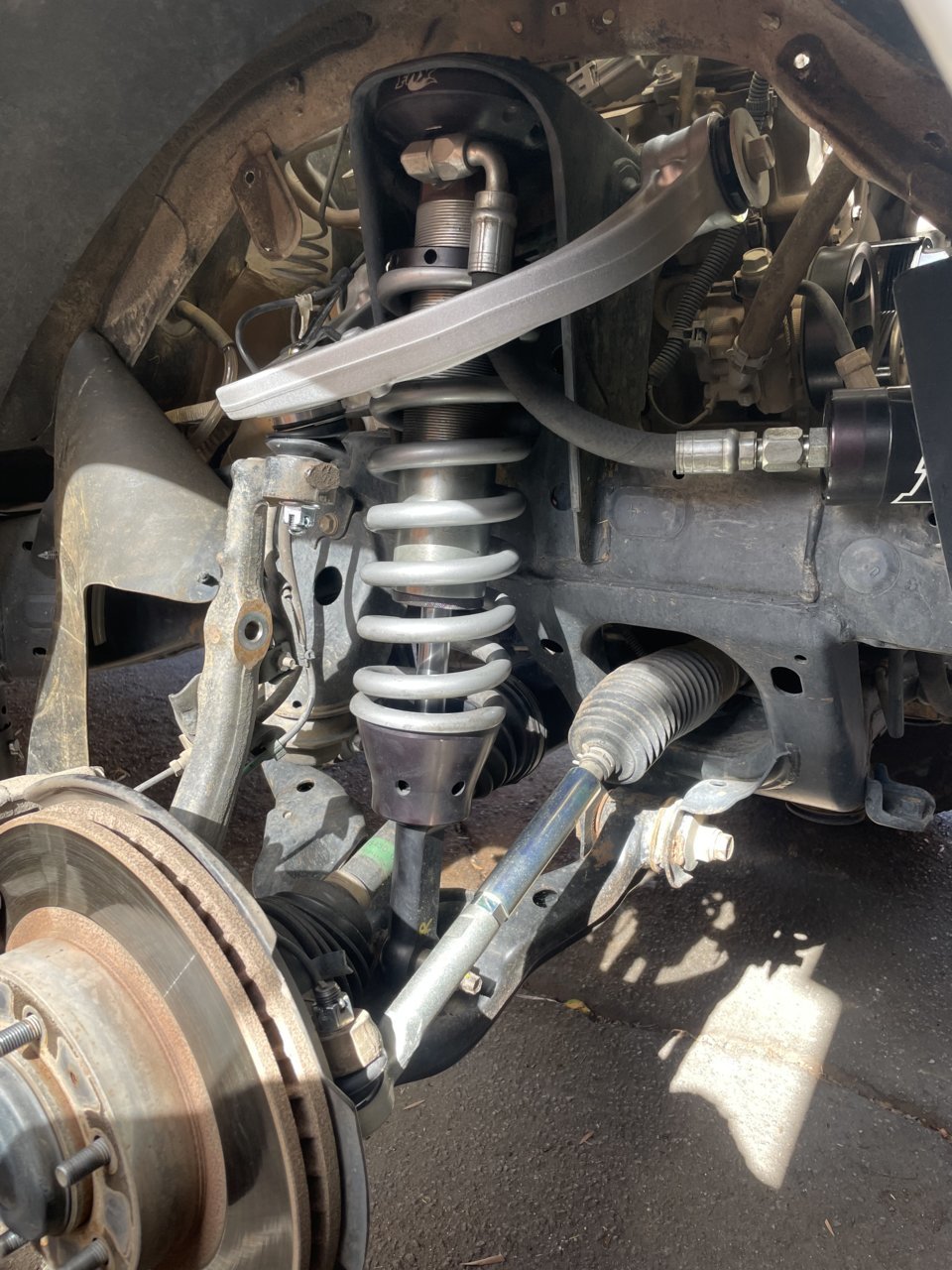

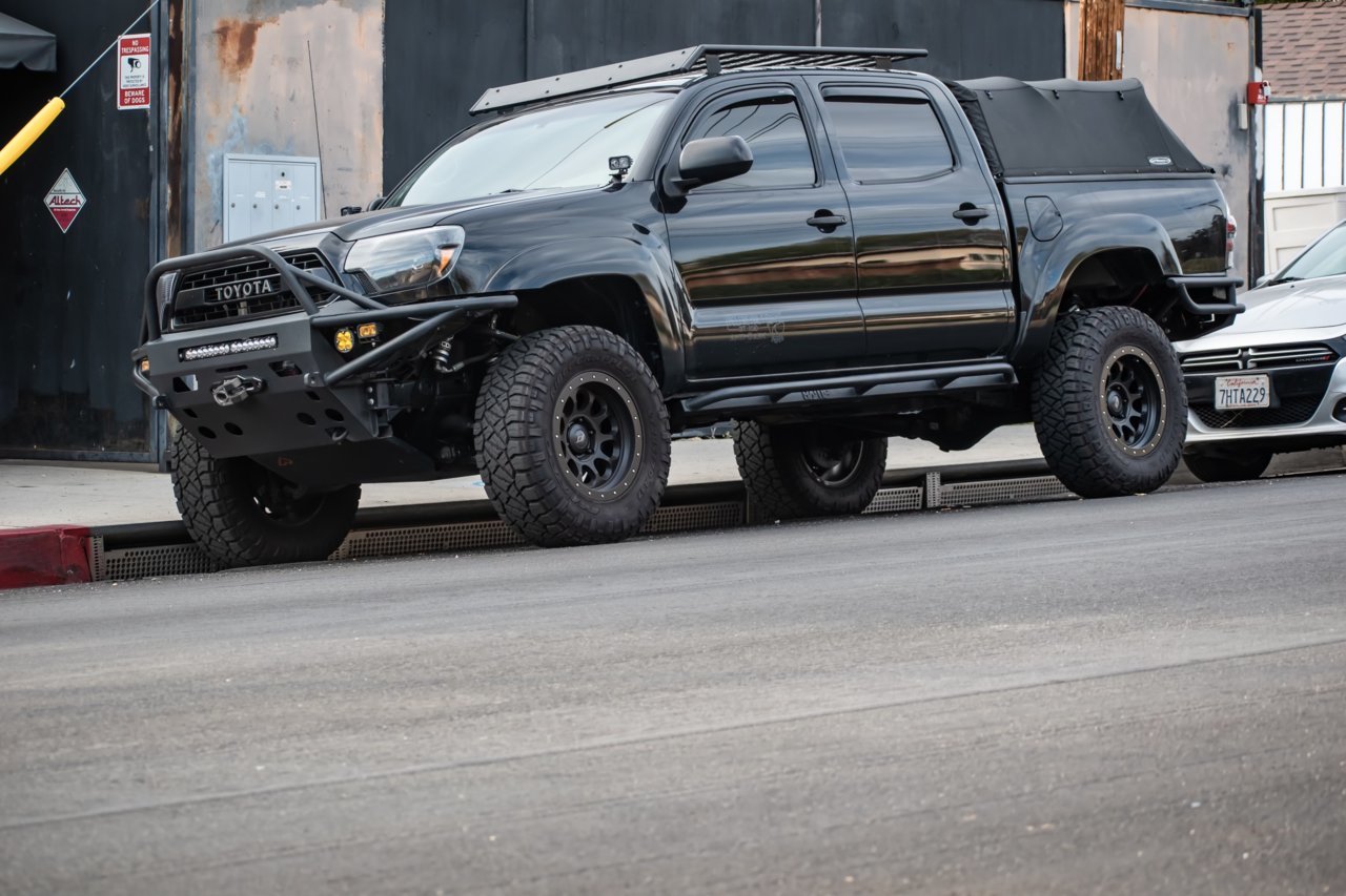

    Install day for @BKinzey
    Fox 2.5 front, ADS 2.5 rear, Ironman forged UCAs, WarFab tie rod sleeves with new OEM tie rods, Icon RXTs and braided brake lines all around. Also did the poor man’s cam tab reinforcement by welding a bead behind the stock tabs and welded in new threaded bungs to the stock transmission crossmember since the internal OEM welded nuts had broken off.

    Excellent Work! Really pleased.
