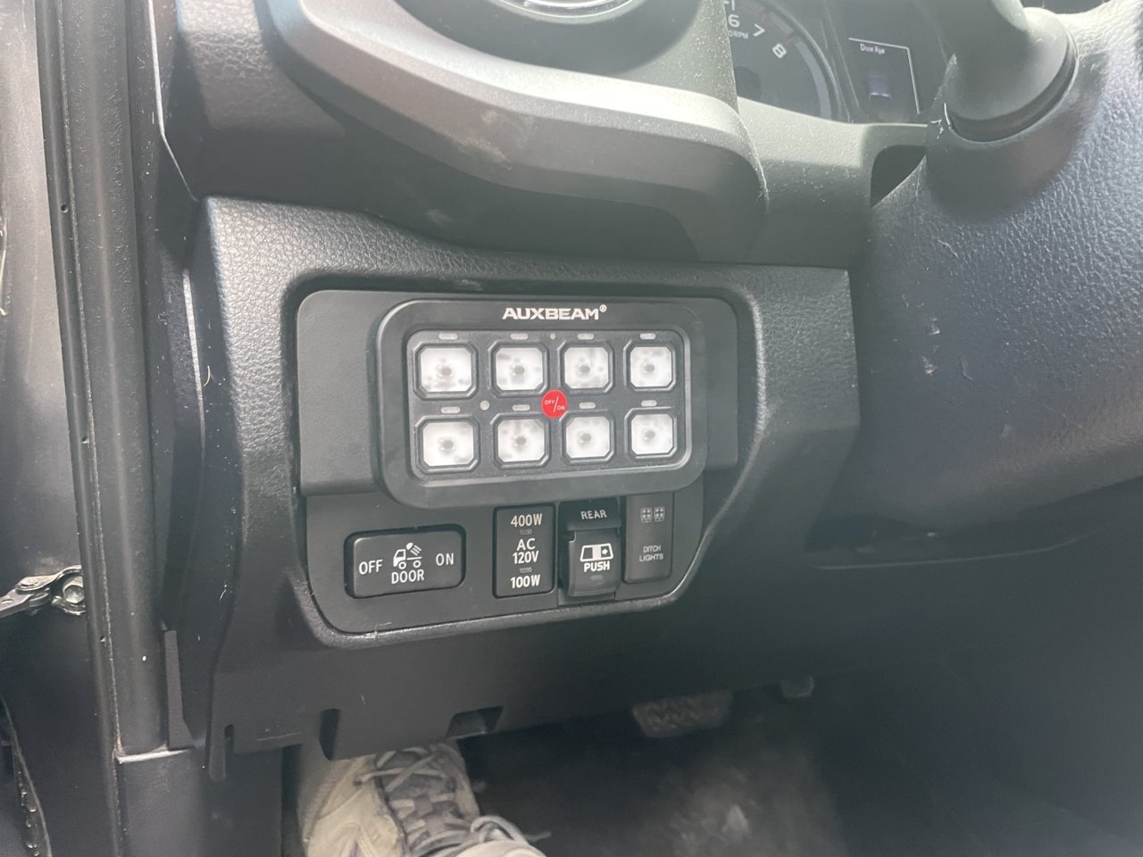

    install today for @ahom . Added some DD pods to his rear bumper and wired in an Auxbeam controller under the hood.

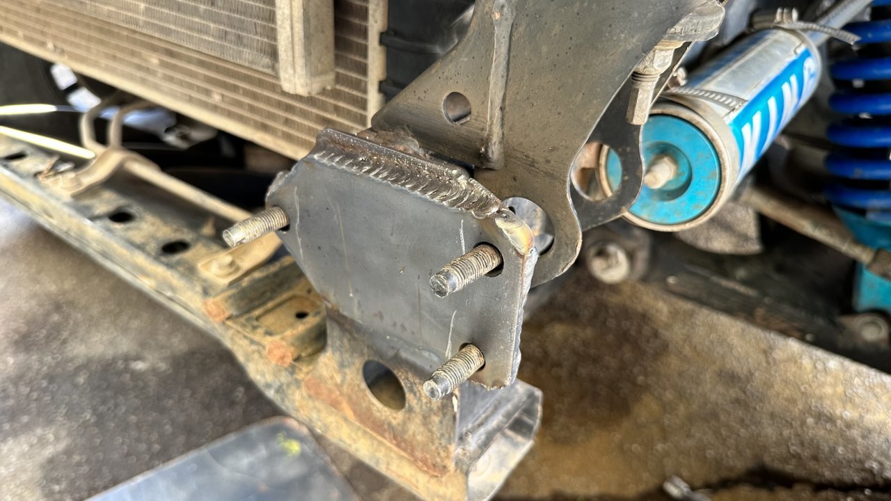

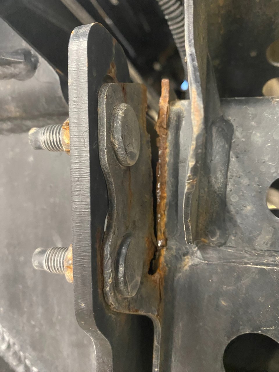

    I feel like a trip to @GHOST SHIP is becoming a tradition every time I’m back home lol. Found out both sides of my bumper mounts were hanging on by hopes and dreams, so thankfully Sergio is available to help a brotha out! We’re gonna be adding a little reinforcement plate too (more pics to follow)

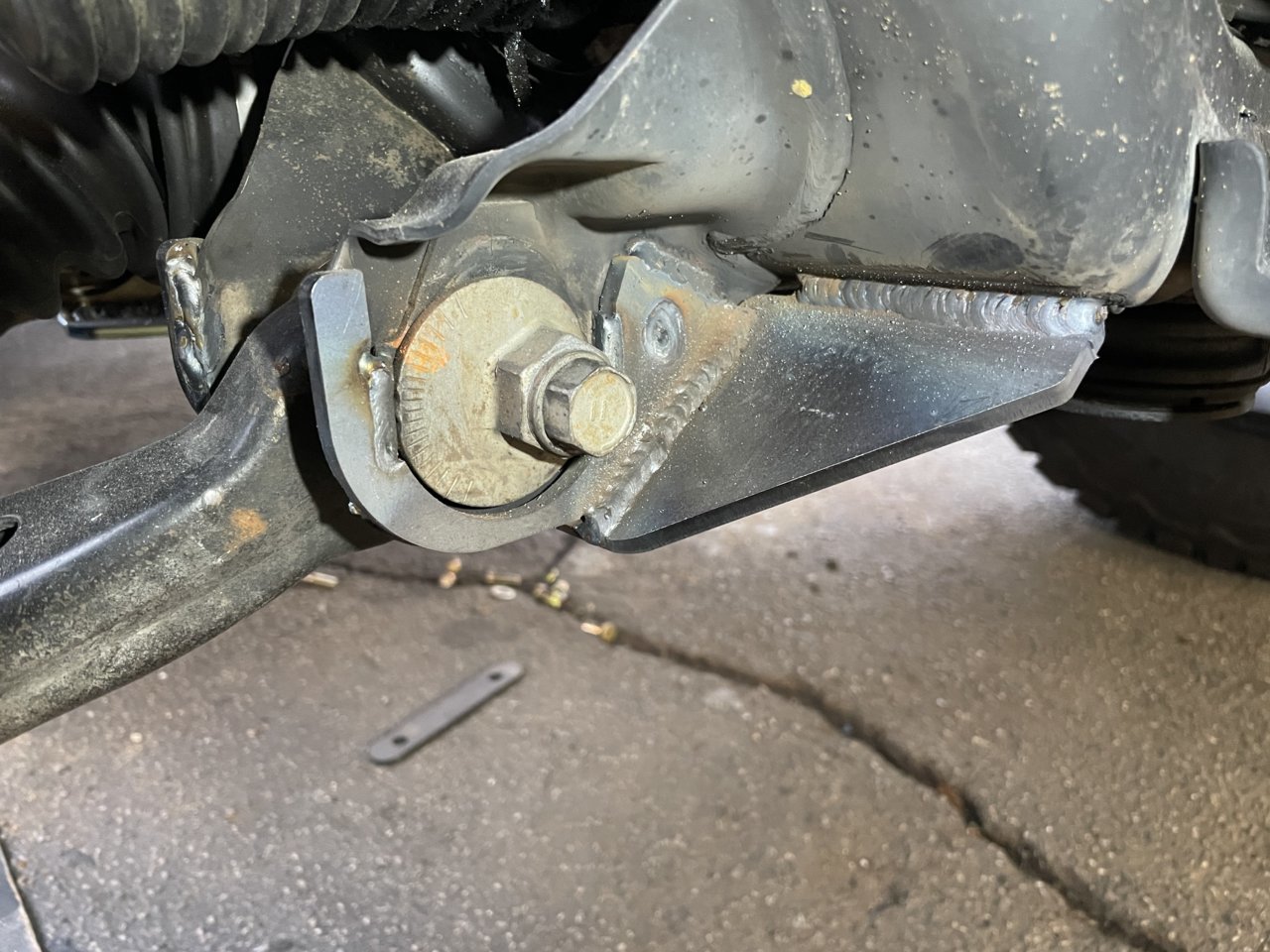

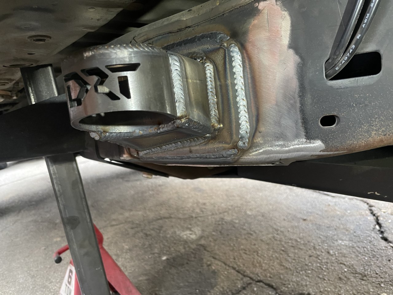

    Front end reinforcement today on @Abused Taco ’s second gen.
    Closing out the year with angle grinders all day.

    Is this a normal thing? Haven't seen this before and now I'm terrified :eek:

    Not “normal”, but it’s happened enough times where a repair like this has been posted a few times before. There was even someone here making reinforcement plates that get welded on to the frame horns similar to what I did, but I can’t remember who it was.
    edit: found out who it was. Thread got closed because the dude was ghosting customers with open orders.

    I didn’t have a reinforcement with the steel bumper, so with the paper thin frame horns it was bound to happen. Usually they come with mount reinforcements that sandwich that whole area, but I didn’t get one since mine was acquired in a non-traditional new way lol (read: pelfrey warehouse close out after debacle)

    Yo! can you get me one of these Auxbeam mounting plate chingaderas crafted up?
