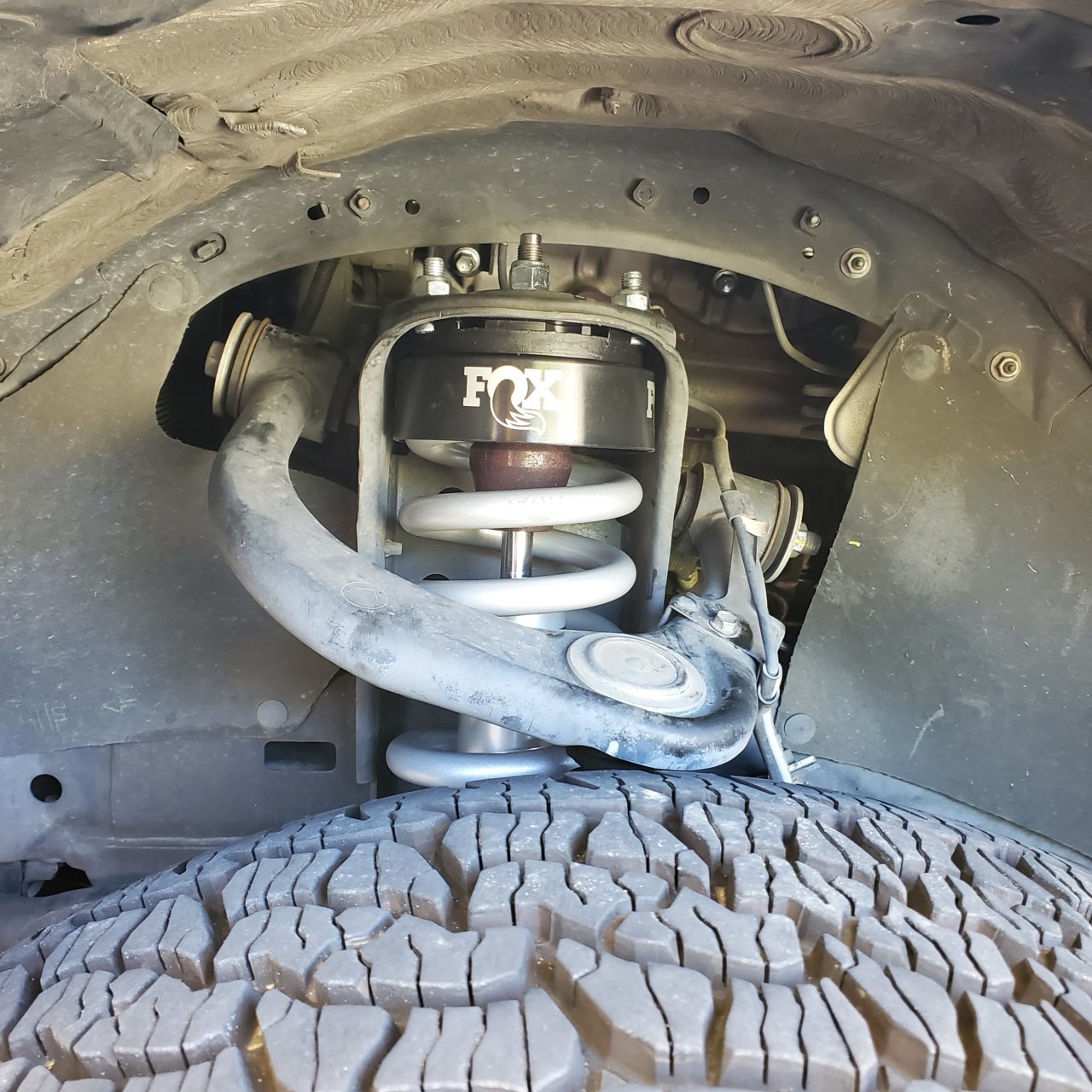

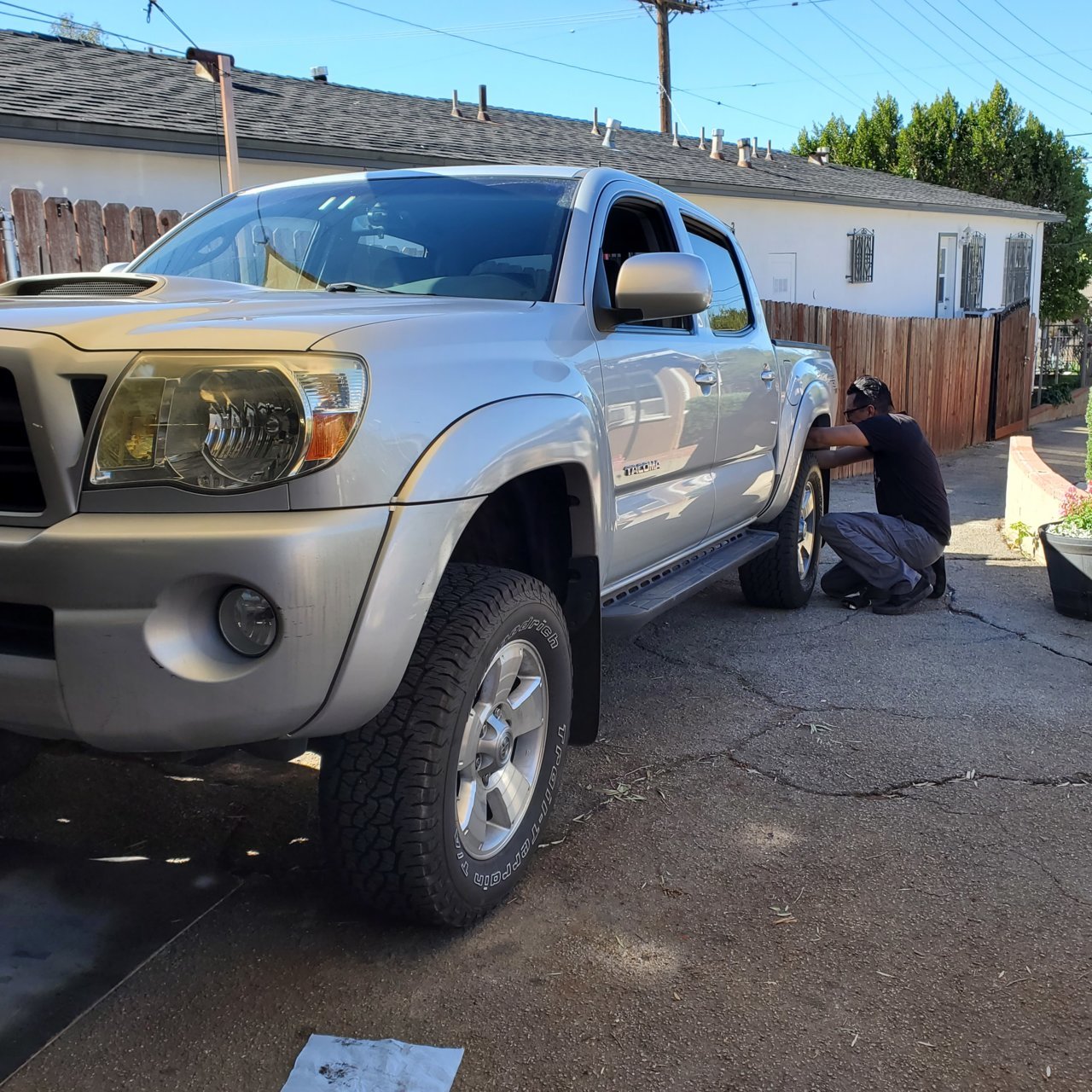

    My uncle gifted me his 06 before he passed from cancer this past Christmas morning. I swore to myself that it would be my stock daily driver since the 01 is completely built. He hardly drove it so it came with 56,000 miles.
    Well the stock shocks were getting worn (yah right) so some new fronts and rears were called for. :anonymous:

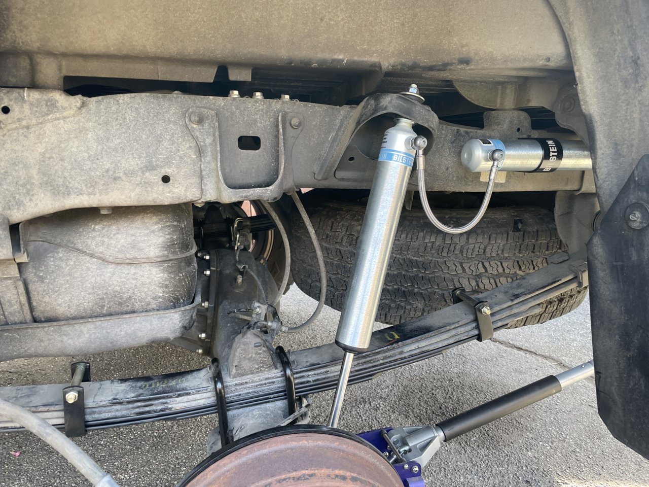

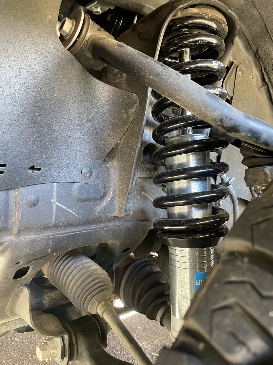

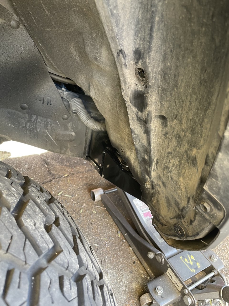

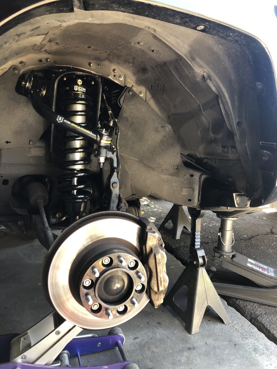

    Another install today for @GSager78
    Bilsteins, Icon AAL and a CMC round out this no-nonsense combo.
    3F455248-1955-4B5F-B8D2-51B2A92675C3.jpg 968C39EC-82C0-4C76-8B25-ADBD250855EA.jpg BA21560E-6A9E-4515-9C4A-B5A1D0DFD9EE.jpg

    Thank you so much, Sergio. Super clean work and the truck rides great. Great meeting and chatting with you as well!

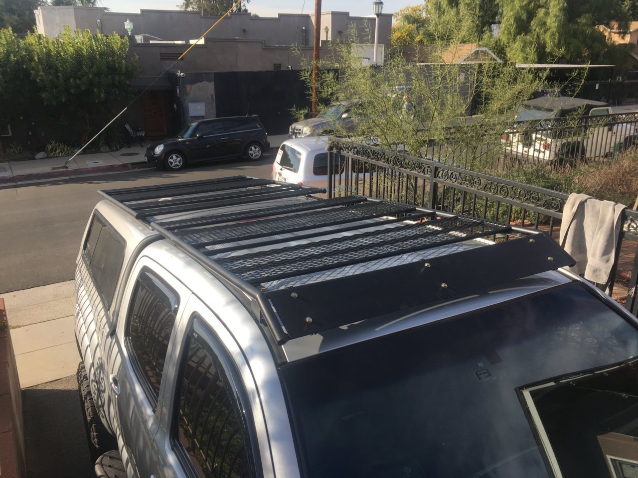

    I like your rack, do you mind sharing you basic plan for it? I don’t have a need for a roof rack but I’ve had an idea for a light bar/cage that would work well with your rack design.

    Thanks! Plan? I originally designed it because there wasn’t anything in the market that was 48” wide for carrying flat stock like plywood or drywall. It kind of bothered me that most racks at the time were only 46.5-47” wide. Seemed like a missed opportunity. I also prefer the expanded steel as opposed to the now common extruded aluminum bars because you can hook tie downs anywhere on it without the need for special hardware or tools. Otherwise it’s just a pretty basic flat rack made to be as low profile as possible.

    I should have clarified, the way it mounts up to the roof lol but I agree, I’ve had ideas for similar roof racks, even saw BajaRacks has something similar but charges an astronomical amount for it. The mounting part is where I’m stuck, I’m just curious as to what you did for that. Thanks bro
