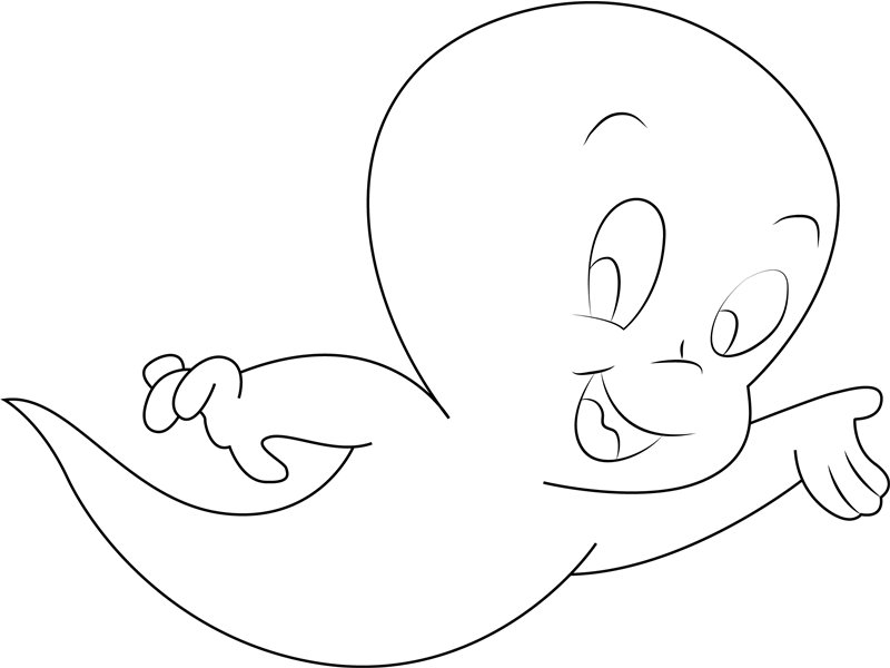

    try this:
    Casper the friendly ghost
    on an old school schooner.. .
    just spit balling here

    Do you concur?

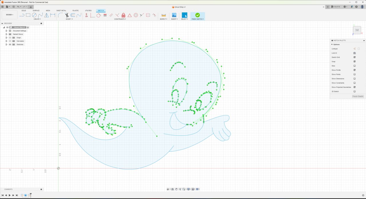

    :anonymous:

    Between a crying newborn and cleaning the house, I wasn't sure I wanted to start creating the cut path for Casper :rofl:
    I mean it'd be easy, but too easy to lose details too and I didn't want to resort to straight lines since my kerf width is only 1.1mm

    I'm digging it!

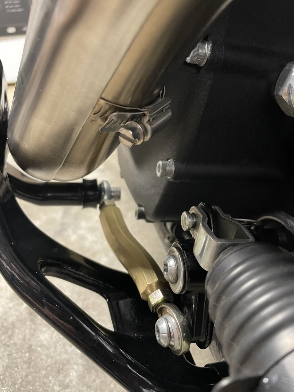

    Small update to my brass shift linkage.
    Turns out the bend in the stock linkage is necessary so the heim doesn’t bind up at the end of travel. So I made another one. This time I used the square stock and shaped it to an octagonal profile with various files and hand sanding. Then I bent the straight rod to achieve the s bend followed by drilling and tapping for the rod ends.

    Como siempre bien chingon :fistbump:

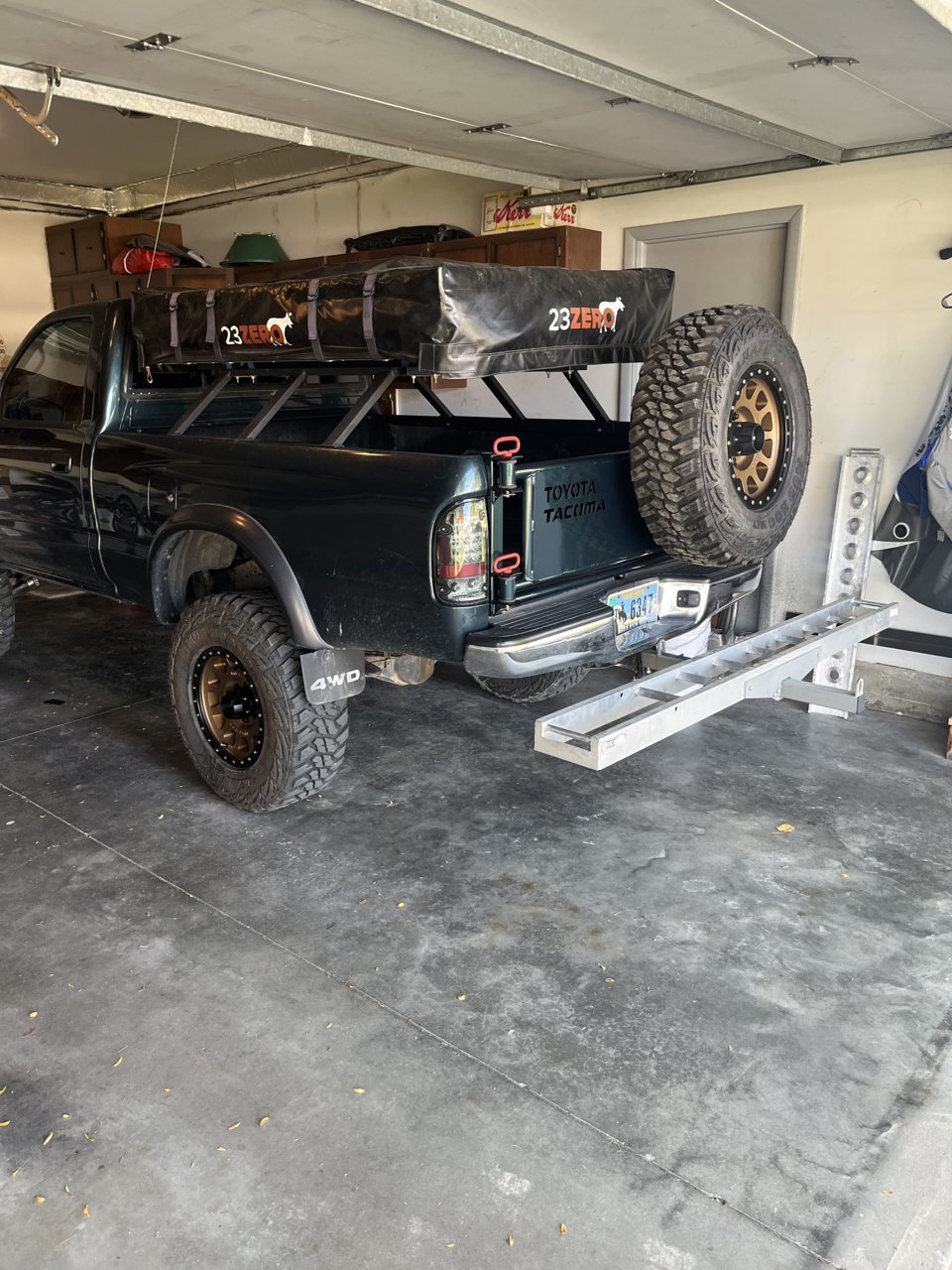

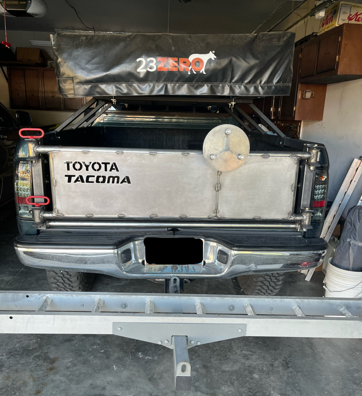

    Tailgate tire carrier made its way to Wyoming to @Clark2.7 He went an extra step and had the Tacoma badges laser cut into the skin of the tailgate and then had the whole thing color matched to his green first gen. I’m really digging the whole setup paired with the bed rack from @turbodb

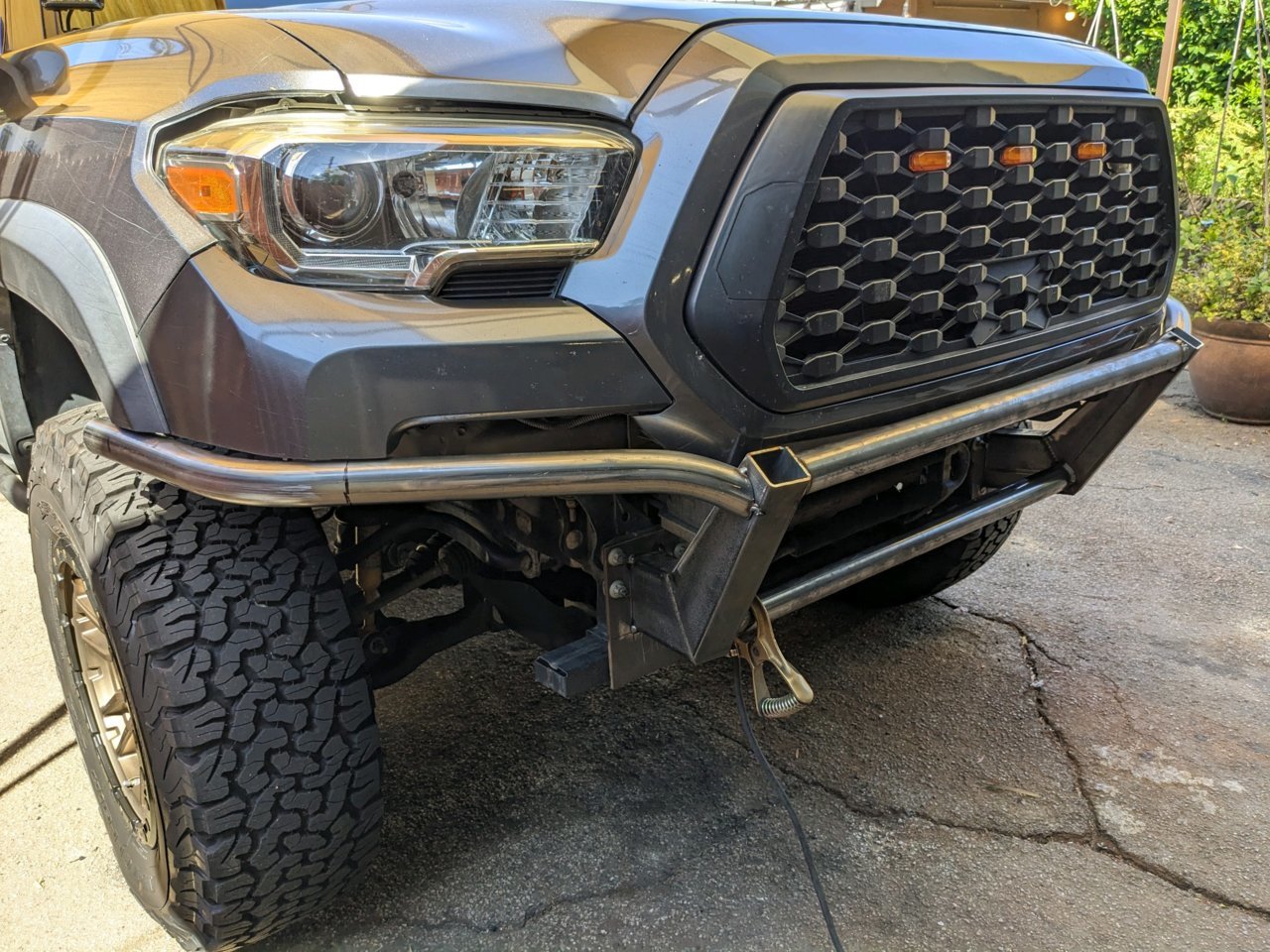

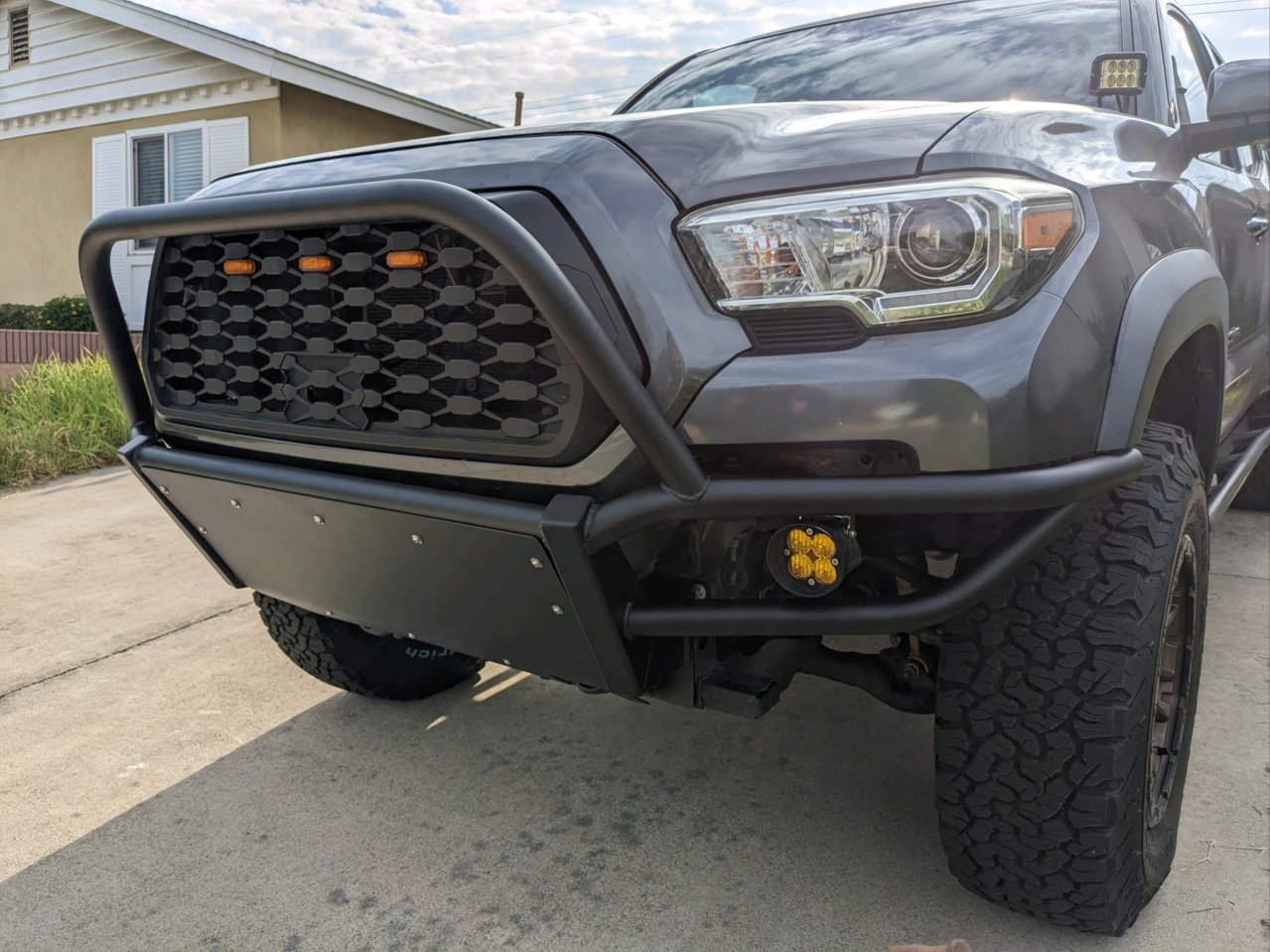

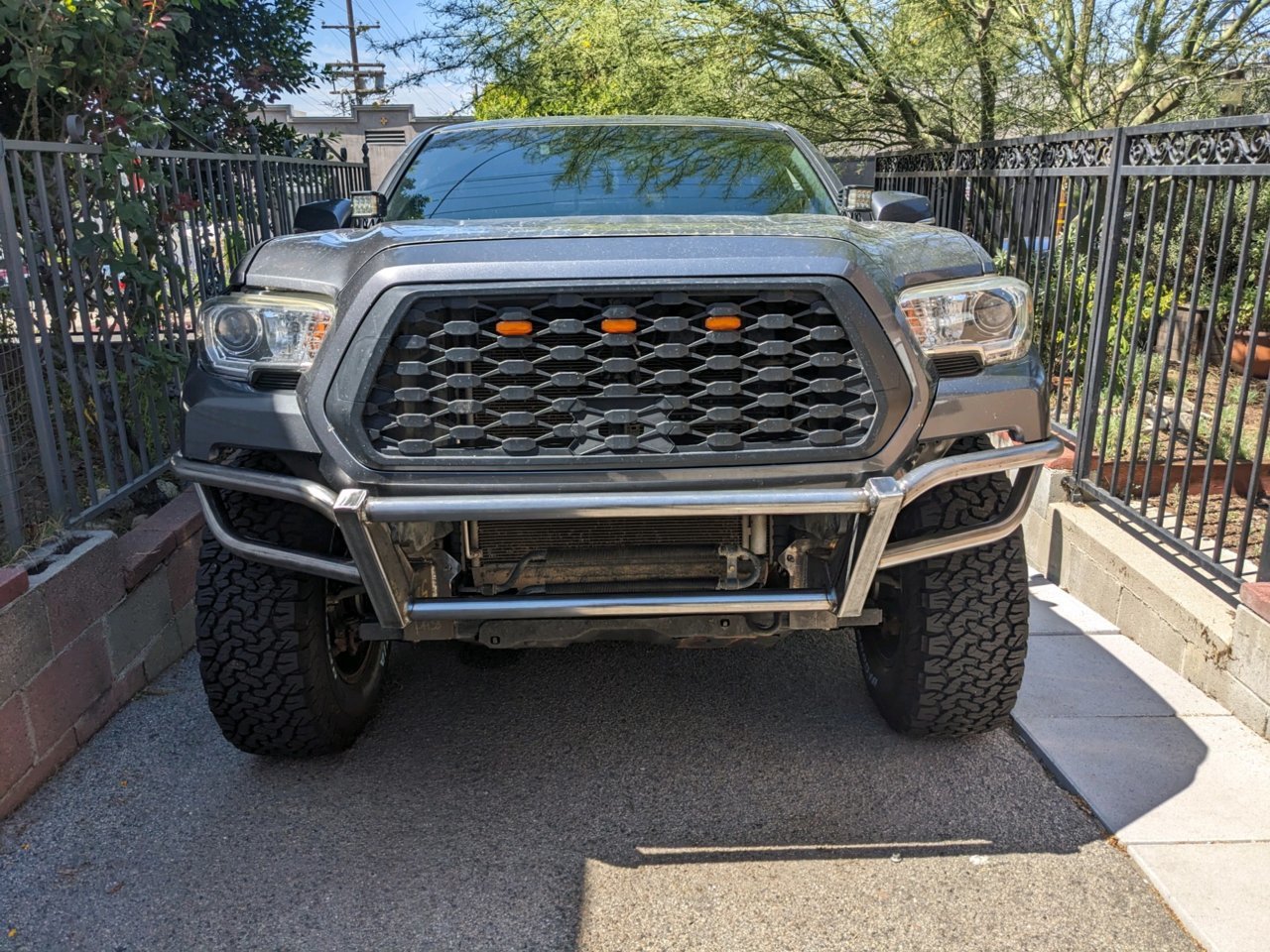

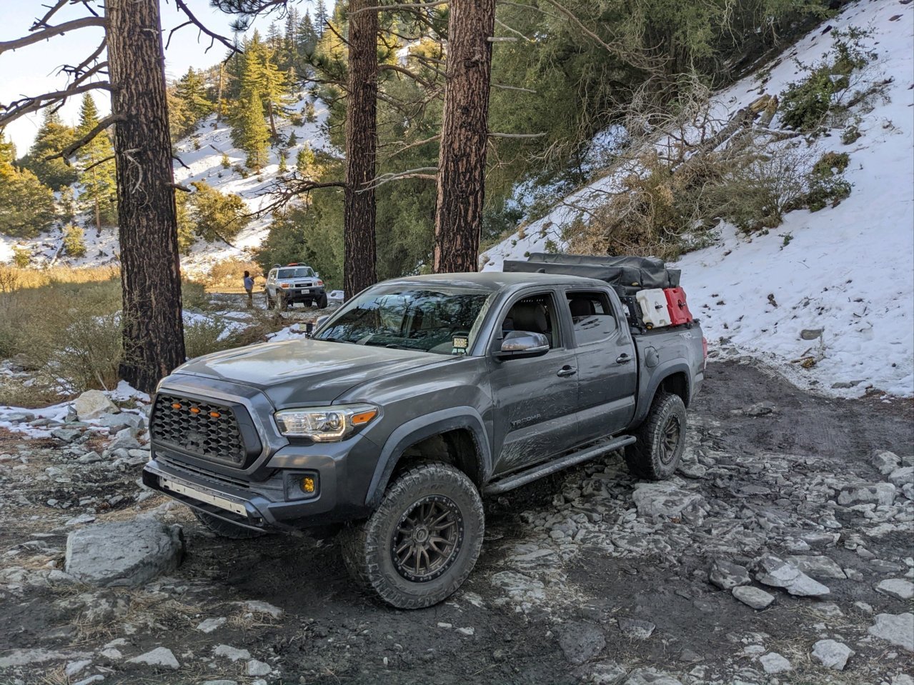

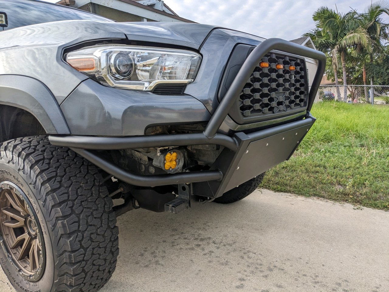

    Next here’s a big one. Custom front bumper for @ahom ‘s third gen. His stock front bumper took a hit in a snow drift up at big bear and he was in need of a replacement. He’s come to me previously for a rear bumper and sliders for his truck and we’ve talked about a front bumper build for some time. Finally got it dialed in after a few quick measurements and a couple test fits before final install. I can’t express how happy I am with the end result and how tight it fits to the lines of the truck. Exactly what we were going for.

    Nice those look sweet.

    Looks freaking great!
