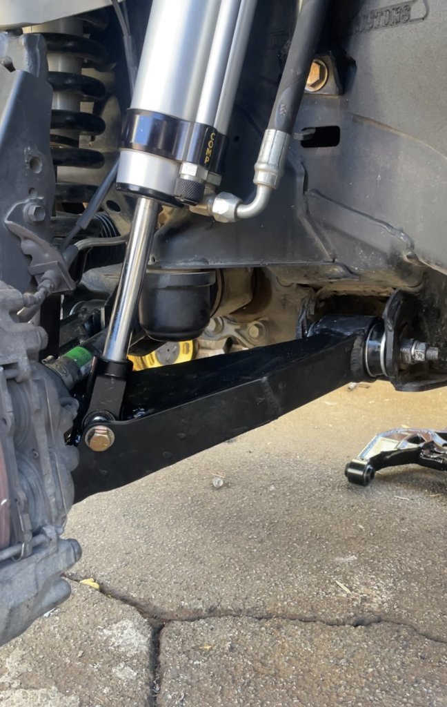

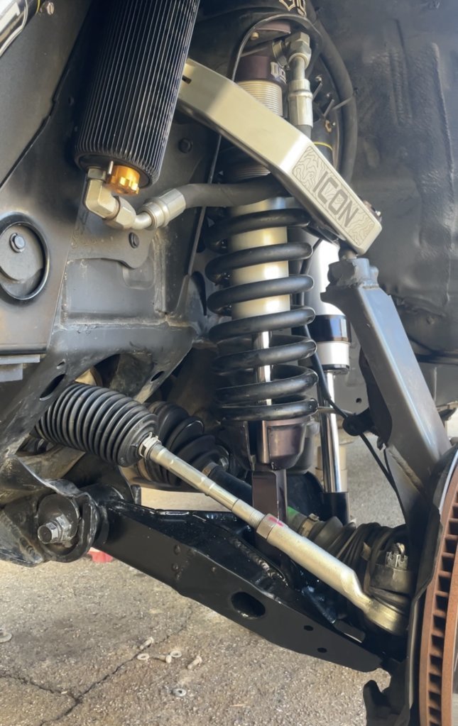

    Long install this weekend on @Georgeth1022 ’s truck. At least it took longer than it should have. Icons new fabricated stock-length LCAs are pretty beefy but they are not a direct bolt-on part. At least not without mucking around with them a little. They have pressed-in poly bushings but the set we received had them pressed in too deep causing a fitment issue with the LCA mounts on the frame. I had to get creative and spread the bushings back out about 1/4” to get the arms in but they still fought me the whole time. Once in, they’re pretty dope though. I just feel bad for the next guy that has to take them out for maintenance. (It’ll probably be me). While there, we also replaced the inner and outer tie rods and rebuild the billet Icon UCA with new delta joints. The front end has been fully refreshed now and good to go for another 50k miles.
