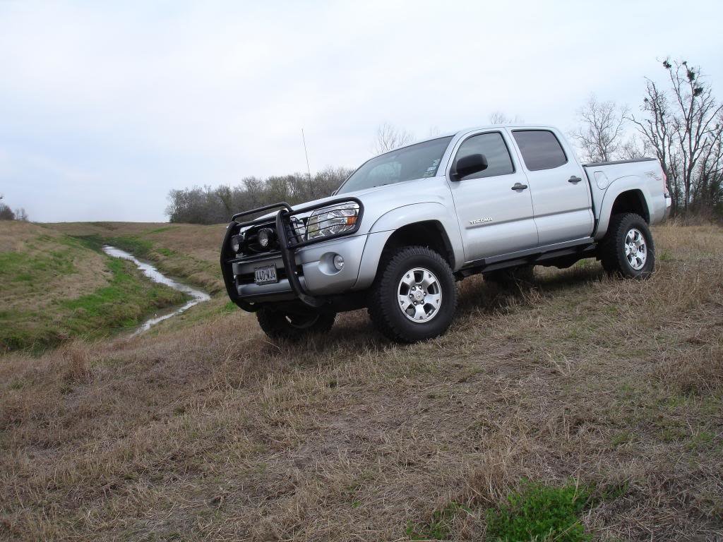

    The day I bought her:). 2006 Double cab TRD-Offroad Pre-Runner (yes 2wd).
    I immediately knew I wanted to add a brush guard, not a cheapo bull bar (sorry bullbar guys:(), so I did some searching and came across this. I mounted KC 385,000 candlepower Hilites Daylighters and wired them directly to the battery so I could have them on without the headlights. :cool:
    Well it turns out that the original black plastic KC covers started melting when I left them on. So I took them back to the shop and swapped them out for the wire mesh covers. Then came the dilemma of choosing whether or not I wanted to keep the headlight guards on or not :confused:.
    I eventually decided to keep the entire guard together, and installed a 3" suspension lift with an AAl in the rear made by ProComp. Sorry no pics of that install, but here's the after picture.

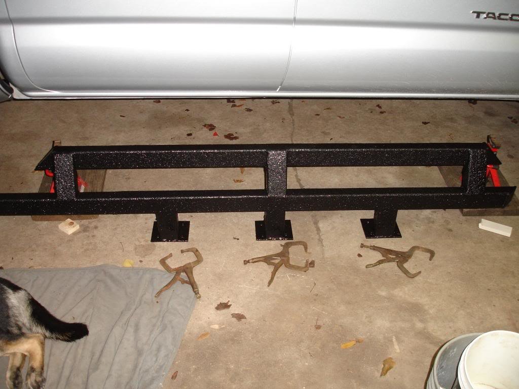

    I decided to build some custom rock sliders/steps................bolt-on.:eek:
    I needed to make use of what I had, which was essentially an ancient stick welder, metal band saw, and a 4.5" grinding wheel. Easy right? I’ll let you decide. I’ve got to thank my Dad the most for being a great sport and putting up with my……choices…. of how to build them. I couldn’t of done it without him helping me on those nights.
    Yep, that was the welder.
    I bought 40 feet of 2x3 rectangular tubing that was 11 gauge (1/4" thick) and had the steel company cut them into easier to manage 10 foot sections. I also purchased 4 feet of 1/4"x6" flat steel for the base plates, and 1 1/2" X 1/4" flat steel.
    Once I had the primary cuts done, I mocked up the primary pipe under the rockers and took the measurements for the pipes to the base plates and welded them together.
    Once these were done, I needed to cut the right angle and length for the risers for the second pipe. Not an easy task, but my dad and I cut a model out of wood to use as a guide, and we were able to cut great risers out of the remaining steel.
    After mocking up the pipes again, I decided to cut the bottom pipes at 45's to aide in the sliding function if necessary. The blunt pipes just didn't seem to help in that category if needed. It also looks great with outside pipes already being angle cut. Once that was finished, I welded on the end caps for the 4 pipes and started grinding the welds smooth. I like camo....:D
    Now that those are done, I wanted nothing less than to have them coated in durable spray-on bed liner.:thumbsup: So I grinded everything down to bare metal and took them in to get sprayed with Line-X.
    Now that they are done, I just need to cut the.....ahem....."tits" off with a razor and all will be good. These pictures really don't do the bedliner justice. I took these pictures right after they got back, so they're really shiny. These puppies are STOUT!

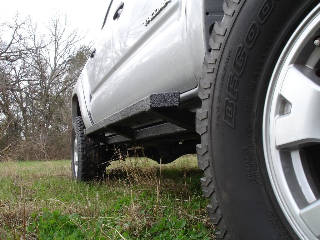

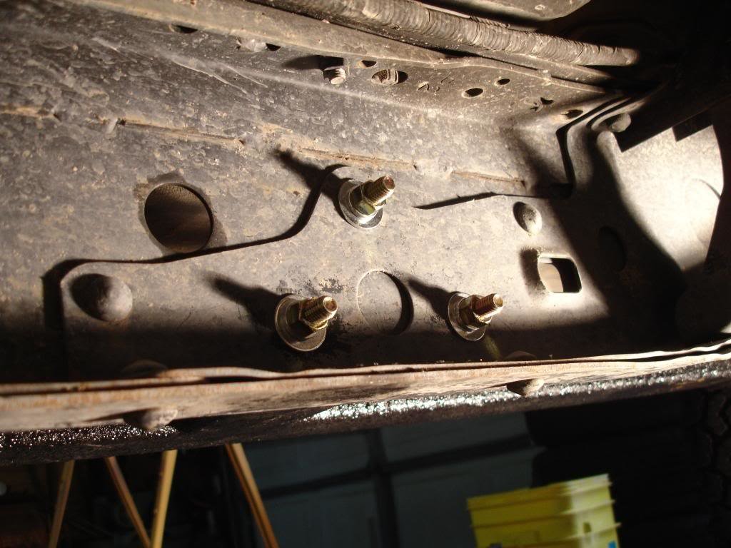

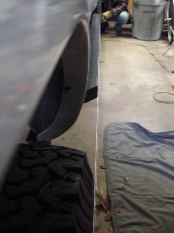

    Sorry it took so long TW fans, but here's the photo's after I installed the sliders this weekend.
    Prepping for the bolts

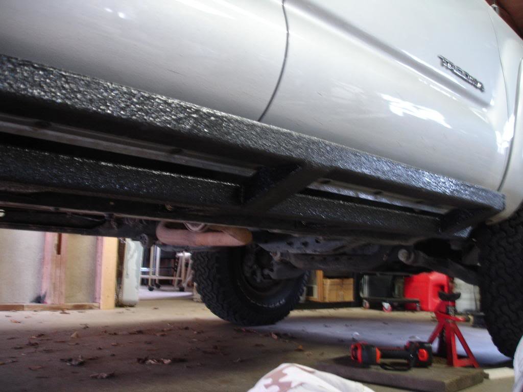

    Installed and view of the bolts from the rear
    Checked the distance from the rockers and ensured that my measurements were correct and they are even with the outside edges of the tires. A simple "plum line" wrapped around the tires shows that they are even.:D:D:D

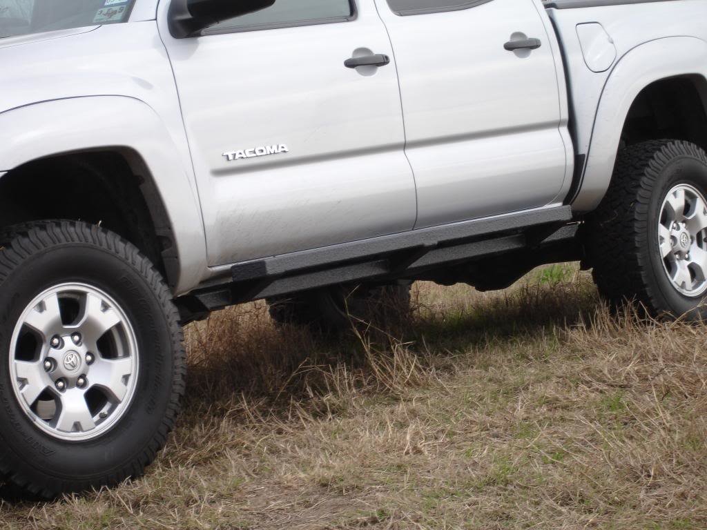

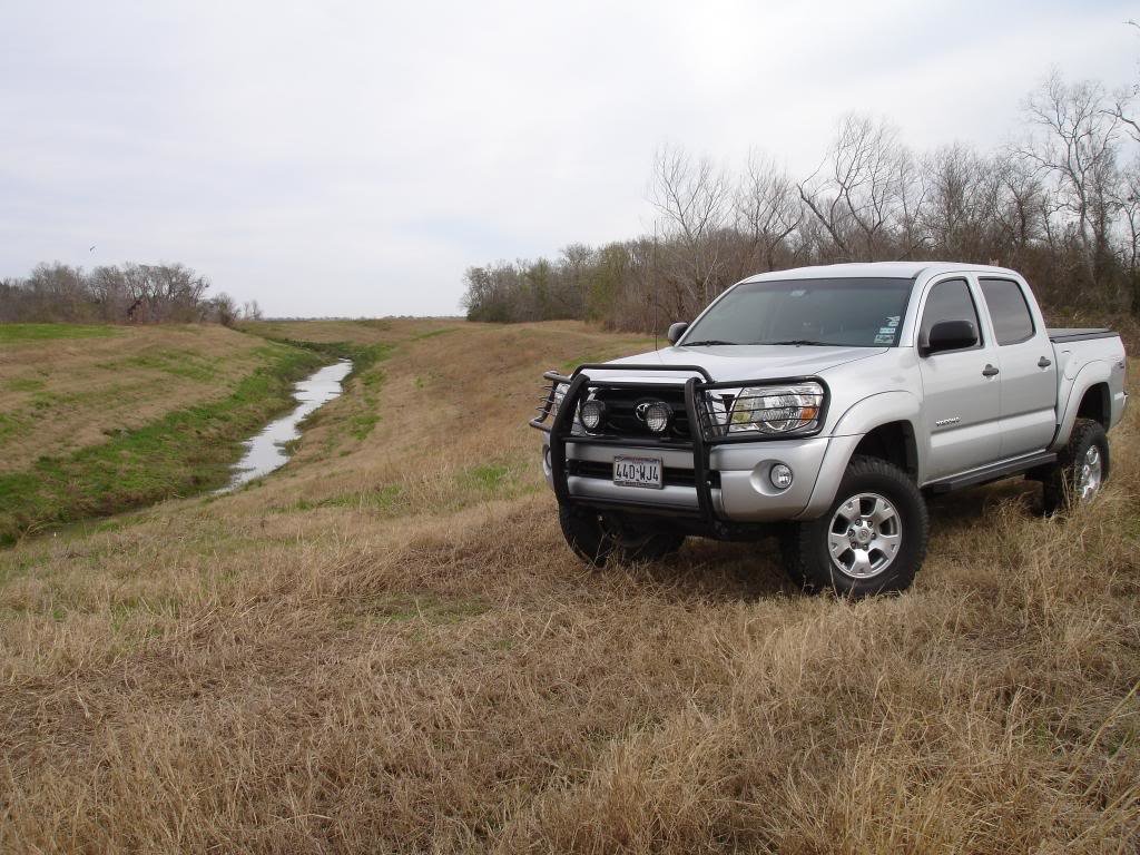

    Now for the action photos from taking her out! It was alot drier than I thought it would be. :(
    And there you have it. Sliders installed and bolted on. :rolleyes:
