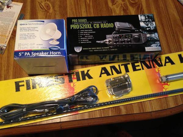

    Got a few goodies in the mail!
    Maybe ill be surprised with a cb set for my bday next week!!

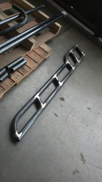

  5. May 23, 2013 at 1:18 AM
    #45
    senojeelnodnarb
    senojeelnodnarb Well-Known Member
    Oct 3, 2012
    #88259
    1,435
    Brandon
    Oahu, HI /Canton, NC
    2013 Tacoma DCSB 4x4 TRD OR, 6-Spd Manual
    Fully De-Badged, Mossy Oak seat covers, Fog Light anytime mod, Custom Bed Light Bar, flowmaster 40 series, Plasti-Dipped Grille, Painted Stock TRD Rims, Custom Plate Bumper, High-Lift Bed Mount, Ballacula Trailer Plug Relocate, Rear Seat Dog Platform, sunglasses holder Switch panel, 2" lift, 285/75/R16 Mickey Thompson Baja MTZ, custom sliders, + a shit load more,
    i see the trucks coming along. looking good!
    i built a set of sliders and am wondering how you bolted them on. troo the side of the frame or bottom and side?

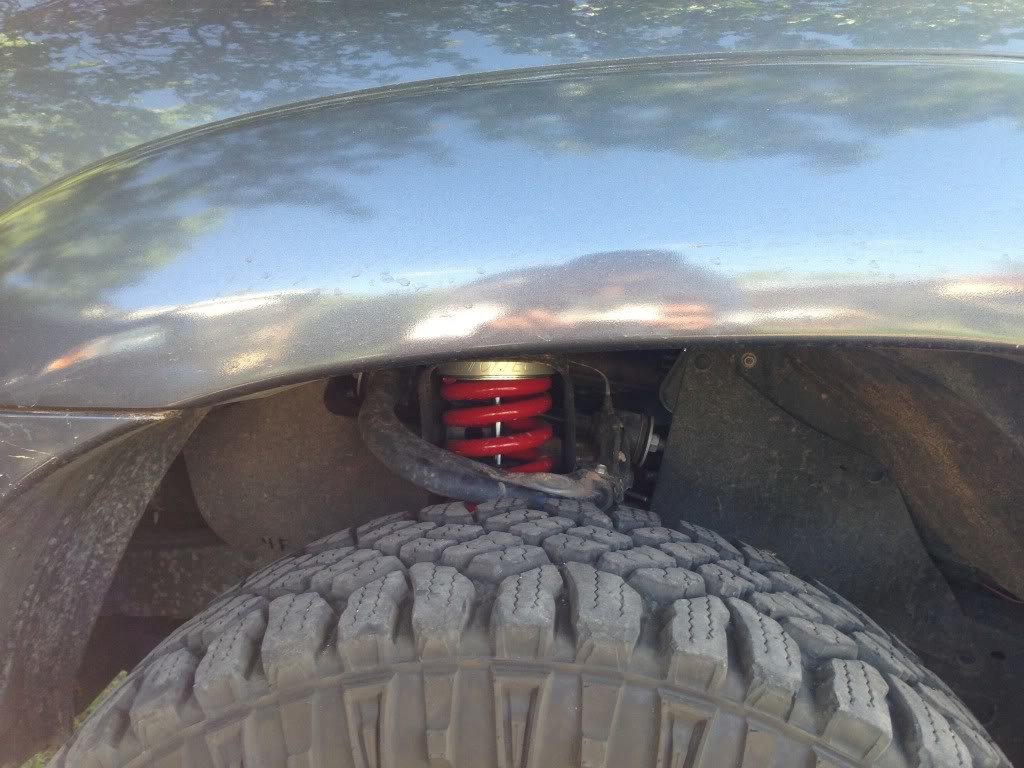

    Finally had time to install the new coilovers!! Rides so much better!
    DF058443-D54C-4C4A-9BFD-8A858685FACB-143_60eeb4f03b00e0f9d9625d00f36c25e77be0a6b9.jpg
    Going to order a shackle flip this week and hopefully picking up some chevy springs to make a custom pack.

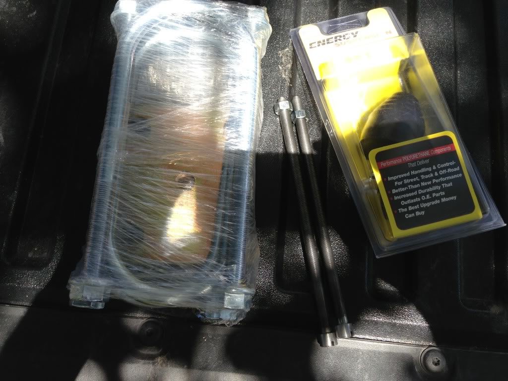

  16. Jun 23, 2013 at 7:21 AM
    #56
    GhostDog86
    GhostDog86 [OP] Well-Known Member
    Sep 30, 2012
    #87986
    468
    Max
    Chimayo/Santa Fe
    DCSB TRD OR
    Remove mudflaps, Plasti dip badges/ lower val/ and grill, Plasti dip wheels, 5% tint all around, Tinted tails and 3rd, 55w driving lights in rear, Blue LED light strip in bed, Blue LEDs in cab/ cup holders...

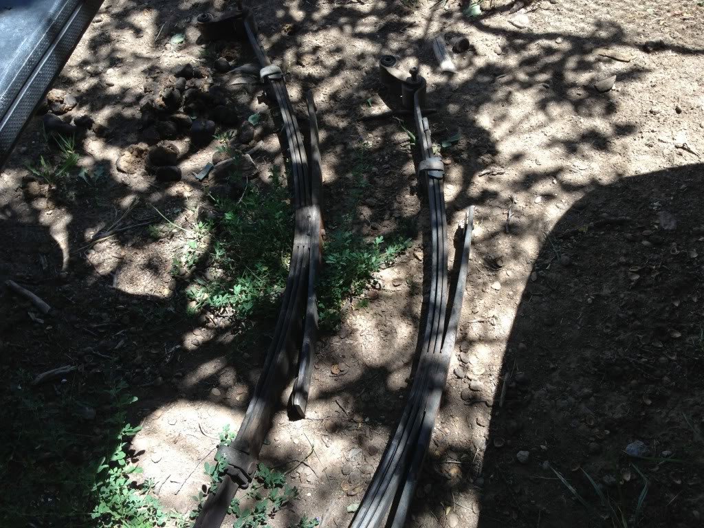

    Had time to get some work done on the truck. If anyone was at Moab this year they'll remember my squeaky leaf springs. Well they stayed squeaky despite powerwashing several times. The ride sucked anyways with the Deaver AAL so before shelling out cash on a new leaf pack I decided to swap in a few chevy leaves.
    What I started with:
    All Pro U bolt flip
    Energy Bump stops
    New Center pins
    54ECCC05-2D55-4580-BA97-5AF5B39E0548-104_afe6bc8d07ad12e18a8ff0fbfbf0571571654d81.jpg
    and
    93' Chevy 4x4 leaf pack
    072B8F71-B00F-453A-B6DA-6945A9DE1AA4-104_705f7fbf3a546953ca2e8ca334c3d4b96aae2095.jpg
    after 5 hours had the chevy leafs cut, bumps drilled and everything bolted together.

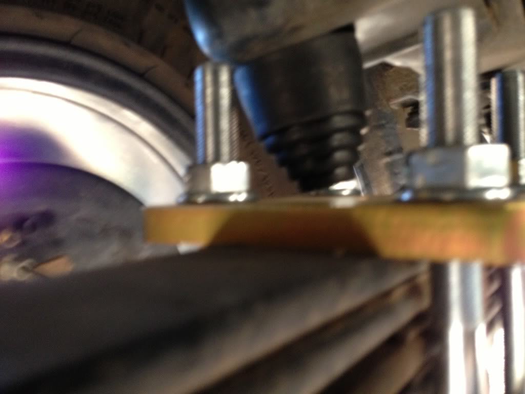

    Bump slightly contacting right before the springs start negative arch. I might need to adjust these a tiny bit hopefully I can keep the tires from chewing up my fenders any further.
    2DCD1990-1D50-46F2-B9CF-69CC4B03E7AC-104_61cd4fde6e188aa464fd65931509e7226d1ef8d3.jpg
    66328A50-3463-4A9F-B72D-CE6A5A0836E1-104_2c591212ffbabc3757aae7d89e6b81525fa6e6ad.jpg
    On this pic the shocks are at their limits, definitely more flex available.
    883BFDCD-FA8A-49C4-9C31-BF25281DA2B5-104_24c152d05a3c9a9f5e1ecd5a3af9732dd642ef2b.jpg
    4DE49EC7-9C55-48EA-9E7E-8F9175F324DD-104_bb84297a933a292842de02825fa7d6ff7546d406.jpg
    While I was at it I also adjusted the drivers CO to match the passenger.
    The ride is just amazing!! Even my wife was in shock at how great it rode. Took her down some washboards and the deference is shocking. The rear is no longer fighting the front end, no more hard bucking!
    The rear was lifted about 1" higher than the AAL, I really like the stance.
    Before specs w/ deaver AAL:
    Pack height 1 7/8"
    Uptravel ride height to bump contact 5 1/2"
    After w/chevy leaves:
    Pack height 2 1/4" + 1/2" top plate
    Uptravel ride height/top plate to bump contact 5 1/4"

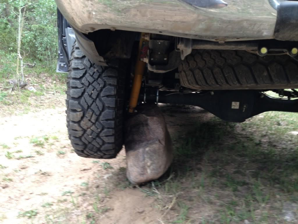

  18. Jul 11, 2013 at 7:58 AM
    #58
    GhostDog86
    Sep 30, 2012
    #87986
    468
    Max
    Chimayo/Santa Fe
    DCSB TRD OR

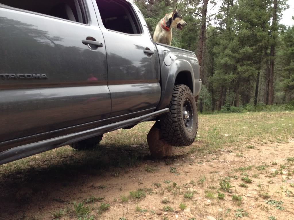

    Thought I'd share this pic, shock mount grabbed this rock. As the rock flipped over it put the tire in the air.
    7F7883D0-537B-4A9B-97AD-401BB159AB37-219_caea1cfbba148dfca005d61d3df626474dd1b5ba.jpg

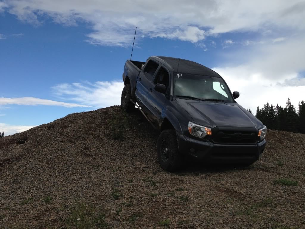

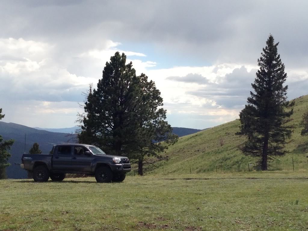

    Some pics from yesterday.
