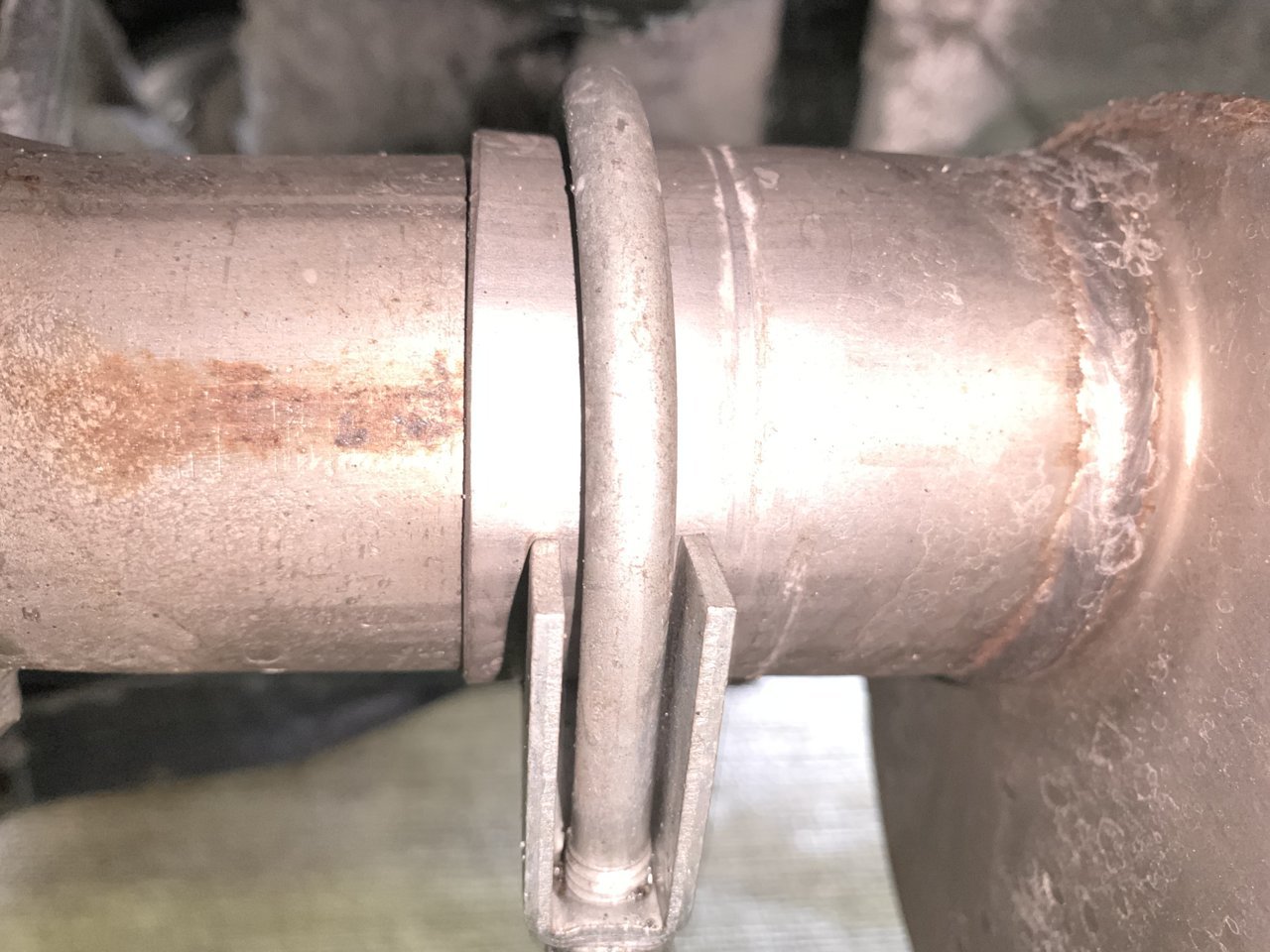

    so the clamps deformed w pipe a bit. i ordered 2.5” band clamps. will they pull that small flare out and seal correctly? 75C7542D-9694-46ED-89A7-87FD5FF323E7.jpg

    You can close that flare with the clamp you have. Just put it around the flare and tighten it. But more importantly how far is the pipe into the muffler? Is it to at least where the clamp currently is?
    Personally I'd like to see the pipe in at least as far as the old further clamp mark by the muffler.

    its at least that far up from what i remember. when i installed that was something i paid attention to.
    so i can use the clamp to correct that flare? that would be nice before i switch to the bands.

    looks like the flare was caused by clamping into a section that didnt have overlapping pipes

    also i dont think you are clamping onto much pipe either. It was a tight fit so i doubt you have much overlap past your old clamping point.

    so if it isnt, not much i can do at this point?

    honestly i cant tell.. take the pipe out, mark every 1/4" and see how many marks you cover. Or dont worry about it and run it.

    yeah ill play with it this weekend. im anal and want shit done right.
