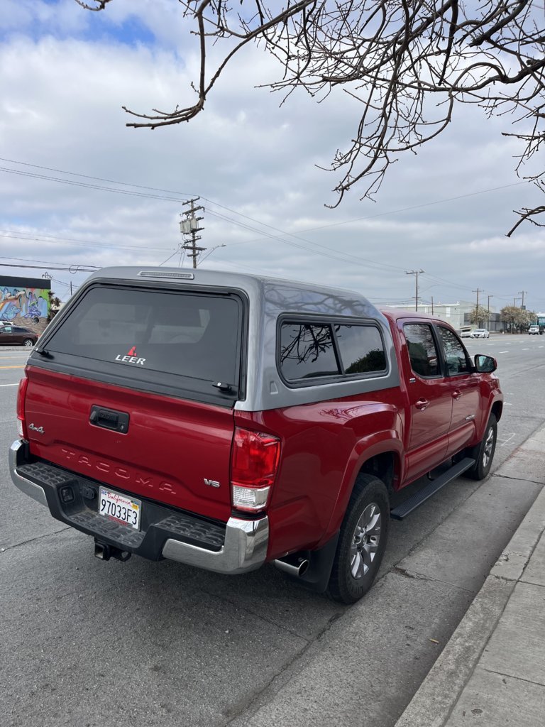

    Hi everyone, I found my camper shell (used Leer 180), got my brake lights, dome light and brake controller installed and then found and bought my trailer! It's a 2021 RPod 192 - here is the CL listing if you are interested:
    https://sacramento.craigslist.org/rvd/d/cedar-ridge-forest-river-2021-pod-192/7820968835.html
    Okay - so now it's time to buck up and tow my home-away-from-home 400 miles from Grass Valley CA to Tehachapi CA.
    I have ZERO experience towing a trailer like this but I have been dreaming about traveling around the West Coast and "following the weather" for years.
    I lived in a 36-foot trailer for a year and a half but never towed it anywhere so I have some experience with RV trailer living.
    I was a landscaper in my youth and did drive work trucks with no rearview mirror and smaller, utility trailers so I naturally use both side mirrors. Luckily, I love to drive and love doing road trips. I have crossed the country (CA to Philly) 6x times by myself and I drive for a living doing delivery and DoorDash.
    Here are my questions:
    1. The FIRST time you towed, what do you wish someone would have told you?
    2. Best practices for feeling comfortable towing. I will be doing 2 long-ish trips for my baptism by fire. I am splitting up the trip by stopping in Modesto for the night so basically 2-200 mile trips.
    3. I live on top of a mountain in Tehachapi. The last 3 miles of my trip include a 2000-foot elevation gain and multiple steep S-turns. What can I expect going up? What can I expect going DOWN??
    4. Some folks have said I should modify my Taco - suspension/tires/transmission...I think those are the big three. My truck is a 2017 SR5 4x4. I'd love to understand why these modifications are necessary or wanted and also how much money each could cost me. I have a budget and likely won't be able to afford everything I WANT to do so I need to prioritize.
    For this question, I am likely to tow my RV trailer 7- 9 months out of the year, likely every 2 weeks, from the CA deserts in Winter to the PNW in summer. I'll try to keep daily miles to 200/day /3-4 hours of towing.
    5. I'd appreciate any any all dad/mom/older brother advice - what would you tell your daughter/wife/sister about towing a 3500 lb trailer?
    Thanks in advance!
