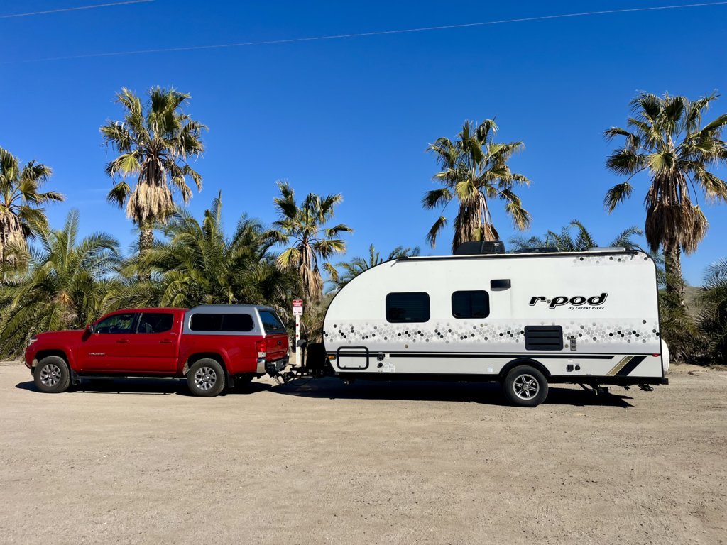

    I did it!!!!! My first time towing…384 miles total over 2 days!
    I still have to get it up the mountain to my house. 2k feet in elevation in just 3-miles

    First, glad you made it alright! Hopefully the climb up to the house isn't bad.
    So looking at this picture, and the axle placement on the trailer, I want to counter someone else's comment about loading stuff in the front of the trailer when good camping.
    You want the trailer axle to carry the weight, with only 10-15% on the hitch. Based on the axle placement, if you load the trailer evenly along it's length, you should be close to the proper weight distribution. If you just blindly through everything in the front, you could end up ass down in the truck, which is not how you want to tow.
    On the leafs / airbags comments, I'm not sure ~400-450 lbs of tongue weight is going to kill your springs, especially with a weight distributing hitch. But now that you're home, you have plenty of time to dial in the distribution part and see how much sag there is on the truck.

    Congratulations! Looking great!
    The truck doesn't appear to be squatted too much.. perhaps not dialed in perfectly but good enough obviously. : )

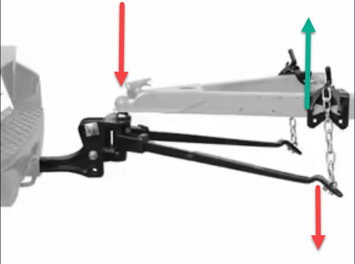

    This won't be the best explanation, but I'll try to explain a weight distribution hitch.
    Tongue weight at the trail ball presses down, which would lower the rear of your tow vehicle from the weight, which in turn would make the trailer tongue where it attaches lower as well, tilting your trailer downward. By tilting the vehicle and the trailer lower where they meet, the bars under the trailer tongue would get further and further apart. Red arrow is tongue weight on ball, and the direction the bar ends would move. But by chaining the ends of those bars to the tongue, the tongue is pulling those bars upwards (green arrow), lifting the rear of your vehicle and pushing the front end down. There's a lot of tension created to do this. The combined forces level your vehicle and transfer more weight to the front wheels of your truck.
    It's possible adding more tension to the weight distribution hitch would help with the wandering feeling you were getting in your truck. When there isn't enough weight on the front end, it likes to go side to side and be harder to maintain a straight line. I towed my trailer once with the load too far forward (way too much tongue weight) and i couldn't drive over 40 without it being uncontrollable. I stopped and shifted my trailer load rearward and after that I was able to drive much more comfortably.

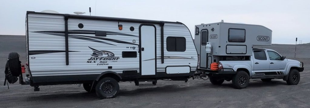

    Some of these trailers have pretty high tongues. This is the "baja edition" jay flight that has a couple inch lift over the standard version. I usually use an 11 inch drop on my high clearance bumper when towing. I had to have the weight distribution hitch on a pretty much straight/no drop setting for it to line up.

    I will respond with more thoughtful questions but I just want to say THANK YOU!!!!!
    This forum is literally saving me and your patience in explaining things and the visuals are helping me immensely!
    I have to write a talk today and I'm also in the middle or a search and rescue mission for a doggie that came home from the shelter and immediately bolted after chewing through her leash but I just wanted to take a moment to tell you how full my heart is...
    ps: now I can see the difference between a WD hitch (bars) and sway bars!!!! yay!
