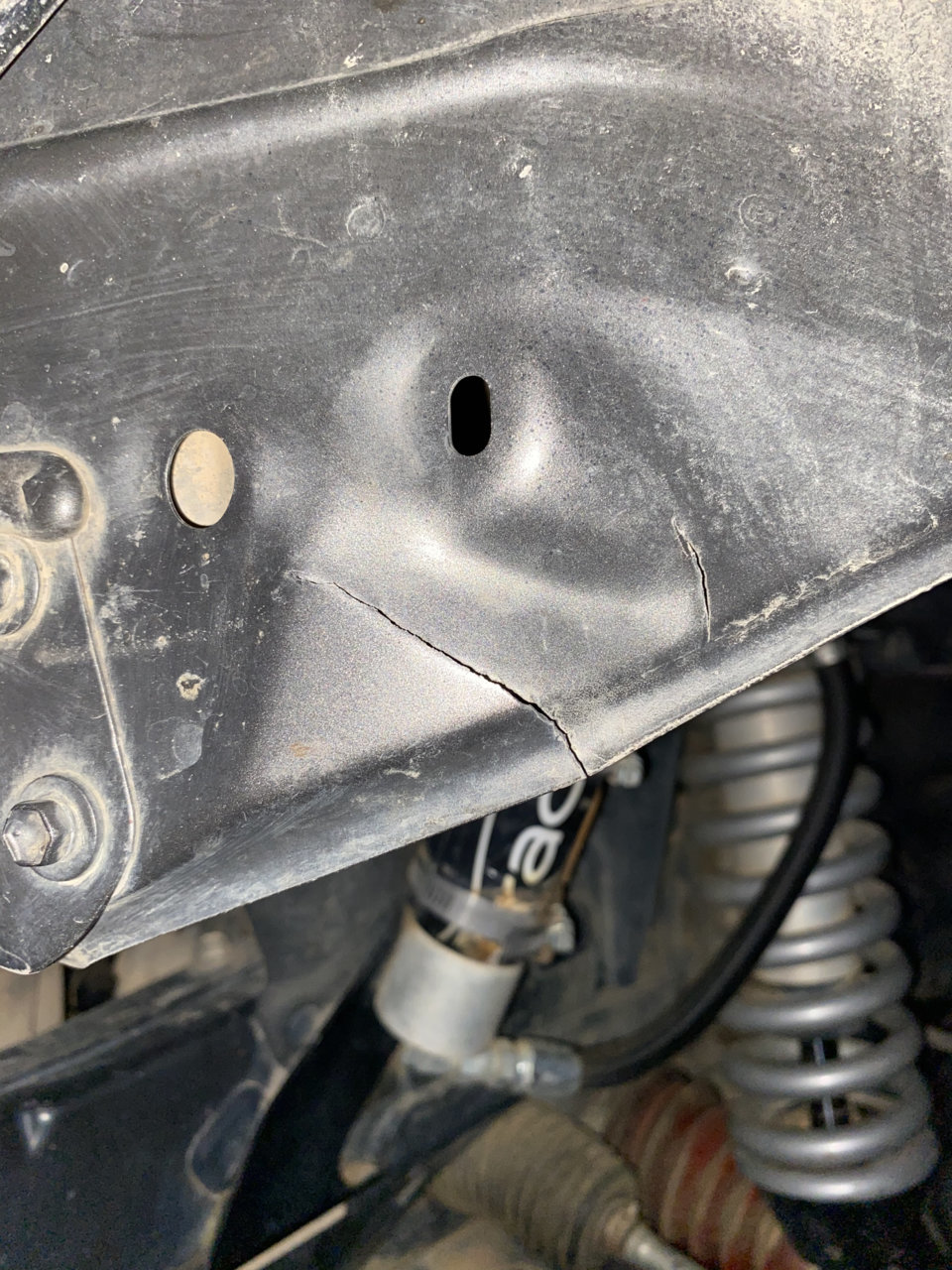

    Well mine has started to fall victim to the well known issue with the core supports and surrounding area. Give me a little motivation to come up with a solution!
    what have y’all done?

    First off drill a hole at the end of each crack to halt the progression.

    I have to do this soon as well... I think I'll go 1.75in round tube and 14ga.
