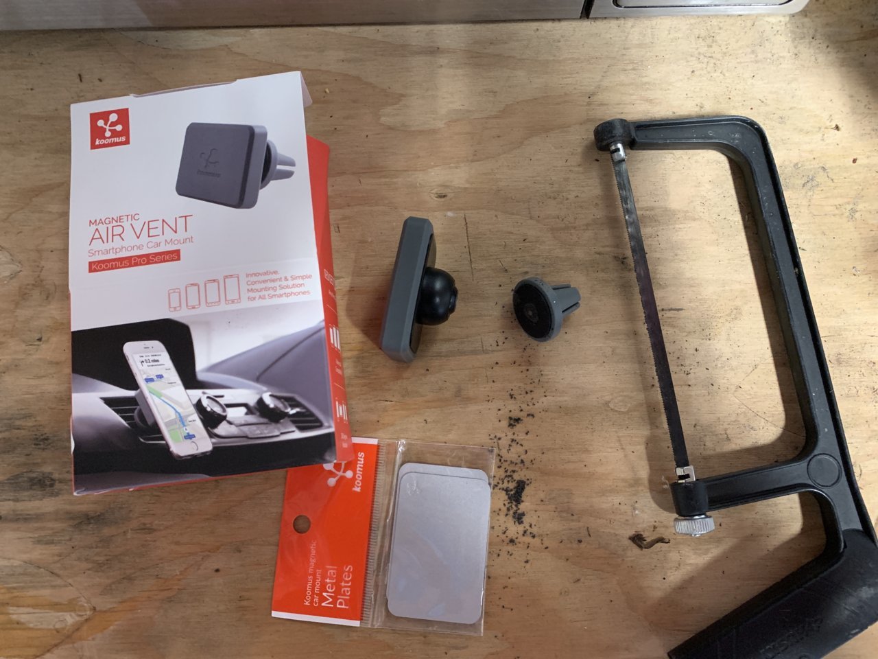

    Did you just use the adhesive strip to attach the holder to the dash?

    Nope. I modified the air vent phone mount by cutting off the clips that would normally mount to the air vent fins. I removed the blank switch plate on the dash (where the airbag keyed switch normally is). Notched out the blank plate for the charging cable. Then I screwed the phone mount to the blank switch plate and inserted it back into the dash.

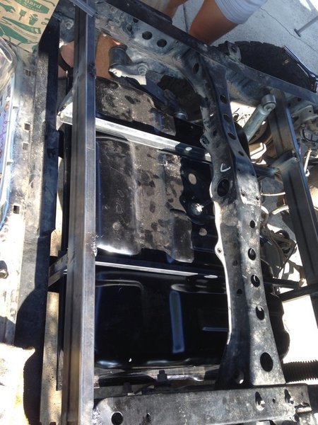

    Add a 2nd gas tank so you can carry 35 gallons of fuel.

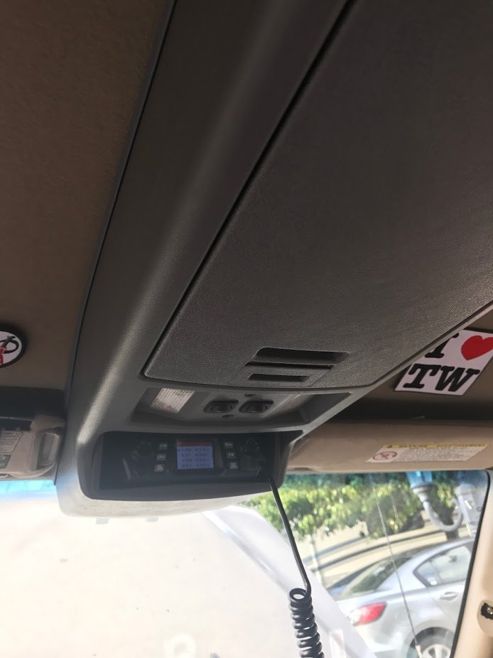

    Having an overhead console is fantastic for housing ham radio. The lights in it are fantastic and the storage is super useful. I also put in some usb ports up there for charging things.

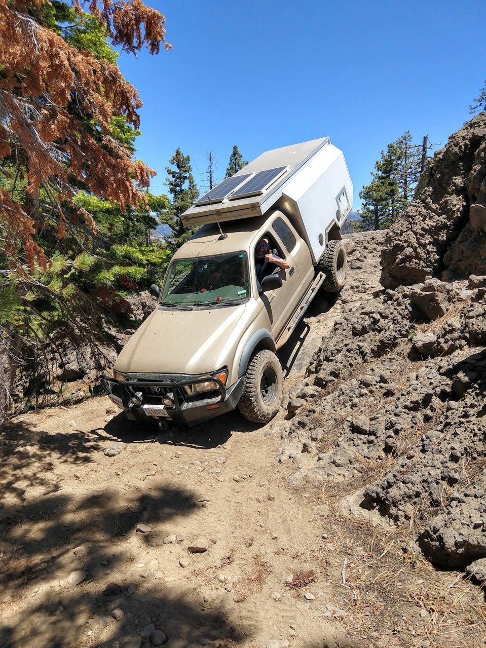

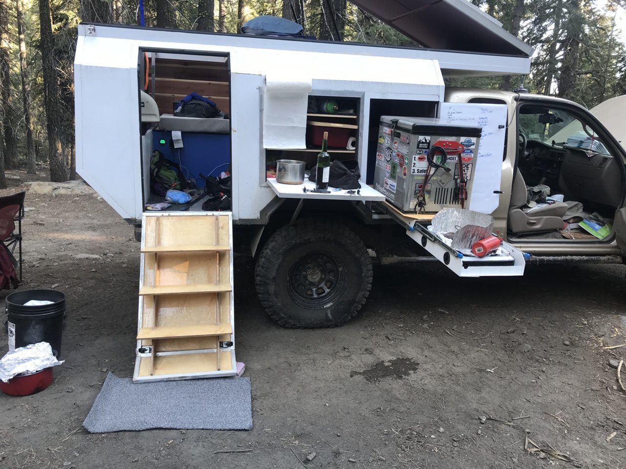

    Get rid of your bed and build a camper.
    Side access to the kitchen etc is key.

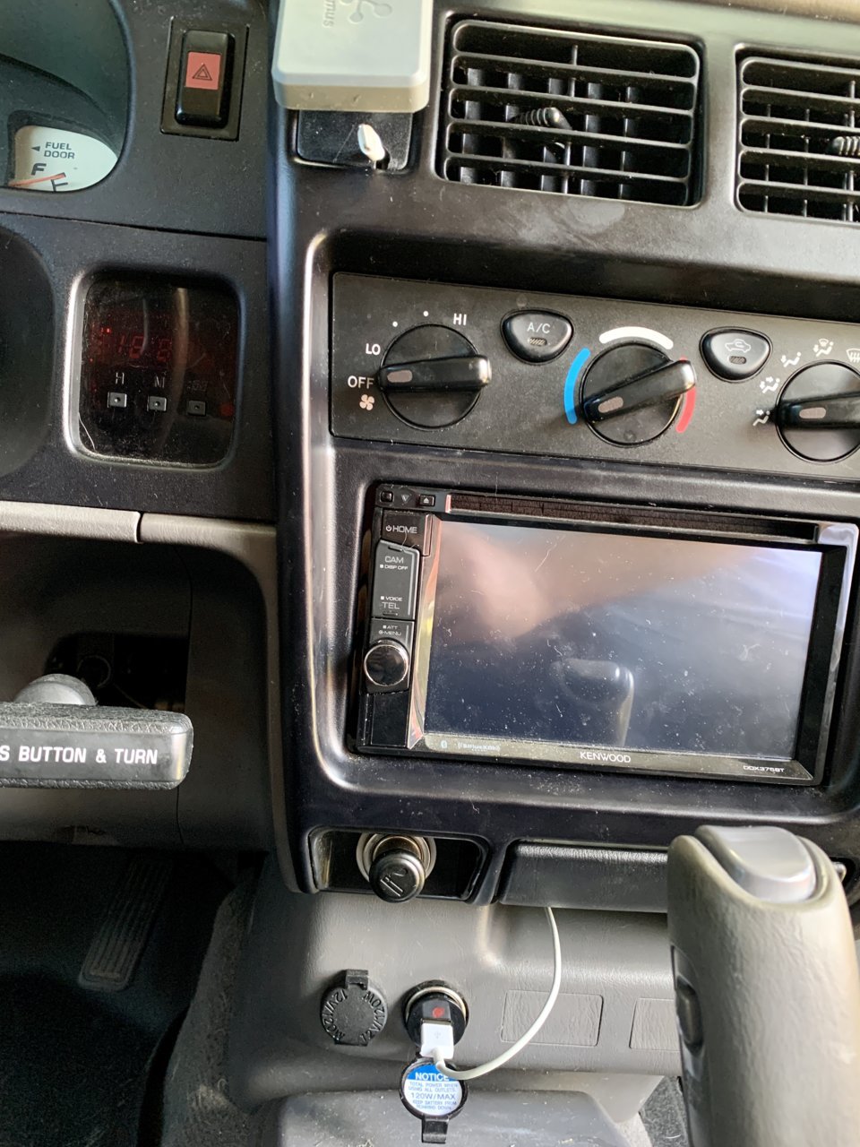

    What buttons are those that you have for the climate control?
