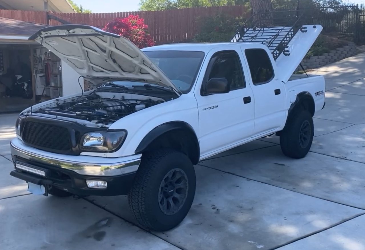

    Hey Rusty, Hope your 1st Gen mods are coming along. I've owned my 2001 since brand new 10/31/2000. Bought it Halloween Night, the First - 1st Gen TRD 4x4 DoubleCab to arrive at Longo Toyota. It was the only one built/factory modified with a Leather Interior special for Longo, the largest Toy dealer in the world. Here are my favorite DIY mods I have done in the past 22 years, 270,000 48-state miles.
    #1- Upgraded to Tundra front brake calipers/rotors. Must have 16" wheels to clear the bigger calipers. Best mod ever, truck stops! About $350 Amazon.
    2- Power Rear Sliding Window. I drive windows open and love off road fresh air. About $500 amazon plus new gasket.
    3- Alpine 9" appleplay stereo with camera. About $900 crutchfield.
    4- Webasto Power Tilt Slide moonroof sunroof. Fresh air! Roof cuts like butter but now solid. Was About $500 but Bidinflation and rules cause difficulty finding now.

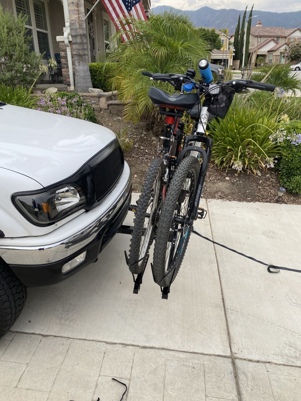

    5- Rear and Front hitches. Rear obvious. Front: plate/light holder, bike holder, trailer pusher.
    6- Half Inch Cable wrapped around cat and catback flowmaster. Tight wrap and locked for cat-theft prevention.
    7- Deck Lid and Snowboard Rack. Curt, about $400 amazon, fits 4 skis, 4 snowboards. Keeps stowed gear dry when racked gear is melting off snow. Upgraded to 60 pound lift struts.

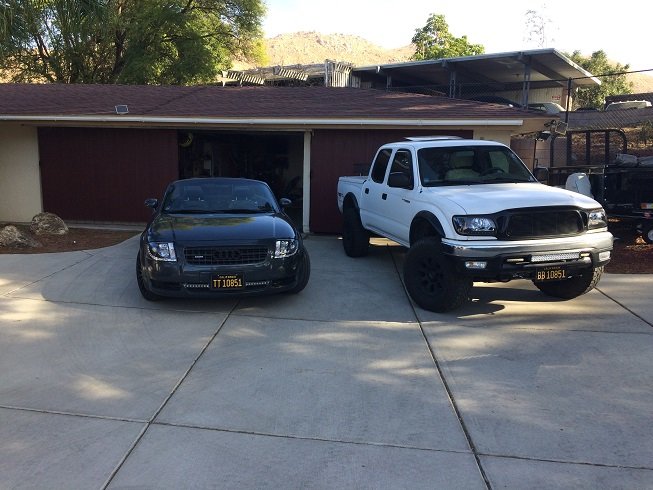

    8- Audi TT driver's seat. I own a TT and checked fit. Then bought a good one from wrecked TT at dump. About $40. Requires new Taco seat brace and some seat-to-brace mods. Kept the factory seat in case. So comfortable in a real bolstered seat.
    9- Minor front rear 1 inch lift which with geometry added about 2".
    Did everything myself in my garage. You can too!

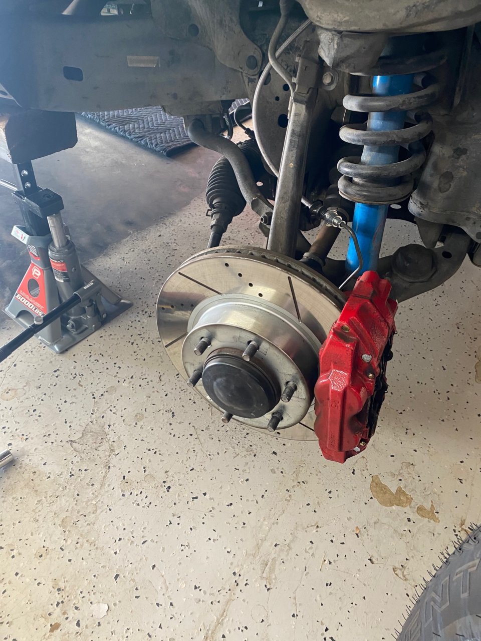

    4 Sure TUNDRA 13WL brakes, Rotors & Calipers.
