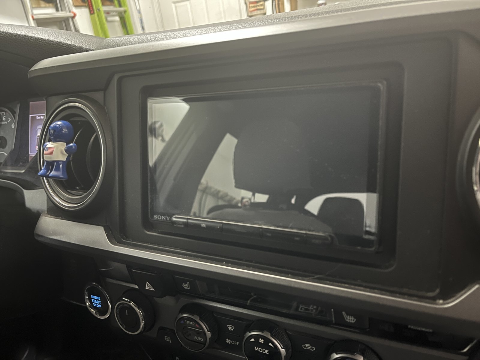

    I ordered Sony replacement from Trail Grid Pro.IMG_8024.jpg They have different sizes and models. I wanted smaller flush fit. I was after wireless CarPlay. It’s all plug and play, and all controls work except for navigation display in instrument cluster. I also ordered aftermarket screen protector.
