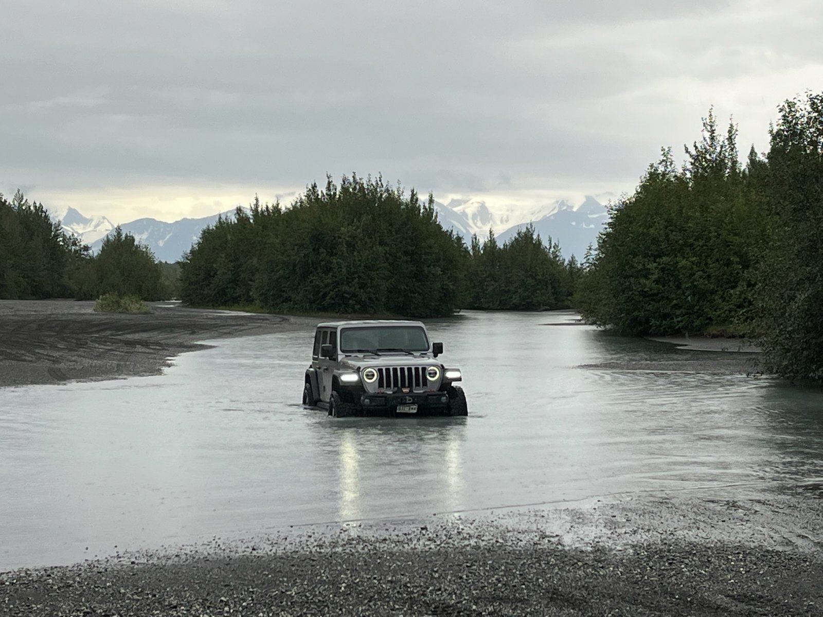

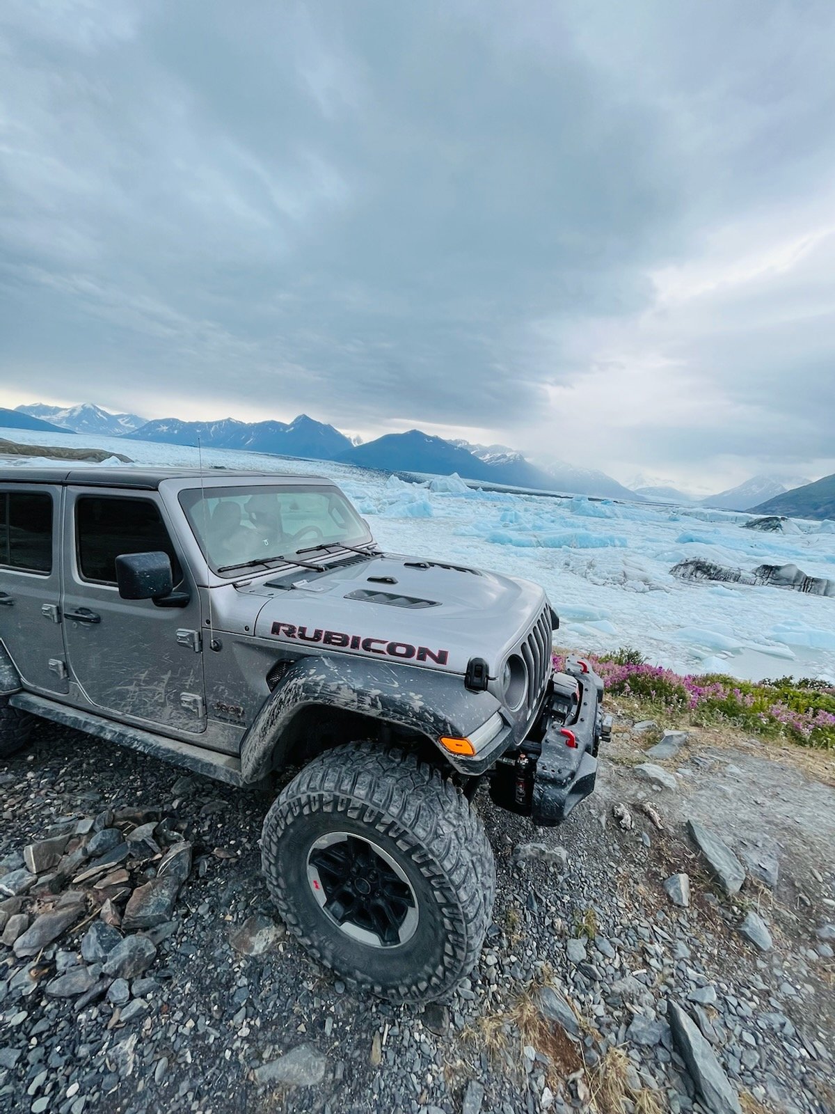

    Whacha selling the LJ for? :anonymous: I'm a sucker for the TJ years.
    I would also do some research on off-roading a 2nd or 3rd gen truck. If it was my money it would be a 4th gen:thumbsup: .
    I have seen a lot of "Jeep guys" very happy with a Tacoma purchase. Just keep in mind it's not a Jeep (good and bad). Have you looked at a JL series Jeep wrangler? This one has the 4 cylinder turbo (I would choose over the V6), 4.88 gears, 2.5" lift with Fox 2.5 shocks, 37's and it rides like it's on clouds. Seriously.
