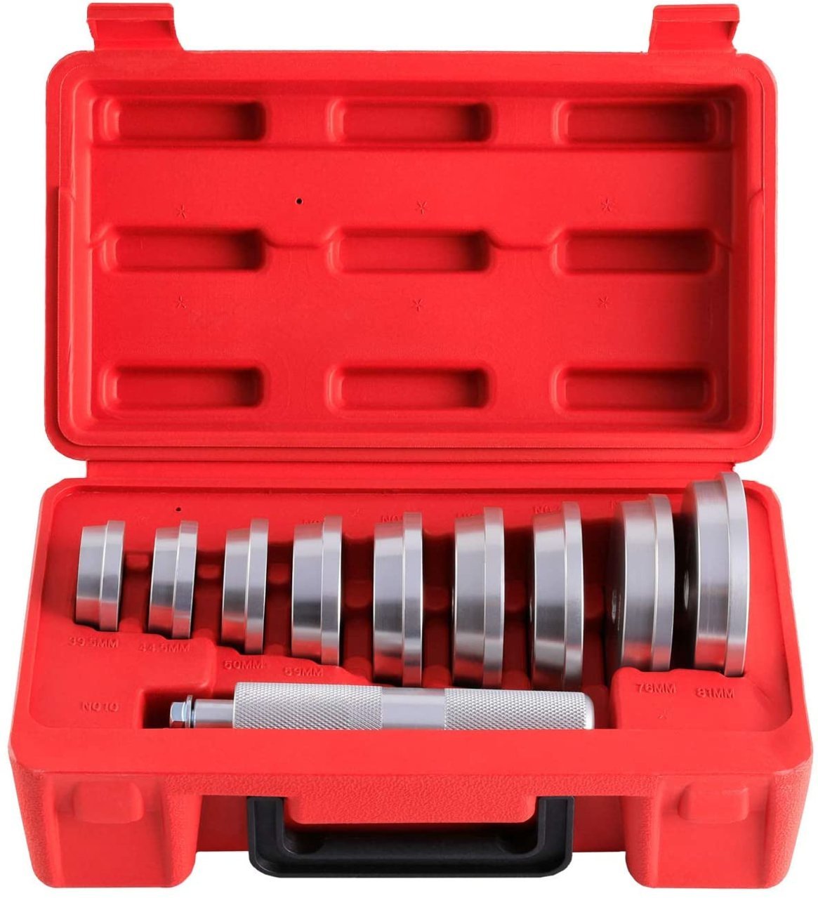

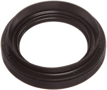

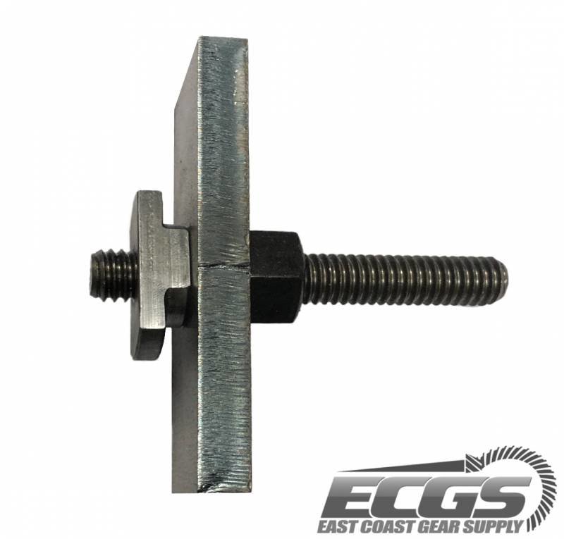

    Personally I wound replace the seal. All it takes is a small scratch and it will start Leaking. To install the seal easy, get a 2” pvc end cap from Home Depot/Lowe’s for ~$1
    don’t grind down the tool!!
    It’s tight getting it in but makes pulling the bushing out easier and it has a better grip.
    before ya put the tool in, stuff a clean plastic bag in that way the tool doesn't drop into the diff.
    set the bottom in and using a large blunt tip flat head screwdriver tap the top in till it sits behind the bushing. When you get ready to pull it out, make sure you rotate it ~90* so your pulling on a flat even spot

    As far as the seal, I meant I don't know if my seal is bad or not. I've got 125K on the truck so I figured I might as well replace it.

    You have to grind it to get it in behind the needle bearing. For just the seal, sure it'll work as is.

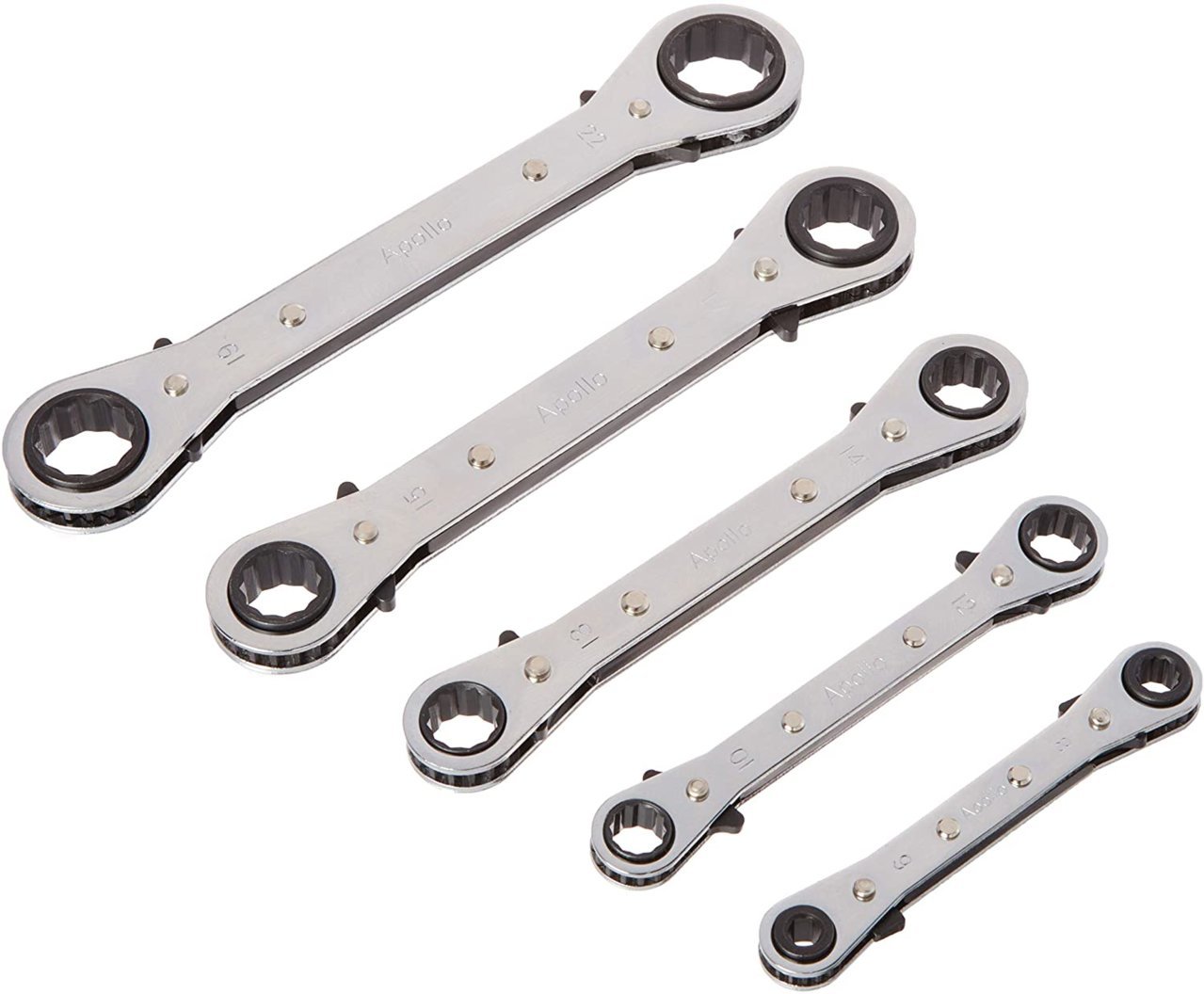

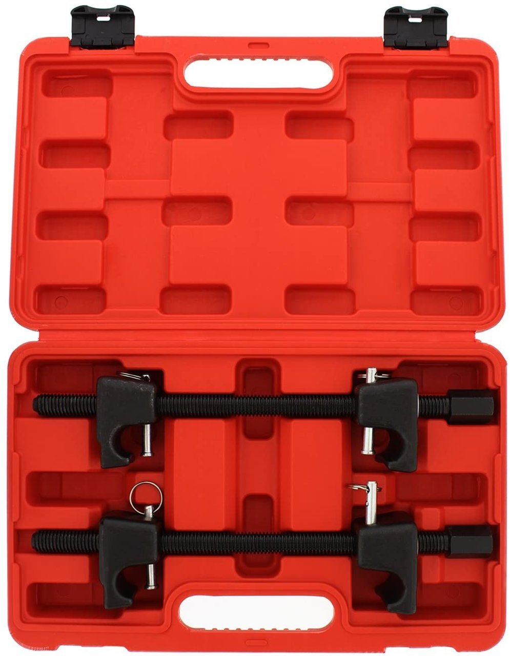

    I bought Lucas 85w-140 for the axles, a set of ratcheting wrenches for the ECGS tool, race bearing kit, and spring compressor kit.

    Return that spring compressor, there junk. (Don’t fit our springs and are death traps)
    Also you can rent that and the drivers from the part store

    Yep. Lose that compressor.
    If it would have came with 3 clamps I would allow it. The retards deleted 1 clamp years ago to make you buy another set for it to be safe to use.

    It’s easy and a lot safer to assemble them on the truck with a floor jack

    Just borrow a good set form the parts store of your choice. No sense in keeping a tool around that will get such rare use.
