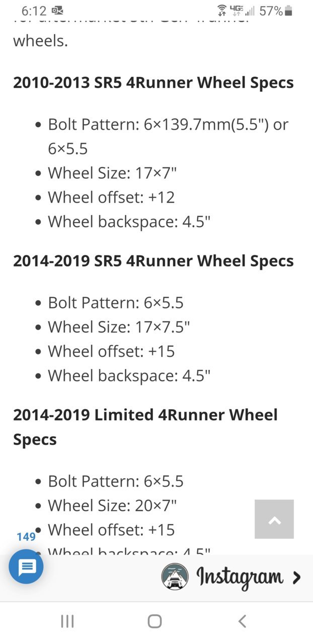

    I prefer a "pizza cutter". I'm running 255/70 right now. I also want to stay with a e-rated tire. I don't care about weight or MPG's.

    33" skinnies. Still had to run wheel spacers with stock rims. Was rubbing my SPC's at full lock.

    The JBA site said my UCA were good to a 285/75 with my wheels if I'm not mistaken.

    I'm not sure what offset yours are, but with mine they rubbed.

    Mine are the 2014-2019 SR5 wheels

    Mine are +30 so yours may be fine.
    Mine also have a whole inch of extra backspacing which means the inside lip sits more inboard than yours, and that inch was what I had to make up for with spacers.

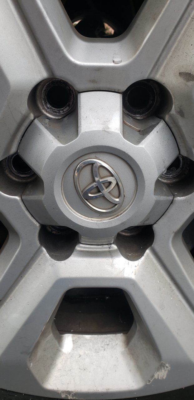

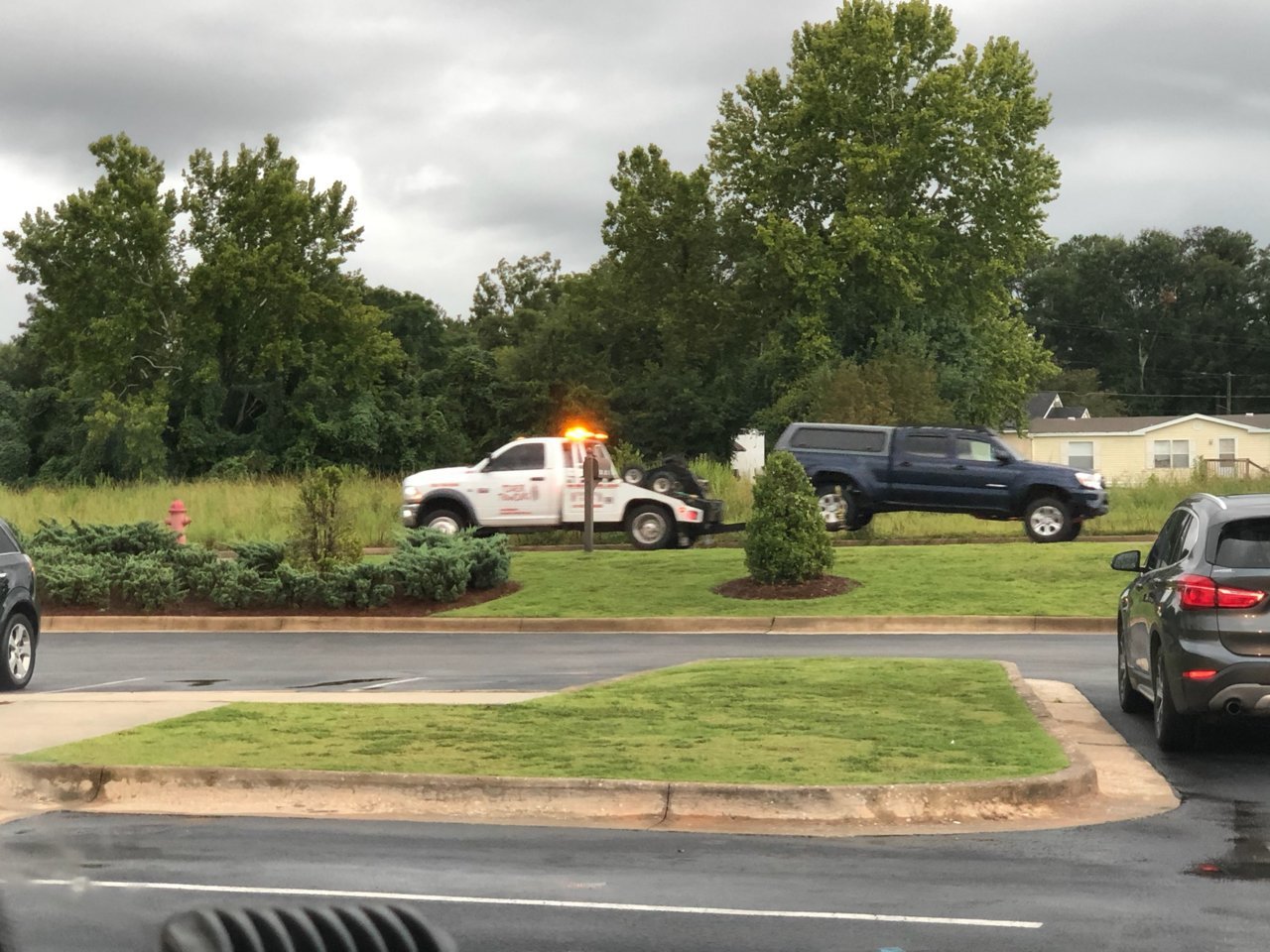

    I was having some weird sounds/vibs a week or so after the lift. I think i may have found it. Apparently I didn't torque the lugs and they sheered off in a parking lot tonight. I had the truck towed to the shop and will get it fixed in the morning :rofl:
    My buddy @baldridge was good enough to meet me at the shop and give me a ride home.......also got a "shame" pic :rofl:

    At least you weren’t driving 60mph

    Phil! Thank goodness you were in a parking lot and not doing 70 on the interstate.

    Damn Phil, I bet that was the source of your noise all along. Your wheel was rattling around on the studs!

    If that was the case, then I'm surprised you didn't feel it wobbling while you were driving.

    It got worse today and I was feeling it around 45 before. That's why I bought the cb drop.
