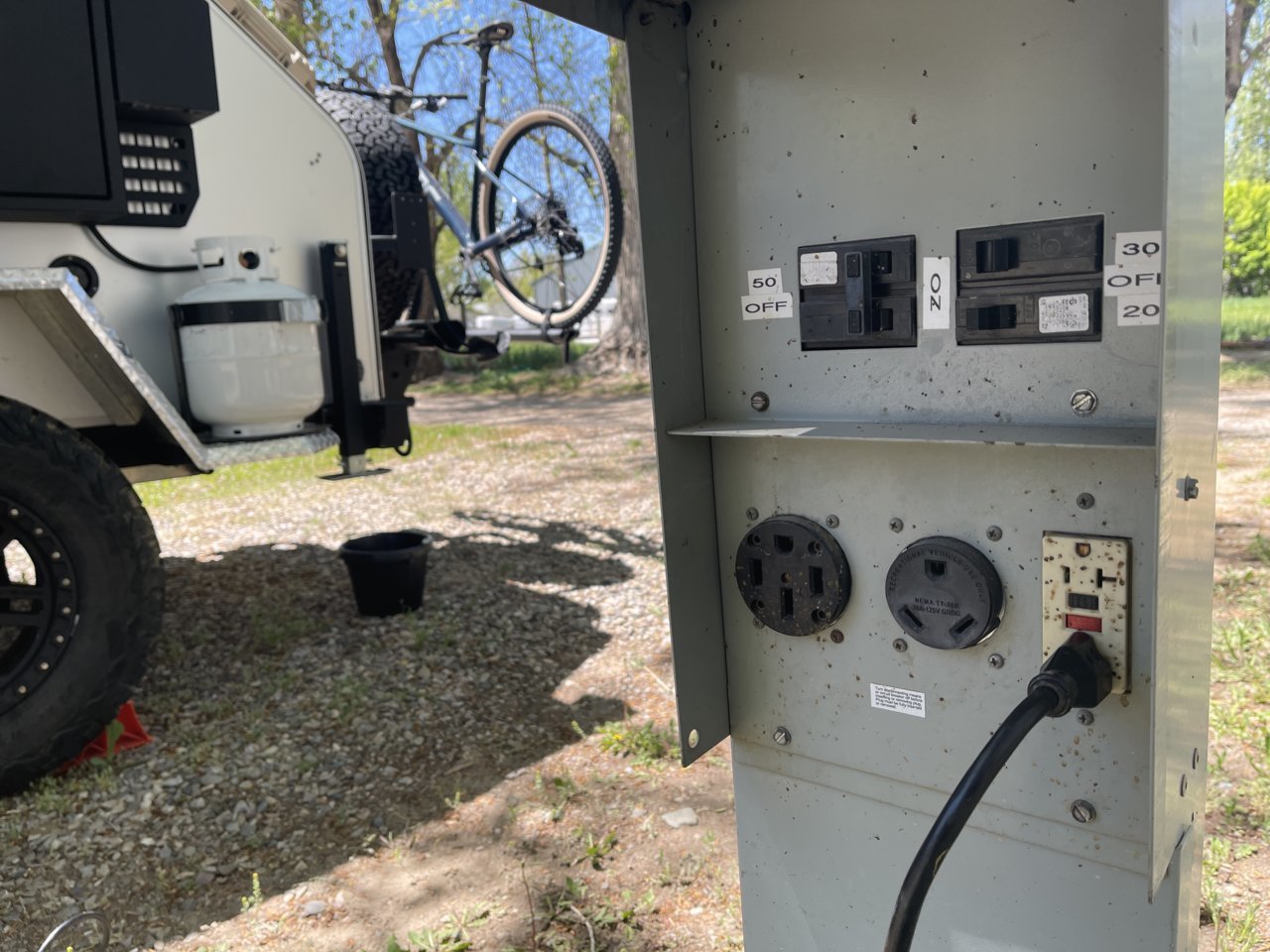

    20 AMP is the standard I have seen in Nebraska State Parks and the RV campgrounds in Wyoming I have been to. I haven't come across any 15 Amp outlets yet, all I see are 20 Amp GFCI outlets and that is what I tell the staff when they ask for my electrical needs. Depending on where you go, you may see a 50 Amp outlet, and 30 Amp outlet, and a pair of 20 amp outlets (like the ones in your home or garage) on the same panel with circuit breakers somewhere on the panel.
    If all you are looking to run is a heated blanket and some peripherals you may want to consider investing in a Jackery or Bluetti or other battery pack with a solar panel. Top off the charge during the day from your vehicle when underway or from the sun at a campground then be toasty at night.
    Edit: Here is the panel I am currently plugged into...
