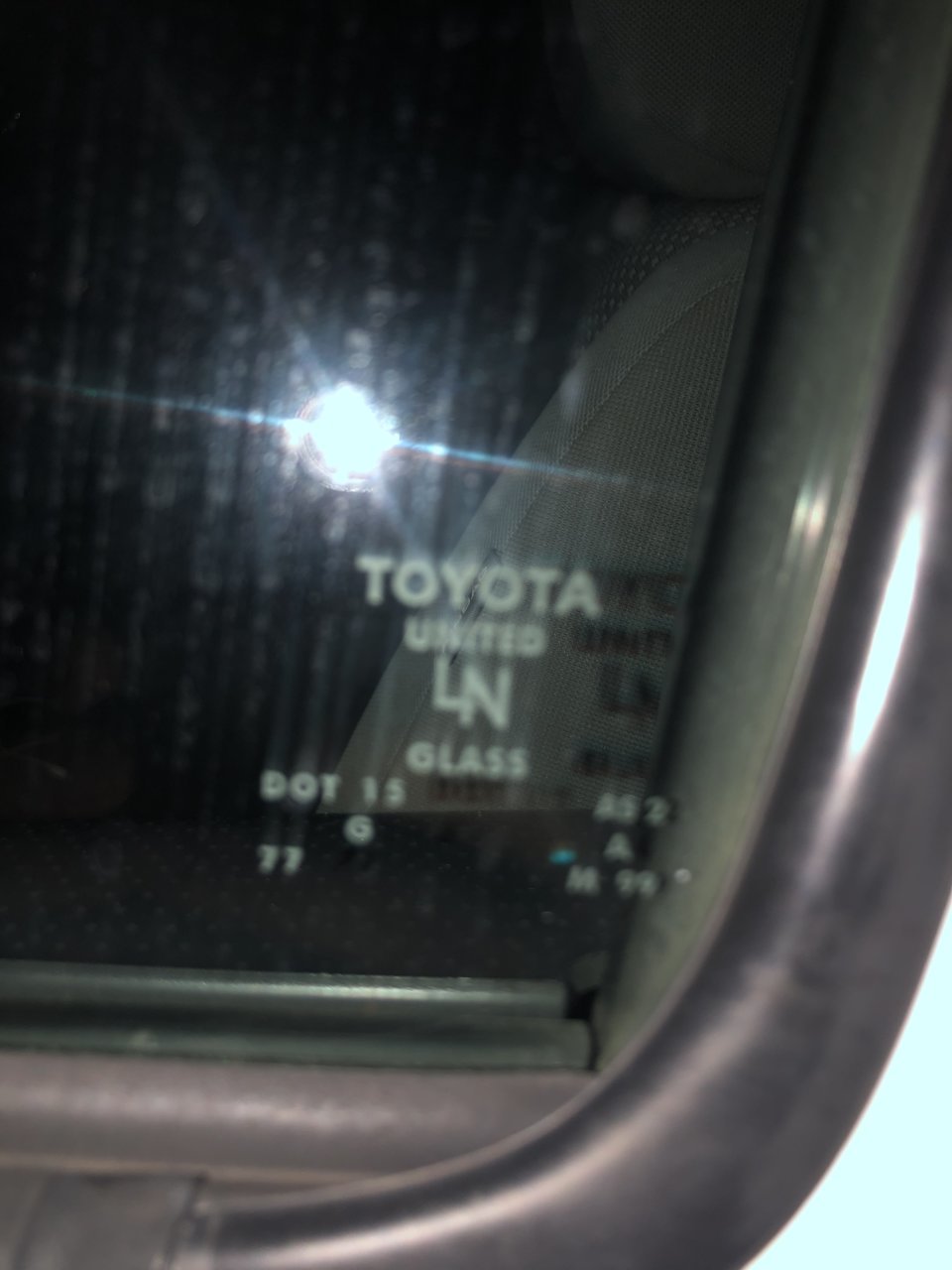

    What that. Is it a film sticker or manufacture emblem.( FYI almost all manufacturers info is etched to the glass) F232AE9D-D034-4644-BDBF-613D7115020B.jpg

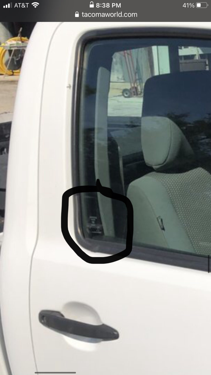

    no clue what it is lol

    Well that tells it’s the oe glass in the truck at least.
