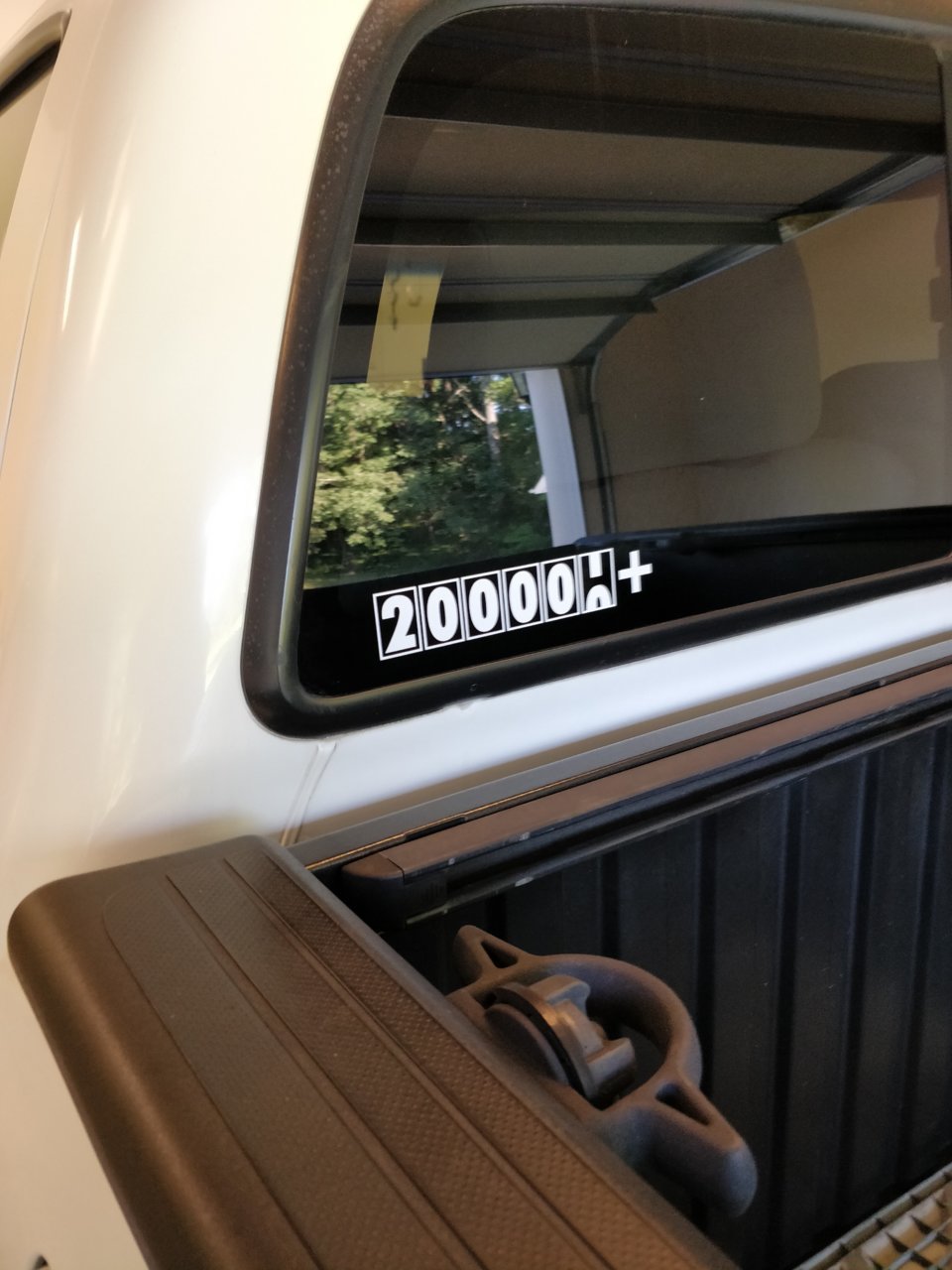

    The "rubber" seals that follow the border of each window on my 2011 look... Sun damaged or burned? They are "bleached" and spotted.
    One of my buddies commented on them and said "you better make sure they don't start leaking".
    I'm not sure if this is normal or not. Has anyone replaced these? I don't want water going places it doesn't need to.. haha.
    If anything it would look better if they were all black and not... spotted looking.
    Edit, this is the only photo I have tight now, I'll take another soon but this shows the strip I am talking about.

    I remember reading about this on here once before. Almost looks as if mold is growing on the rubber stripping.. I think its normal.. :oops:

    If the seals aren’t cracked or broken I wouldn’t worry to much about it. You could paint them or replace them. Edit: how the f!!k do you get that green f!!kin’ mold off without killing the rubber? I’m having little to no luck with this

    I'll have to look closer and see if I see cracks. They definitely look "dry rotted", not sure how else to discribe it.

    Here is what worked for me. I did this on both the back window seal and the side window seals.
    • Apply tape to paint and glass to protect from scratching.
    • Lightly wet sand with 1000 grit sandpaper, then with 2000 grit.
    • Wipe on 1 or 2 coats of Penetrol.
    It is not a permanent fix, but should last a year or two before having to repeat. I did my seals about 28 months ago and it is time to touch them up again. Regularly using something like 303 Aerospace Protectant might extend the time between repairs.

    can't replace just the rubber. it's encapsulation that's made onto the window unit. The whole back glass assembly would need to get replaced. Aftermarket brands don't fit worth a crap, btw and you'll drop at least 500 on a OEM slider.

    Use some aerospace 303 on them.

    I assume the issue is from UV damage, so yes a uv blocker would help
