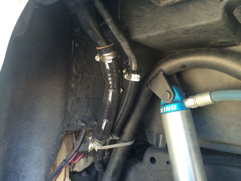

    I have been having trouble getting my fuel filler neck to line up to plastic insert installed on the double cab short bed Glassworks bedside. It seems to not be long enought. Appears the design intent pushed the filler plastic insert inward to accomodate for wider fender.
    Any advice, ideas, info?
    Im tired of reaching under my fender to fill gas..

    I cut all 3 lines and used some heavy duty tubing to extend it, worked perfect

    Anyone else have pictures or something they came up with? Also can you remove the evap stuff delete the line going to the charcoal canister ?
