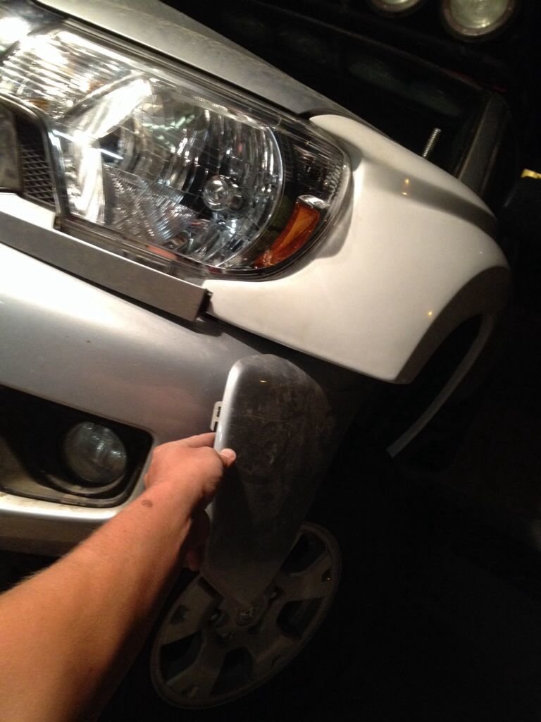

    So. You went mid/ long travel and/ or thought your buddy totally knew what he was saying when he swore 285/75's wouldn't rub.
    Then you realized he crawls malls and you stuff your wheels once and look like this:

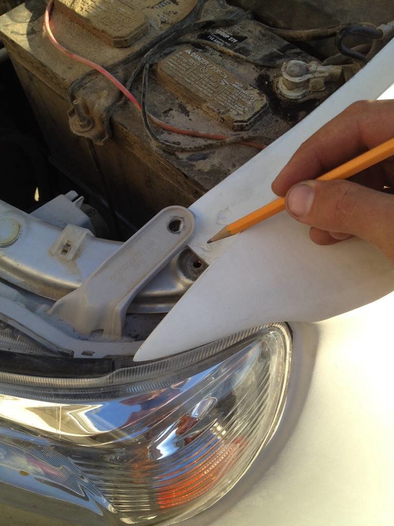

    In the meantime, can anyone help address this issue?
    Every other tab fits
    Except these. I understand they're not supposed to line up but what'd I do wrong ? Now neither of those holes line up ysubehus_827888ad90e342080951eadcaf0cc31162b87089.jpg

    If i remember correctly, the stock fenders had a piece that stuck out far enough for that headlight. So the hole you're pointing to is for the bolt that holds the fender down. Then there was another hole next to that one on your stock fender to hold the headlight in place

    x2. your headlight bolts into the fender... not sure whats going on here

    I'd say don't even bother with that one. Cause it's only one

    or fit it how you need to and drill and tap a thread hole into your truck if there is room where you are pointing to under that part??

    What is stopping you from adding some glass to extend the fender mounting surface to accommodate the mounting tab? That would be my solution after I had exhausted all possible ways to make it line up of course...

    Time, mostly. Hell I have free glass & resin from work but it's such a pain... I'm thinking I'll pop rivet some metal tabs on & mount to that

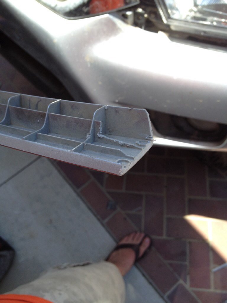

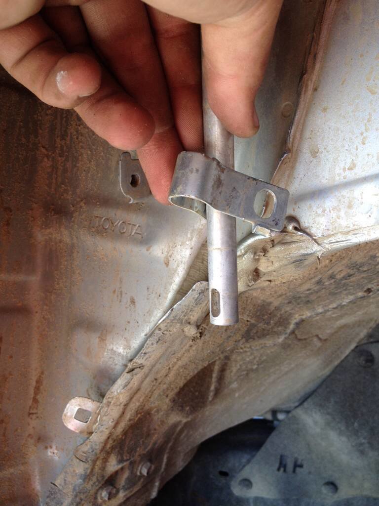

    Well this install is kinda crap and now I get why there aren't any good how-to's around.
    The hardest part is making them fit. e7uvabug_09ba7c8d0396d7fabeebe7565fc4f782d70c696d.jpg
    You'll run into crap like this constantly.
    Your stock bolts are 1/2" long or so & the damn glass is crooked and sits 1.5" higher than the bolt hole... Now what?
    You just force it and trim and shove it back into place & grind spots here & there...
    I had planned on making a bolt-by-bolt detailed how to for the fitment part but... You'll get it to work just fine without seeing that and every piece of glass will be different. Just use a small pilot bit to drill into the bolt holes to ensure you're on center, then use a 1/4" bit to drill the hole out.
    These two will give you problems.
    Apparently there is no bumper cap to fit 2013 trucks....
    So the only thing i have left to work with are the little flat plastic bits.
    You can either trim back the glass 2"
    Or trim the plastic back a bit.
    I went for the plastic trim route
    Cut an inch or so of the tabs on the back and file it flat. Then cut a 1/2" short & it fits pretty well now.
    I used 3M body panel double sided tape to stick it to the fender, as you're cutting off the side that was once held in place by the old fenders

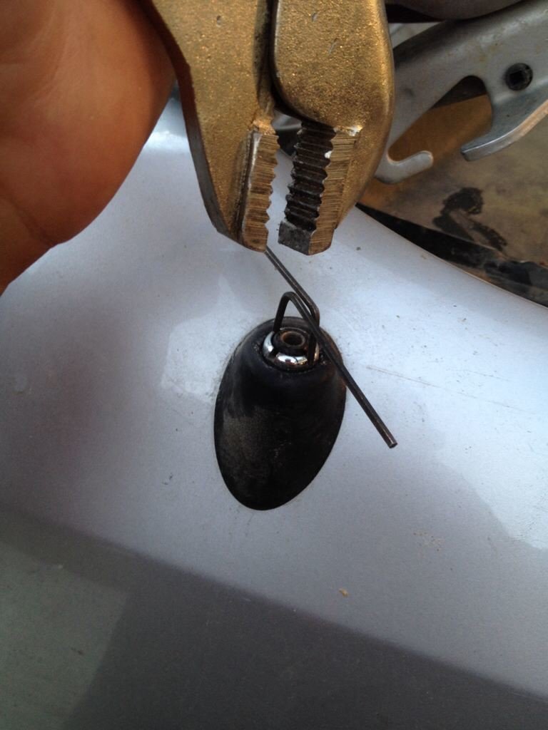

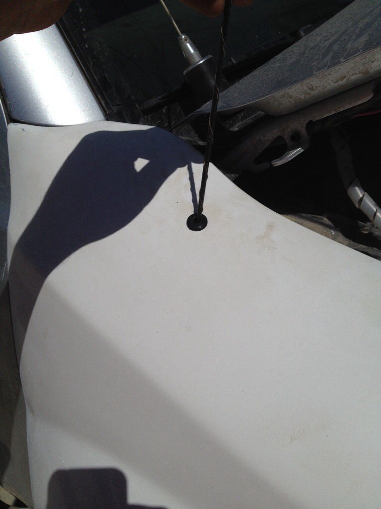

    What to do with your radio antenna!
    Not sure why I can't find this addressed anywhere but I've heard everything from
    Just cut it off
    To expensive "antenna-less" systems etc
    Here's what I did
    Carefully take this nut off.
    Take this off and note how you can adjust it up & down.
    The old "cap" thing on top will not match the curve of the glass anymore so i decided not to mount it on top
    Grind out a notch to adjust it down an inch or two then drill a hole in the fender & use a grommet vejy4y3a_caa0e7920c5c0e9de2a92476977b0b9f7cbcc72b.jpg
    Simple, looks stock & radio works perfectly still!
