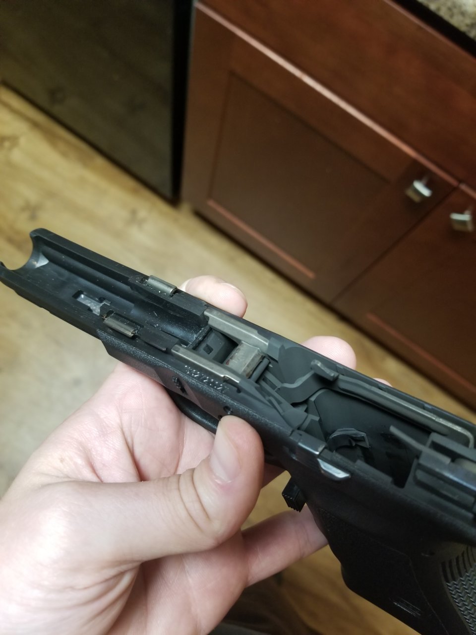

    All factory in my Poly80 and Shield. Im looking into the sights for my Shield and then a trigger. My Poly80 has a dead trigger right now. I am not sure why. I have checked EVERYTHING! trigger spring is right, filed off the burr on the rear block, filed down the rear rims to let the slide sit just a tad lower, pulled barrel, recoil spring and mag and looked through the mag well as the safety plunger cam in contact with the trigger bar, the trigger bar gets pushed to the side and the plunger slides right past instead of pushing the bar back to reset the trigger....
    I am at a loss....
